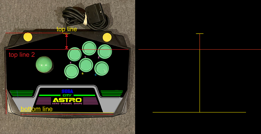

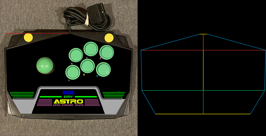

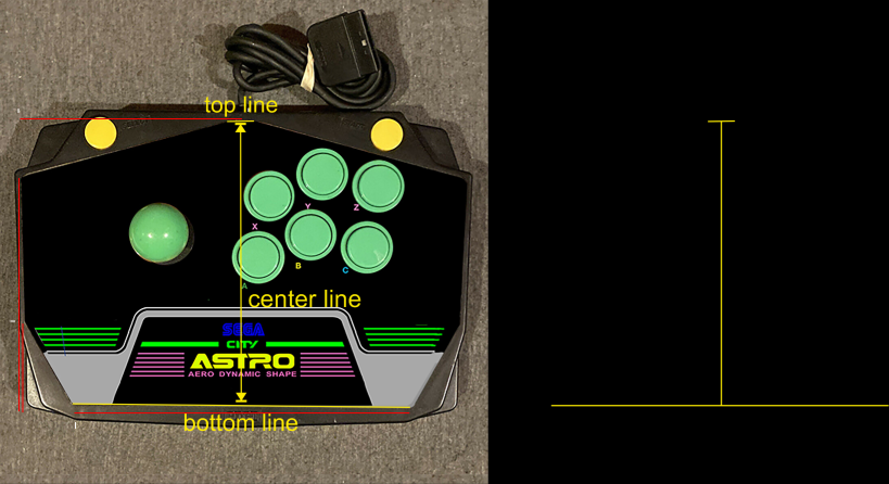

If you want to go the measuring route, you might try this.
Step 1
Controller: Measure the length of the <top line> and of the <bottom line>. Measure the distance between the two, this will become the <center line>.
Image: Make a horizontal line the length of <bottom line>. Make a vertical line the length of <center line>. Move <center line> so that it's bottom end point meets the center point of <bottom> line.
Make a horizontal line the length of <top line>. Move <top line> so that the center point of <top line> meets the top end point of <center line>.
Step 2
Controller: Measure the length of <top line 2>. Measure the distance between <top line> and <top line 2>, this will become <center line top>.
Image: Make a vertical line the length of <center line top>. Move <center line top> so it's top end point meets the center point of <top line>.
Make a horizontal line the length of <top line 2>. Move <top line 2> so that the center of <top line 2> meets the bottom end point of <center line top>.
Step 3
Controller: Measure the length of <bottom line 2>. Measure the distance between <bottom line> and <bottom line 2>, this will become <center line bottom>.
Image: Make a vertical line the length of <center line bottom>. Move <center line bottom> so it's bottom end point meets the center point of <bottom line>.
Make a horizontal line the length of <bottom line 2>. Move <bottom line 2> so that the center of <bottom line 2> meets the top end point of <center line bottom>.
Step 4
Image: Connect the end points of the lines to get your shape.
Step 5
Image: Remove the inner lines.
