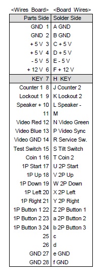

« Reply #11 on: June 15, 2021, 06:21:36 pm »
Great to hear! I might have more issues with the board than the sound. The jump and kick buttons inconsistently work and I need to disconnect/reconnect the harness connector until they start working. I initially thought it was the push buttons and quick disconnects so I’ve replaced them already with no luck. The harness wires appear to be seated tightly with no corrosion or visible defects.
I believe this is my pinout diagram:
« Last Edit: June 15, 2021, 06:27:29 pm by finalfan7asy »

« Reply #12 on: June 15, 2021, 08:01:34 pm »
Given the problems you're reporting, continuity/resistance check from the PCB to the farthest connection.
- A good connection should have <2 Ohms resistance.
- As always, make sure the power is disconnected . . . unless you want to fry your multimeter.   >:D
For example:
  Meter lead 1                                                                                                           Meter lead 2
  PCB ---- Edge Connector ---- JAMMA Connector ---- Wire ---- Quick Disconnect ---- Button QD Tab
Also check the PCB connector contacts and JAMMA connector contacts for dirt, corrosion, wear, and damage.
EDIT: At first glance, the euro-style terminals looked like a harness hack, but pg 4 of the Operating Manual shows that they were in the original cabinet.
https://arcarc.xmission.com/PDF_Arcade_Manuals_and_Schematics/Double%20Dragon.pdf
