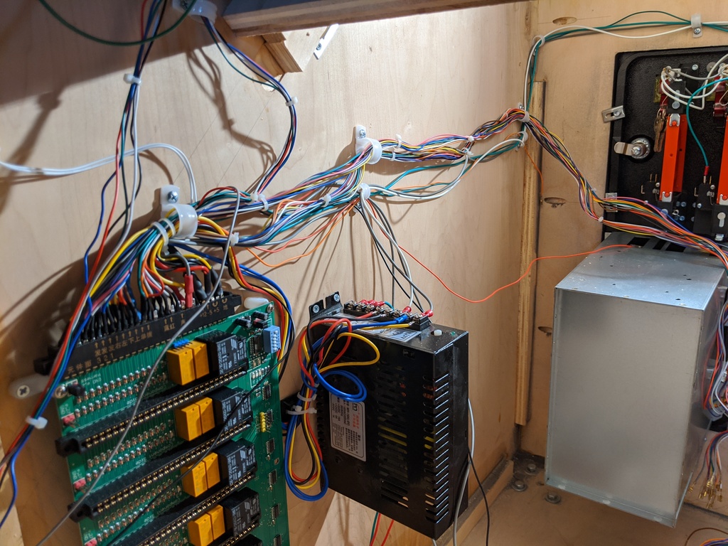

« Reply #250 on: October 21, 2019, 08:21:39 am »
Wiring is in progress.
Everything is good so far. The multiJAMMA board powers up. Super High Impact powered up and the monitor works just fine.
Anycoin mechs are installed.
I have a bunch more wiring to do. The JAMMA harness I bought was not as advertised. The description said it was wired for -5v and coin switches. There was no -5v lead and only coin 1 had a lead. It wasn't a big deal, but I specifically bought that one so I would have less modding to do. I sent them an email about it and I have yet to get a response back. I am going to call them in the next few days.
Next up is to tidy up the wiring. I am not going to clip the harness short. I am going to bundle and zip tie wires that are too long. There are too many times in the past where I have changed my mind on something and then had to do a bunch of rewiring.
I need to install the PCB rack that will hold 5 or six games depending on how much room I have in the cab.
My buttons and joystick shafts are on the way.

« Reply #251 on: October 21, 2019, 08:40:02 am »
Looks really nice.
I love wiring stuff..
Had no idea what an anycoin was...  but that is brilliant..  a dumb piece of plastic..   :applaud:
I'll admit I don't know much of anything about the circuit boards - there is a new one (I'm guessing the multiJamma since it has repeating sections.)
then an obviously old board that is a game..
I'm guessing the Jamma board allows you to plug in a bunch of different 'original' boards so you can have a multi-arcade with original boards?
That's some dedication..
Let me know if I have that right.

You are correct. I can plug in 6 JAMMA boards. This is a newer model. It isn't on the riddledtv.com website yet.
It has inputs and outputs for stereo sound. You plug the stereo wires from your JAMMA boards into headers on the multiJAMMA board.
There is a jumper you enable for each board. Stereo or mono.
The boards that are mono will play through the left speaker. The stereo boards will use both speakers.
This had to be done because stereo sound is not a JAMMA feature.
I will do a little write up on the multiJAMMA board for anyone that is interested.

« Reply #254 on: October 21, 2019, 01:38:26 pm »
What's that little black box with the red circle on it, in the first picture?!
You've piqued my interest in the JAMMA boards. I know next to nothing about them, and am probably better off running a PC, but I'm curious. Especially the multi-game option. That curiosity would probably turn to a lump in my throat once I knew how much the board and original PCBs run. Either way, eager to see what comes next!

« Reply #255 on: October 21, 2019, 01:46:57 pm »
That is my multi meter.
Original PCBs are not cheap. Especially the 4 player Konami boards.
There are some FPGA boards out there that kind of bridge the gap between MAME and original hardware.

Yesterday was a beautiful day...
...to work on arcade ---steaming pile of meadow muffin---.
Sorting out the wiring situation.
It lives!
As it stands right now, if I had my controls mounted I could play games right now.
-I still need to figure out a way to not go through all of the work Opt did to make a monitor shroud.(which looks great BTW)
-I need to fabricate a bunch of cables for the games that support stereo sound and the P3 and P4 controls.
Both of those tasks would be relatively simple except that I am not just using Konami games.
-Once my artwork is done I can apply it and mount the controls.
-I need to make brackets to hold all of the PCBs that will be in the machine.
I mounted each PCB to a piece of 1/4 inch hardboard that has the same dimensions. I have the same setup in my Time Pilot cab and my candy cab. I can slide PCBs out of any of those cabs and interchange them.

« Reply #269 on: January 27, 2020, 08:31:14 am »
Nice work  :applaud:
I do appreciate a fine wiring job.  Keep them coming!

My wiring jobs fall somewhat in the middle of the spectrum.
I don't sleeve my wires or measure and mark where my clamps are going to go. I am not that meticulous.
I also don't just chuck the wires in a pile and forget about them. I am not a total slob.
I will sometimes splice wires rather than rerun them.
I use loose clamps so I can pull more wires through in the future.
I will bundle wires rather than cut them shorter and repin them. I never know if I will need that extra wire someday.
I use lots of zip ties to tidy things up.

Screen image looks very clean.  Nothing quite like the curves on a CRT.
I can see the pain on your face on that wiring job.  That’s a ---steaming pile of meadow muffin--- load of work.
Looks like you will be using a wiring harness from the PCB switcher to the game boards.  You rolling those by hand or buying them somewhere?

There is no way I am going to hand wire JAMMA extenders. :o
I am just going to buy them. A dude on KLOV makes some really sweet ones, but he wants a bazillion dollars for them. I am just going to buy simple extenders from Arcadeshop or Mike's Arcade.

I am going to have to fab my own cables for the P3 and P4 harness from each game to the P3/P4 condenser board.

I like making cables and connectors - wiring the CP may have been the funnest part of my build.  But I get why people don't.  I was helping a friend via txt yesterday trying to explain how to use a standard male/female spade connector.  He had never seen one.
