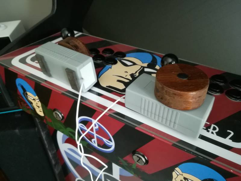

And while contemplating what to do with the control panel I sat some old USB fight sticks up top and let the guys in the warehouse give it a test:
So nothing too terribly exotic as far as conversions go, however we fabricated a control panel out of solid steel, which I will follow up with posting shortly.

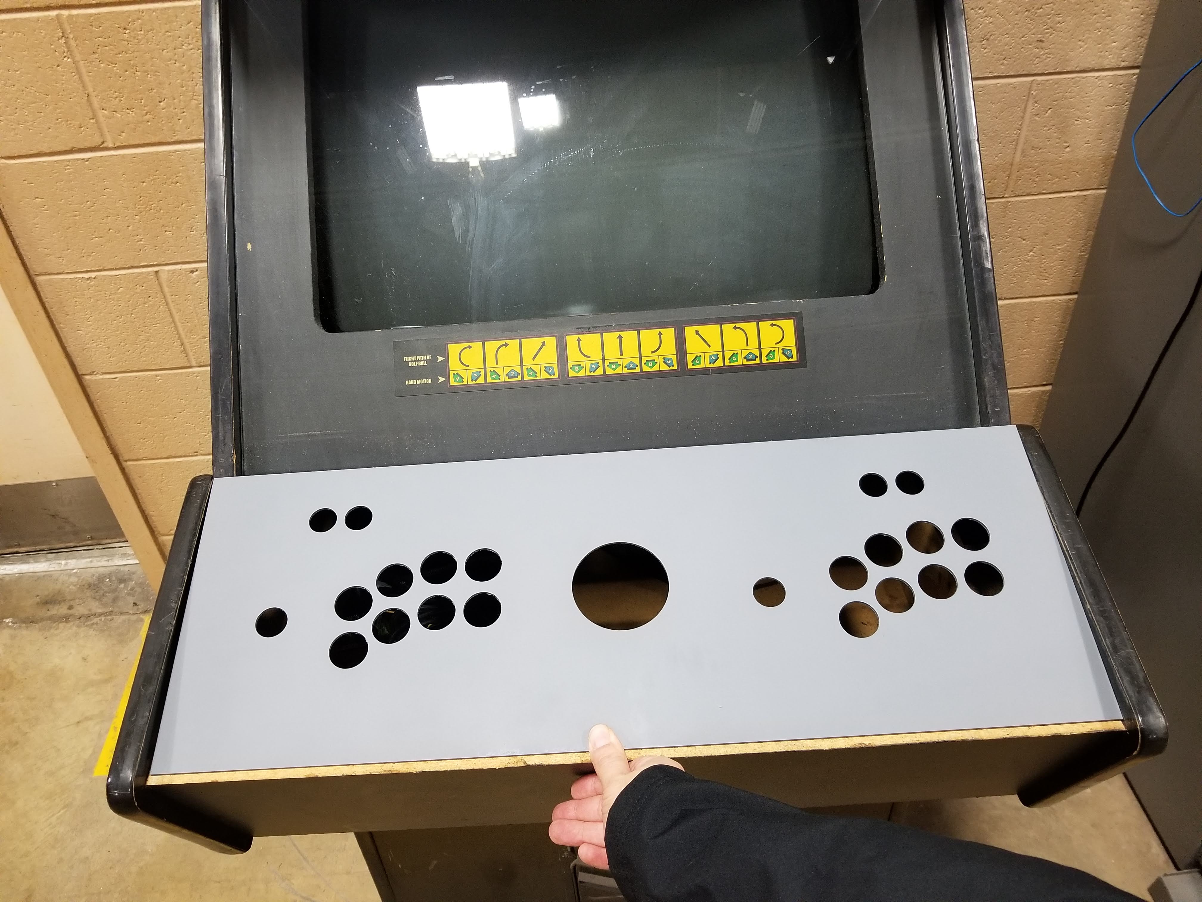

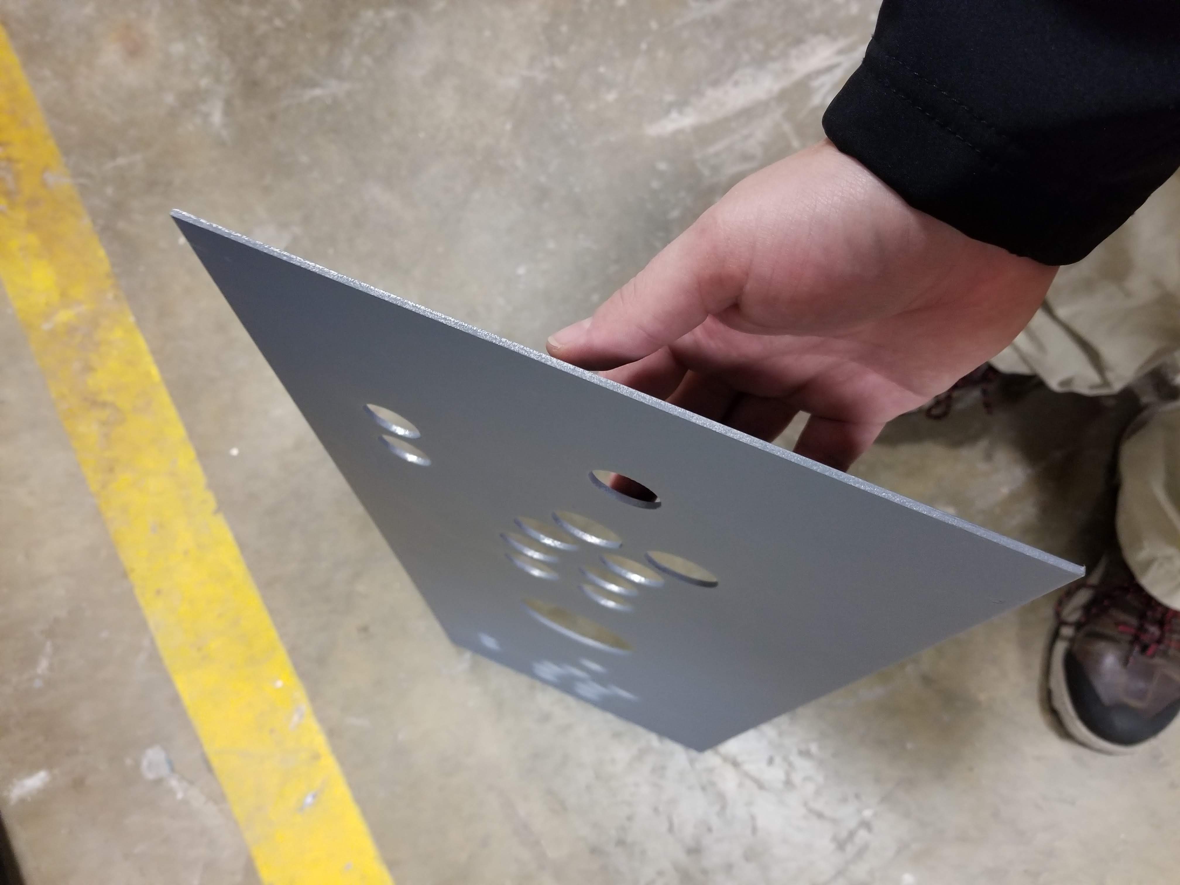

So I had some connections with a local metal door manufacturer and asked if I sent over a CAD file if they could cut out something for me on a plasma cutter or whatever they use.
"What kind of material were you thinking?" they ask. Having not worked with various gauges of metal any, and assuming that Thicker == Stronger and Stronger == Better, I request "Whatever the thickest panel you have is."
Well I ended up with a pretty substantial chunk of metal as a result.
Thankfully since I everything was cut to exactly the dimensions I gave them, it fit perfectly in the existing CP hole:
Unfortunately because it was cut to the exact dimensions I gave them, that also meant that when I measured the outer diameter of the buttons I ordered, that meant that they were just a bit too snug to fit. I think if I had added like 0.5mm to the size it would have made the difference.

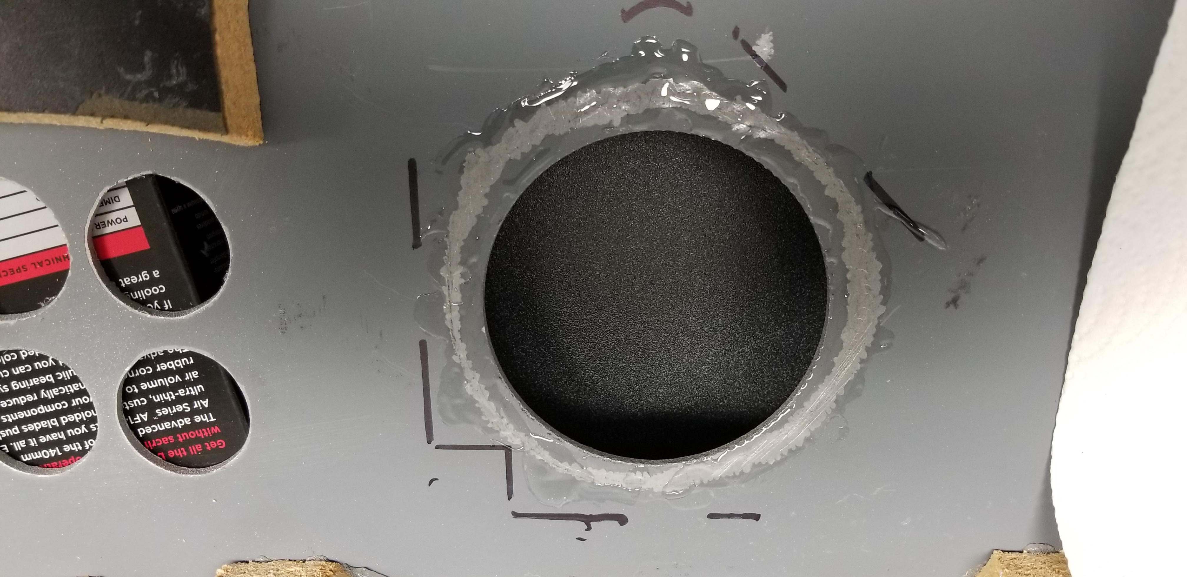

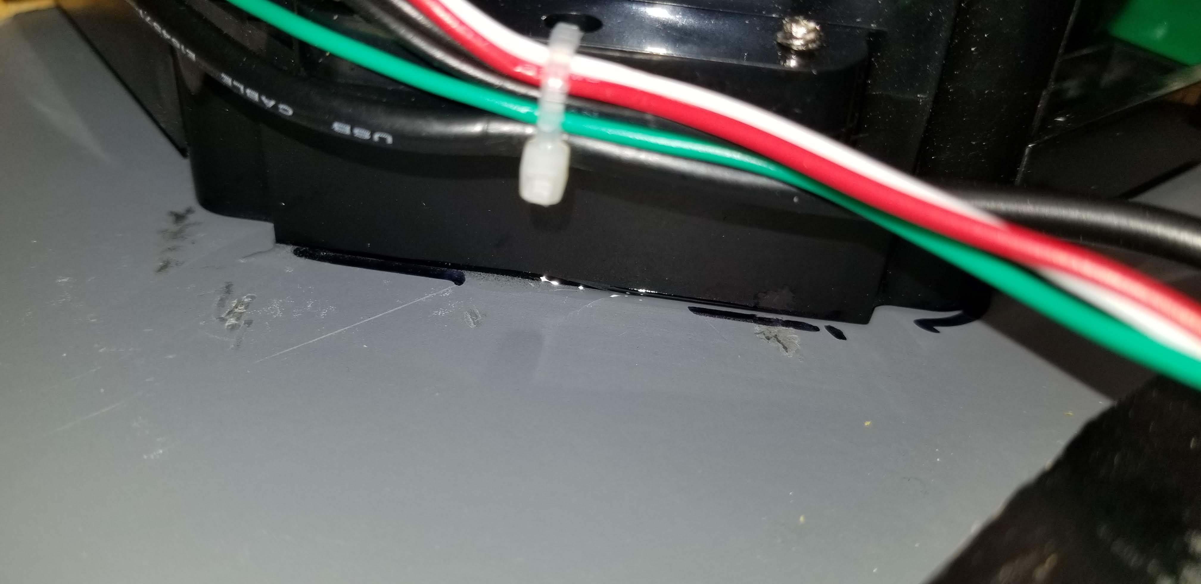

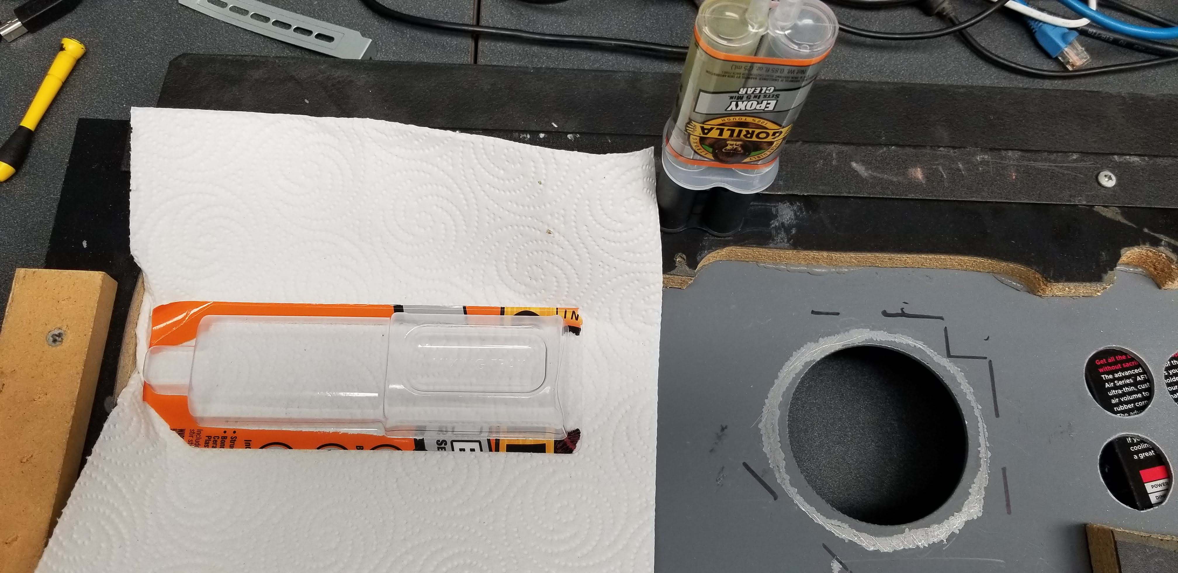

We cut the center out of the original CP and used an epoxy sealant to affix the metal, so the original mounting grooves for the CP could be used, as well as the monitor transition bracket lining up. The T-Molding from the front edge had been missing for years (probably fell off in the warehouse at some point and was discarded), so we're still trying to decide how to pretty up that front part. I'm thinking maybe some diamond plate metal that covers the entire front of the cabinet.
Anyway with as difficult as the metal was to cut through I decided to do something a little ill-advised....

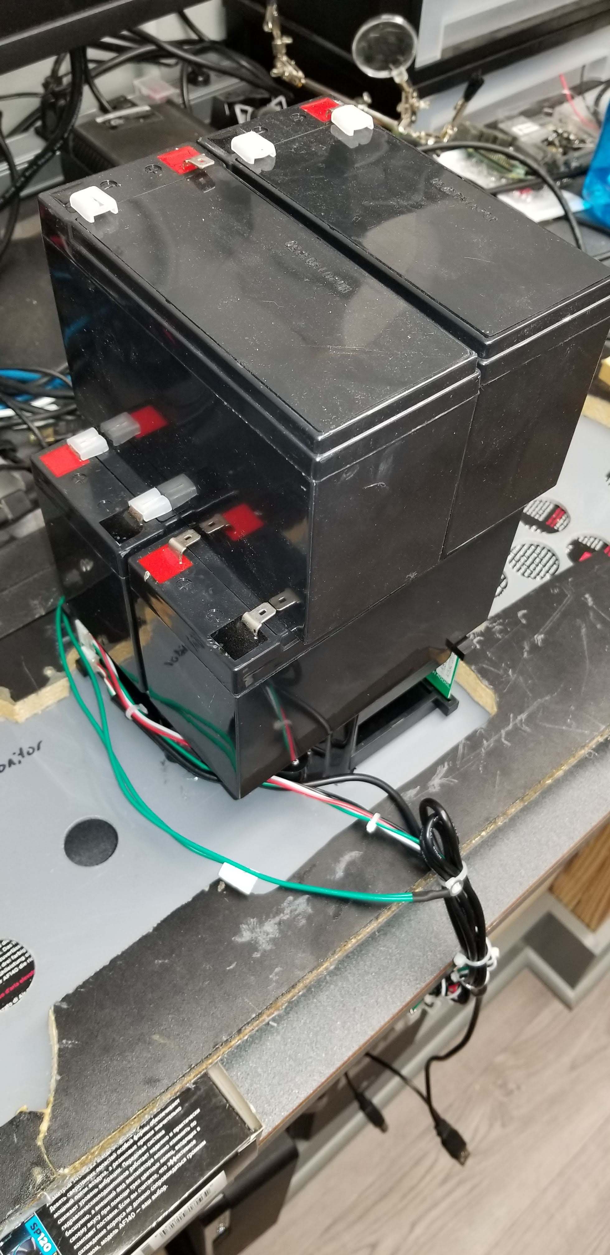

With the top panel looking so nice, I really didn't want bolt heads showing through. So I roughed up the area around the trackball, laid down some epoxy and hoped for the best!
I didn't have any C-Clamps in the office, so I used what I had to put some pressure on it over night:
Seems like I used enough because the edge around the bottom of the trackball had a bead of epoxy that squeezed out:
I decided that when something goes wrong, that's a problem for Future Me.

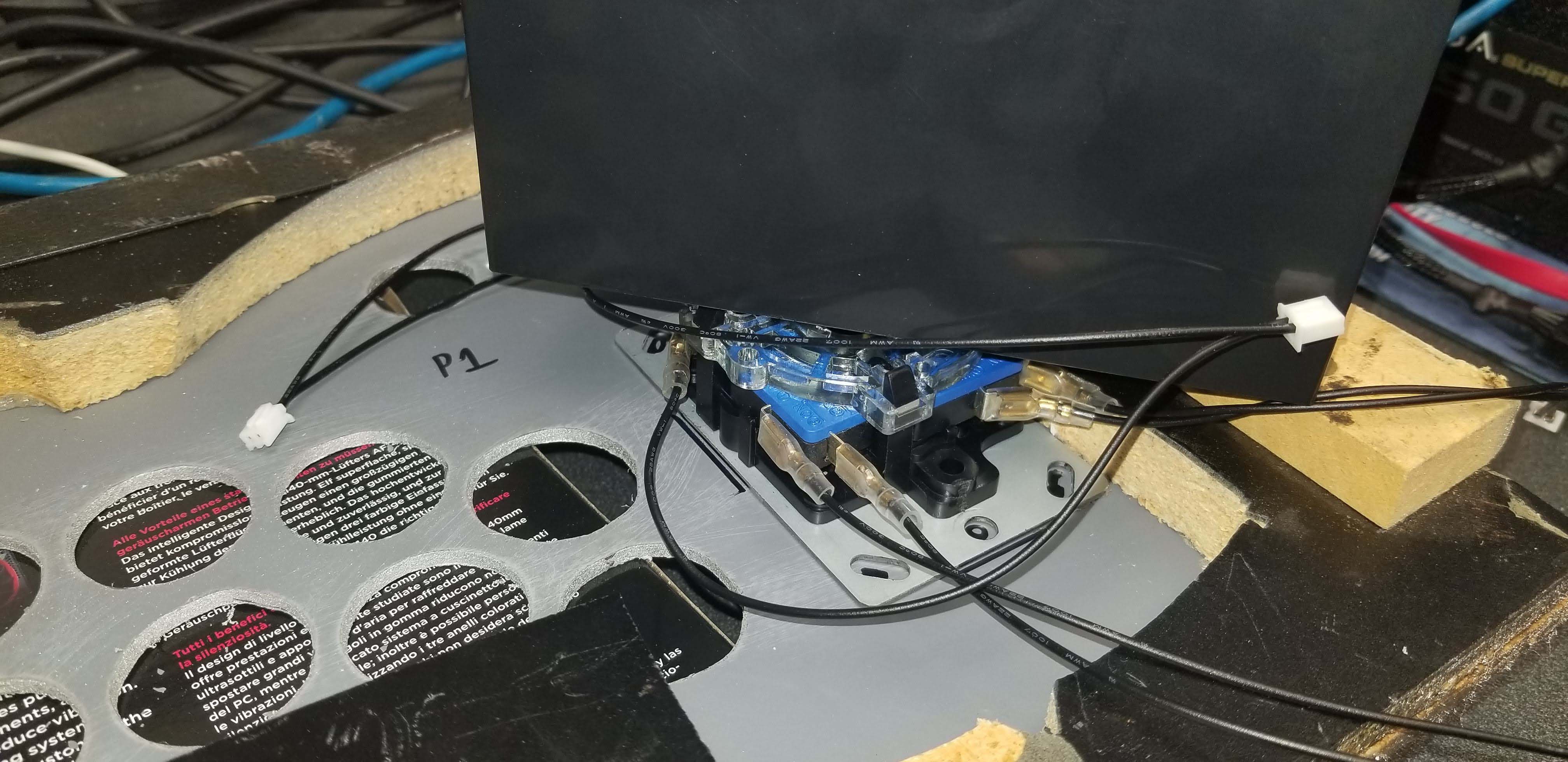

The joysticks got the same epoxy treatment and lead acid battery clamping technique:

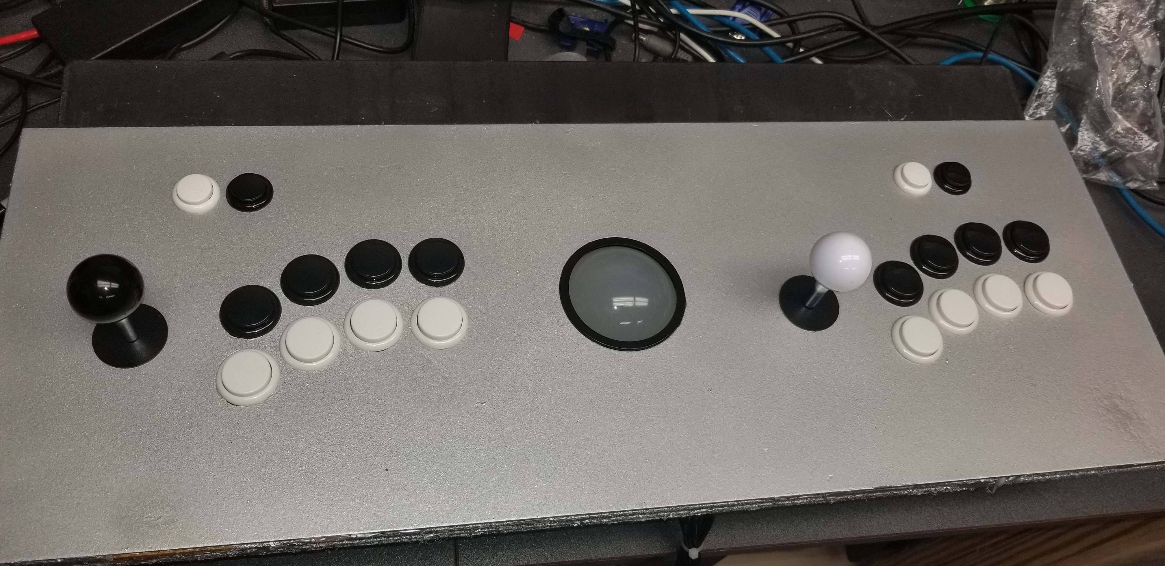

I used a set of those zero delay encoders that seem to be popping up everywhere now for both sticks. The encoders themselves seem fine, but the buttons are very cheap and don't feel very nice. Also the microswitches on the joysticks could be smoother. The seem to take a long time to actuate. I'll probably spring for a set of GGG switches at some point, but as I've already exhausted my company budget of "Just don't spend anything on it", I'll probably wait until someone actually complains other than me.
For as sketchy as the epoxy felt, the finished product really took me by surprise with how much I liked it. Also, it is solid as a rock. The complete panel probably weighs something like 15lbs. We'll see how well the epoxy holds up to people beating on it with fighting games and the like, but the wood of the cabinet is going to break before this thing gets bent or flexes.

Eh... Anyone considering cutting out their own metal CP... Include mounting holes in your cut pattern. Don't like exposed hardware? Try weld studs. If you ever need to take anything apart, epoxy will ---fudgesicle--- you.
I was hating myself the whole time I was mixing the epoxy. Weld studs. That's a fantastic idea. I've never really worked with metal at all, so I can't say I thought it through all that well :D
The panel itself was cut out of some scrap metal, so if I really had to re-do things, I could probably get another cut pretty easily.

I haven't used epoxy, but honestly curious -- why is it such a bad idea?
newmanfamilyvlogs
  • Posts: 1694
    • Newman Family Vlogs
Re: Agitation Arcade
« Reply #15 on: March 01, 2019, 04:12:09 pm »
Because it's very much a one-way-street. When I eventually decide I can't deal with the horrible USB interface on the Happ 3" track ball, I get the distinct feeling that removing the trackball from the panel is going to end up destroying the trackball housing trying to separate them.
I always think this, and then I thought flush-mount bolts and countersink the holes. Panel is thick enough - and it's steel.
As for removing the trackball: pry bar and hammer, and slowly work around. But if removing the trackball, it is likely to replace it, and then who much cares....
