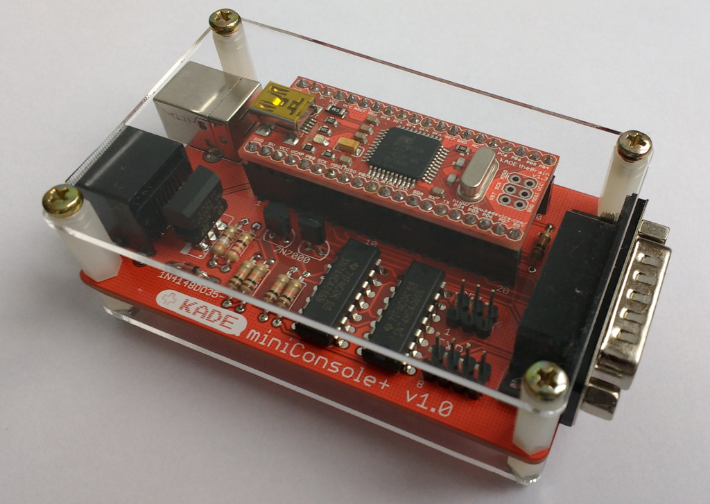

Controller ports
I mentioned earlier that this bartop is using miniConsole+ devices to operate the controls.  What's awesome about these things is that you can use the arcade controls and hotswap most controllers on the fly in order to control each game however you want.  The controllers plug into a DB15 port, so I had to decide how I wanted them integrated into the machine.  Honestly DB15 ports aren't the sexiest looking things, and after trying many layouts with the ports on the front I decided on a less conspicuous placement by putting them on the back and having cables as opposed to fixed ports.  I bought a DB15 cable to butcher, and then both male and female terminal housings in order to hook everything back up.  You don't really need the terminal housings, you could just solder it all using standard cable ports but I wanted to be absolutely certain that each wire was going where it was supposed to. And I'm lazy.
The plugs that I cut off and threw away
The female housing with all of the wires hooked up
The back of the bartop with the finished cables coming out of tiny holes and then attached via industrial velcro.  We'll see how this holds up over use, but so far it seems pretty sturdy.  Oh, the cable I used was tan and looked really out of place back there, so I just took a couple black heat shrink tubes and threw them on the parts of the cables that would be visible.
For those not familiar with the miniConsole+, here's a pic of a snes cable plugged into one
I already have cables for most systems, and plan on fabricating duplicate cables for 2 player games (assuming that I even have 2 controllers for whatever system it is).  There are wiring diagrams available on the Kade forums for most systems, so all you really need is an extension cable for the specific game system and a DB15 male port with shell.

This is why other folks should post their projects.  I knew nothing about KADE miniArcade until this posted.  The hardware caters to console enthusiasts filling a real niche in the hobby.  This gives me all sorts of ideas, nooooooooooooo.    :laugh2:  Good stuff, I'm following with interest!
thatpurplestuff
  • Posts: 670
  • Last login:September 28, 2026, 04:59:41 pm
Re: Vintage Bartop
« Reply #10 on: February 23, 2019, 03:45:47 am »
Ond- yeah from what I understand the miniArcade is pretty similar in functionality to the miniConsole+ and sounds cool, but I honestly don't know a ton about it other than I provided some pics of Saturn controller connectors a while ago to help out the project haha.  I would love to see them gain popularity!
Unfortunately I think the miniConsole+ is no longer being developed (the kickstarter that I got these from was a pretty big disaster... if I recall correctly the goal was to have all units and cables delivered by end of 2015, and I think I just read that there are still a few people in the UK waiting to get their shipments over 3 years later).  I don't want to get into the drama of it all, but I believe one of the members that had a lot of the parts had some things going on personally and just sorta disappeared for a while.
Good news is that it looks like everyone is finally getting their devices, and also Bruno is selling a revised version of the device that looks promising called the RetroPad32.  The only thing that it seems to be missing is the board to hook it up to arcade controls... hopefully he starts selling those too, if he does I'm definitely picking up some for future builds!  It's really unfortunate that the kickstarter went the way it did, because I feel like if it had gone smoother these miniConsole+'s would have really caught on like wildfire.  The ability to use arcade controls AND hotswap any controller you want without worrying about USB ids or anything is freakin awesome!  It can also plug into actual consoles, so you can use a SNES controller on a Genesis console or a TG16 controller on a Playstation.  Not really my thing, but just shows how powerful these things are.
A few minor points of clarification:
KADE miniArcade is the old Minimus AVR encoder (AT90USB162 or ATMEGA32U2)
- As the name implies, it is mostly focused on arcade controls
- No support for analog controls
KADE miniConsole+ (ATMEGA32U4) http://forum.arcadecontrols.com/index.php/topic,142133.0.html
- As the name implies, it is mostly focused on console controllers
- Support for analog controls
KADE miniArcade 2.0 (ATMEGA32U4) http://forum.arcadecontrols.com/index.php/topic,154126.0.html
- Documentation focused on how to "roll-your-own" that covers cable pinouts/fabrication and using a wide variety of different 32u4 AVR boards to avoid some problems encountered with the miniArcade (Minimus board availability) and miniConsole+. (waiting for someone else to fabricate cables)
RetroPad32 - http://www.brunofreitas.com/node/84
