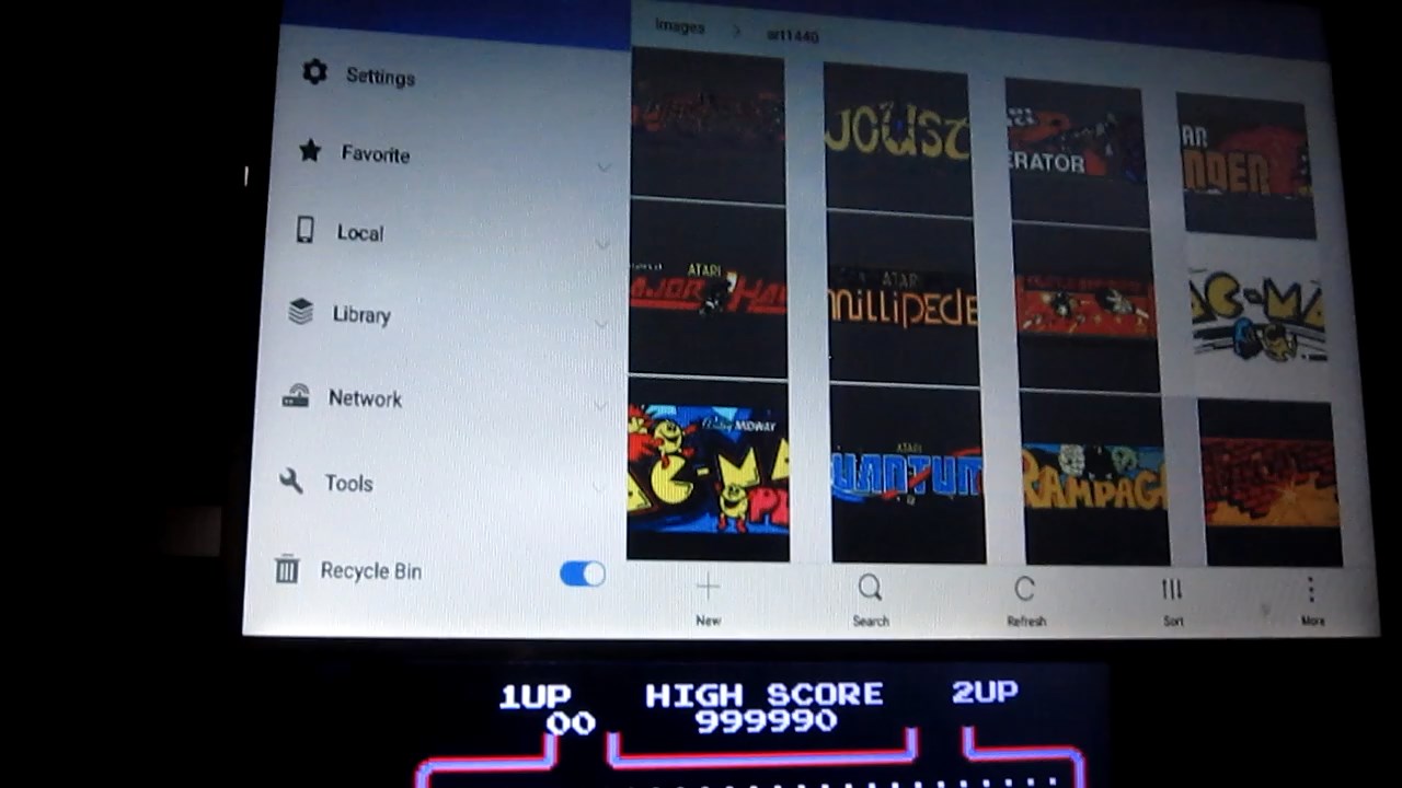

Great News: You CAN use AMAZON firestick ($20) as a media player
For initial setup, you will need to create an amazon account [no money needed], and have internet access.
Fortunately, to run the application, YOU DO NOT NEED INTERNET ACCESS
1 Buy a used amazon firestick, any model
2 Install ES file explorer [free]
3 Run network settings, run remotely
4 It will display an FTP address
5 Run FTP program from PC/phone/tablet with artwork
6 Transfer image files to Firestick, and remember folder
7 You can disconnect from internet
8 Go to settings -> manage applications -> run application
9 Now you can run applications. In ES explorer, browse to images. Display images.
There is a tiny little circular icon on the far right, but it's not a big deal.
For the monitor I got, the 17.1 inch, the viewing angles are excellent, and much better than the stock Arcade 1up one.

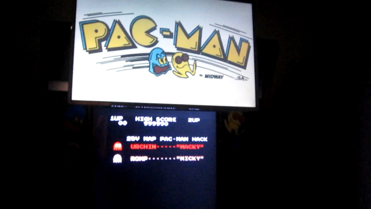

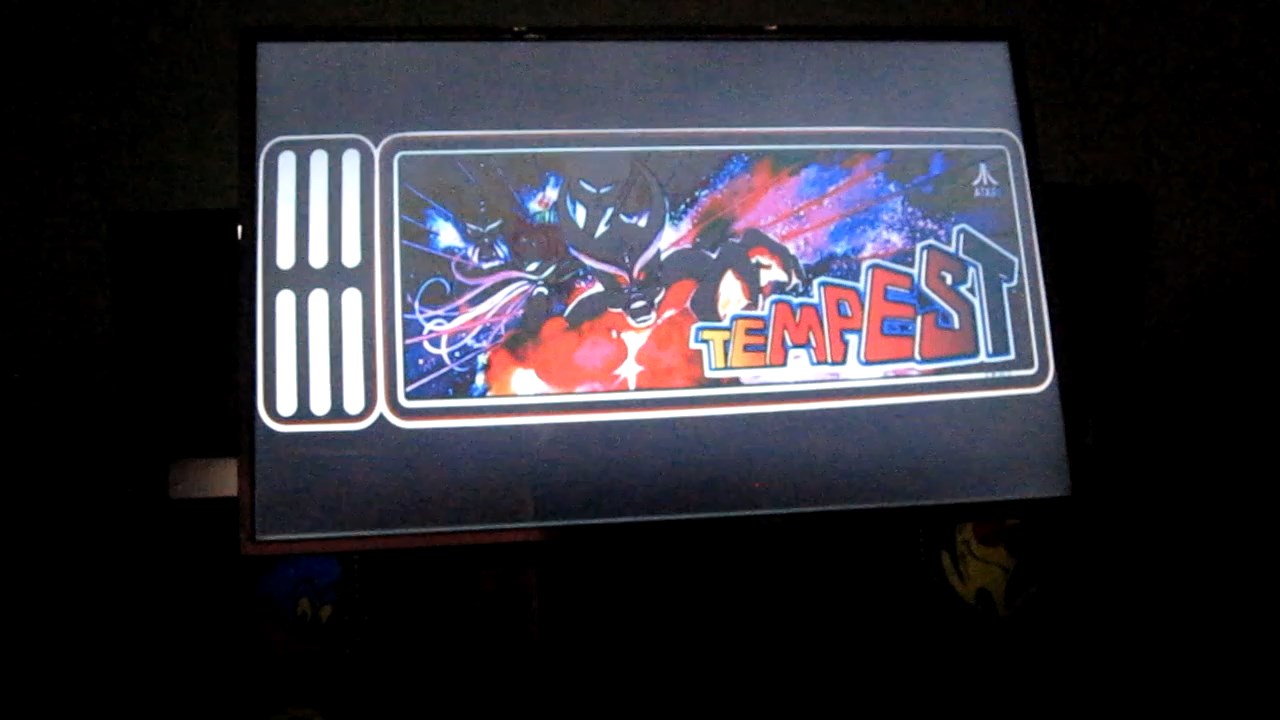

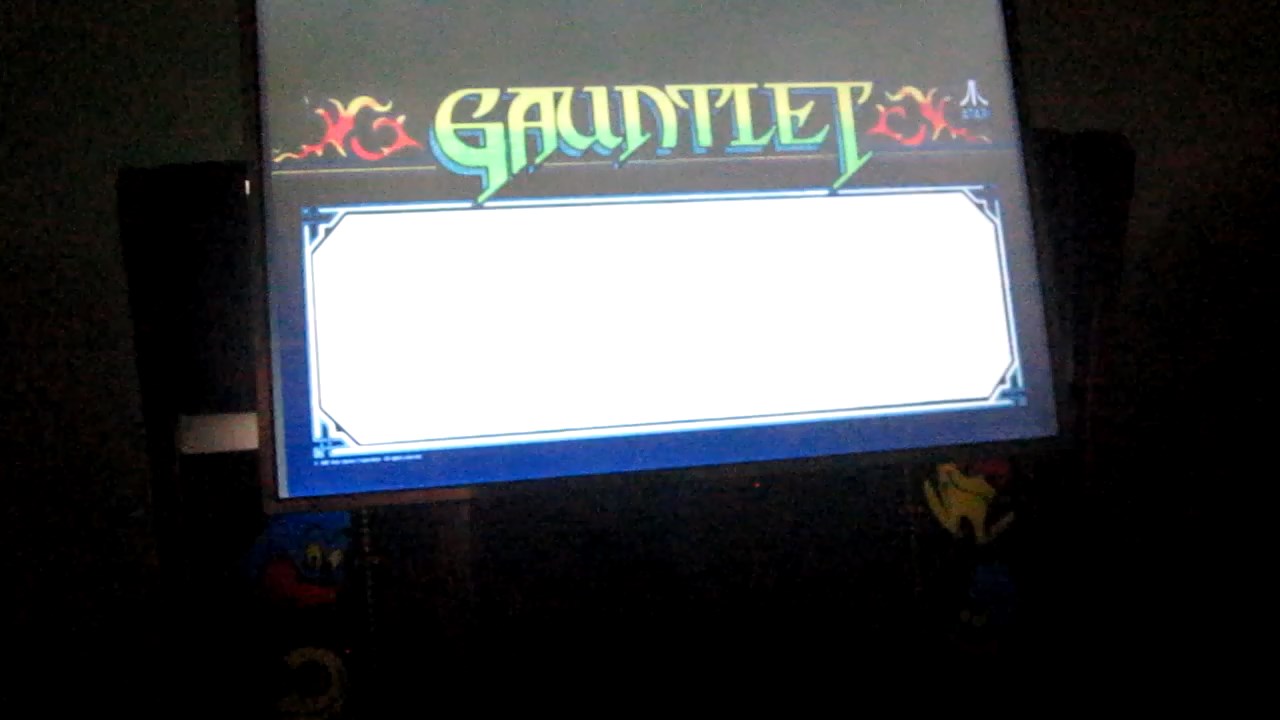

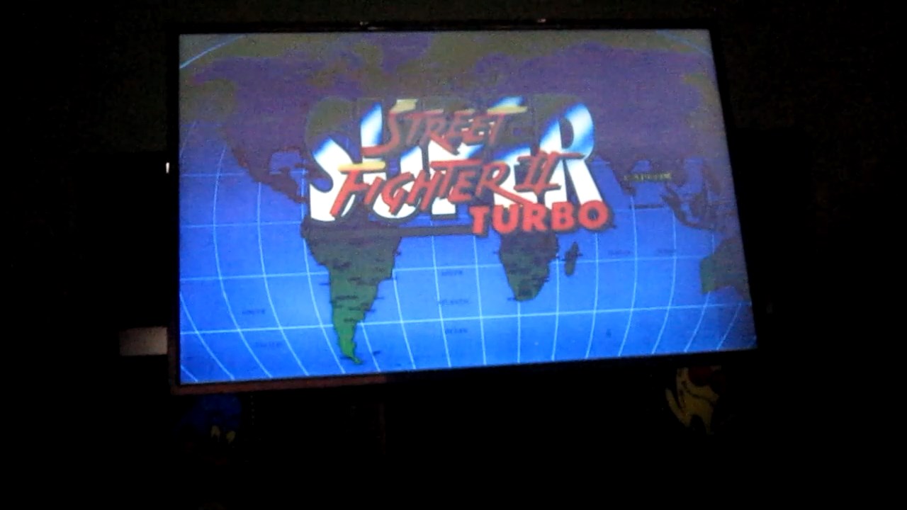

negative1
  • Posts: 1210
  • Last login:August 25, 2026, 06:30:40 pm
various images of the LCD Marquee I used: Images are washed out, because of pictures in the dark.
The real ones that are cropped, have a black background that is not noticeable.
I added white to the Pac-Man background, maybe I will do that for the others to fill the screen.
later
-1
« Last Edit: January 04, 2019, 07:55:22 pm by negative1 »
