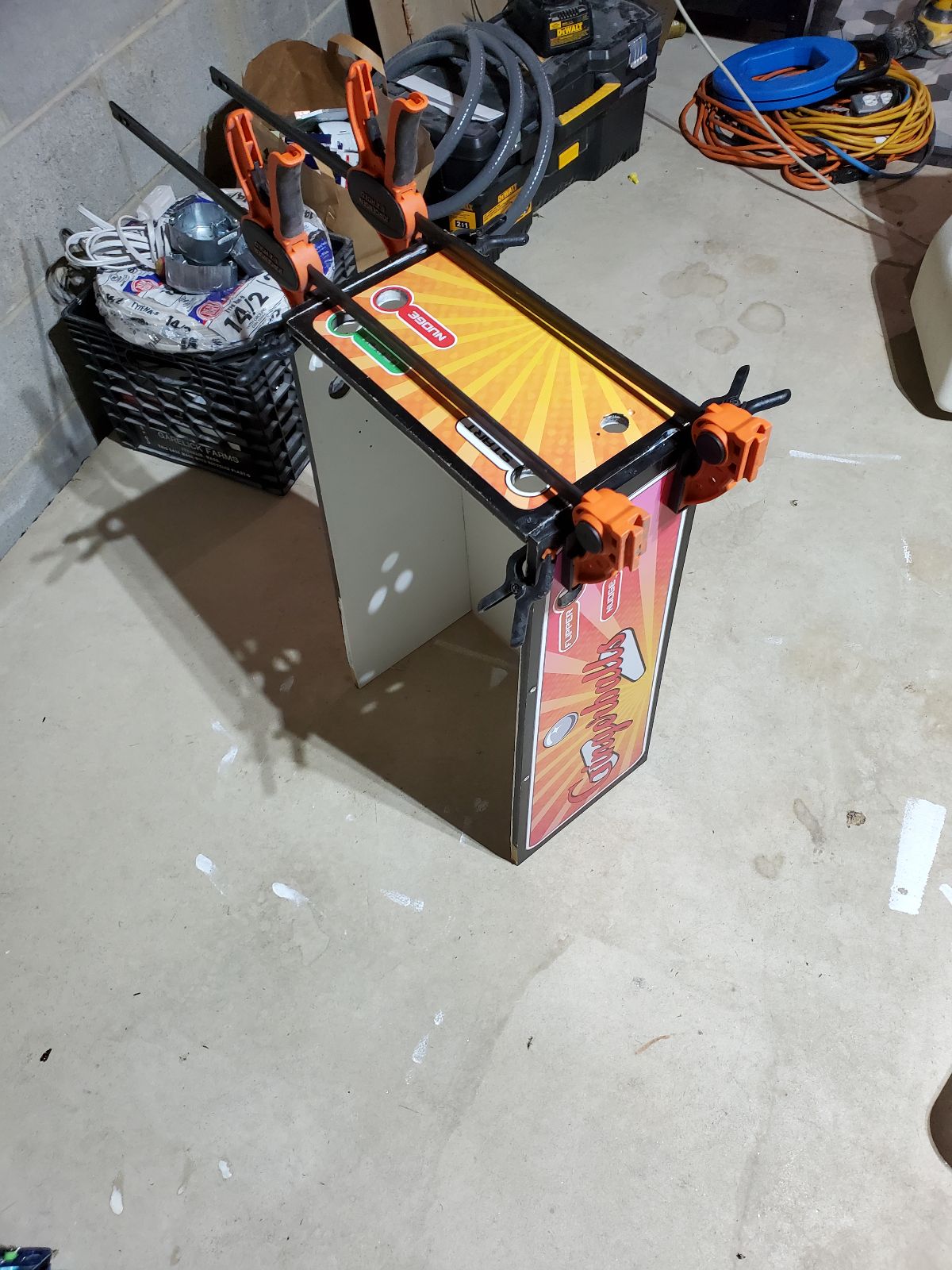

So I cleaned up the all the corners and cut a new base. Painted the inside primer white, but left the fan hole piece original black, its an accent wall!
Then I moved stuff around loose forever till finally settling on this footprint. Its not quite what I wanted but its the best I could do without having to cut new front, back, and bottom pieces.
Yes, I installed motherboard standoffs.
I did clone the SATA SSD over to an M.2 SSD so that there are fewer power and data cables. Next step is to route all the power supply cables along the sides, determine if I want to put an intake fan in and if so where. After all that is done, I'll have to mount the "force feedback" solenoids , driver board, etc  Last step will be mounting the last piece of wood to the base that the backbox sits on then figuring out all that cabling. I'm still not sure if I should keep the Dell soundbar or put speakers in the cab body.

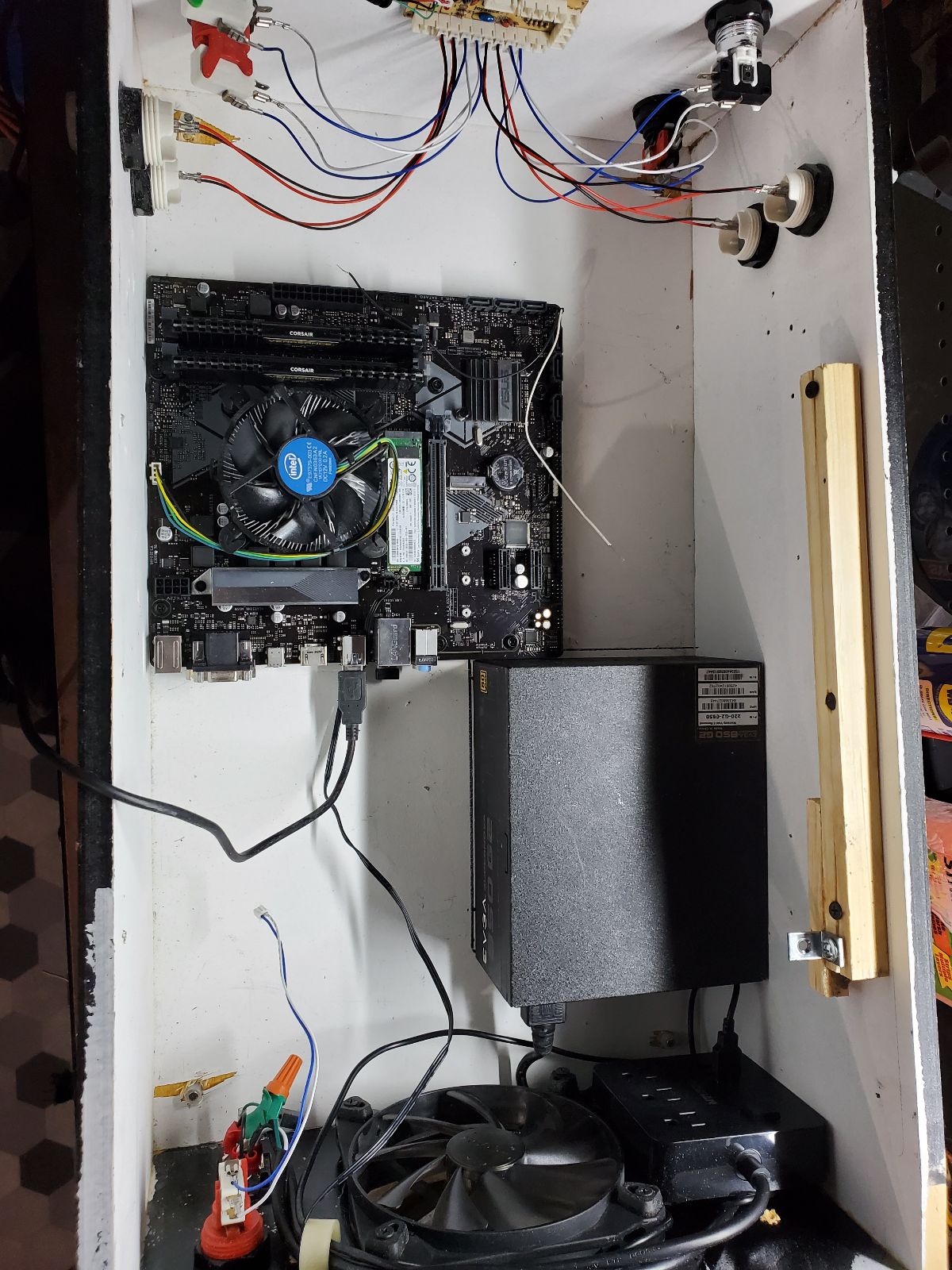

So when trying to sort the wiring, the layout I chose just wont work. So I pulled it all out, filled in the hole and moved stuff to here:
Slapped a 2nd M.2 SSD in there so I have almost 1TB of storage. Plopped in the 1660Ti video card and mounted all the force feed solenoids.... they really make the wiring look like a mess.
I decided to just keep the existing wiring because Im just not up for running all new neater cables; out of sight out of mind?  Either way this is still a step up from before.
Only big changes are:
Mounted PSU vertically
Had to add a thunderbolt USB hub because I needed 5 ports and only had 4.
Pin2DMD will get powered over USB, fed from the USB on the outlet, not the PC, instead of tapping the molex connector.
Things still left to do:
install an intake fan or two (might have one blow up vertically, and then stand one up to blow air towards the GPU/PSU)
fabricate and install air flow guides (specifically directing intake to GPU/PS and directing PSU exhaust to big fan in the back)
update the software that's been stale for almost 2 years
play some virtual pinball!

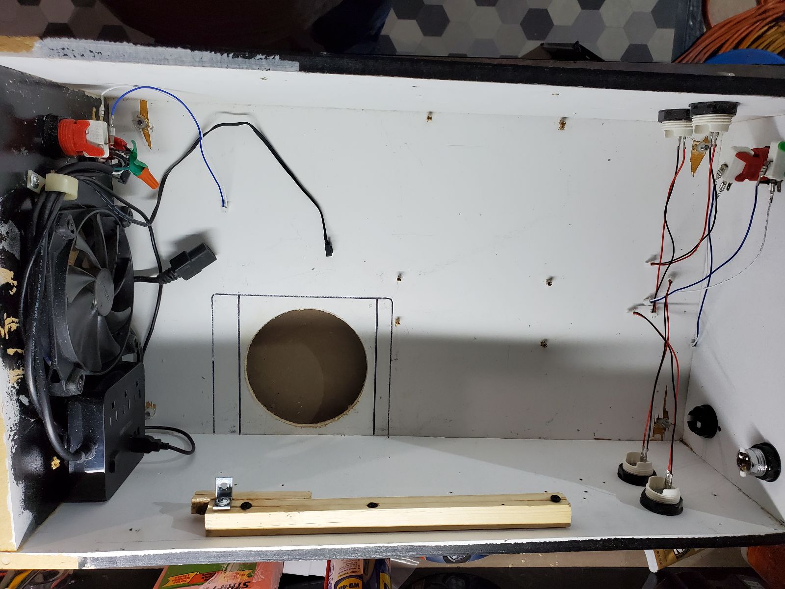

Well my buddy built a new PC and couldn't get a GPU anywhere, so I pulled the GPU from ginger for him to use. Fast forward 18 months, and I got a 3060ti for my PC, so he gets my 1080 and I get my 1660Ti back.
The PC inside ginger, while better than the ---steaming pile of meadow muffin--- they put in most commercial VPINs, was still a little dated for my tastes. I dont see me replacing this 8th gen i5 for a loooooooong time.
I did get the intake blowhole done, just going to angle it a little bit and tape off the bottom. If temps become a problem, I'll get an aftermarket CPU cooler.
I also had to flip the "sling shot" solenoids over to make clearance for the monitor.  Ginger 3.0 is still in the planning stages, but I'm kind of looking forward to a full sized VPIN. Already have the 4K TV and the analog plunger kit thingie.
I will probably clean the wiring up a bit more, and Im going to order shorter power and video cables for the playfield monitor.

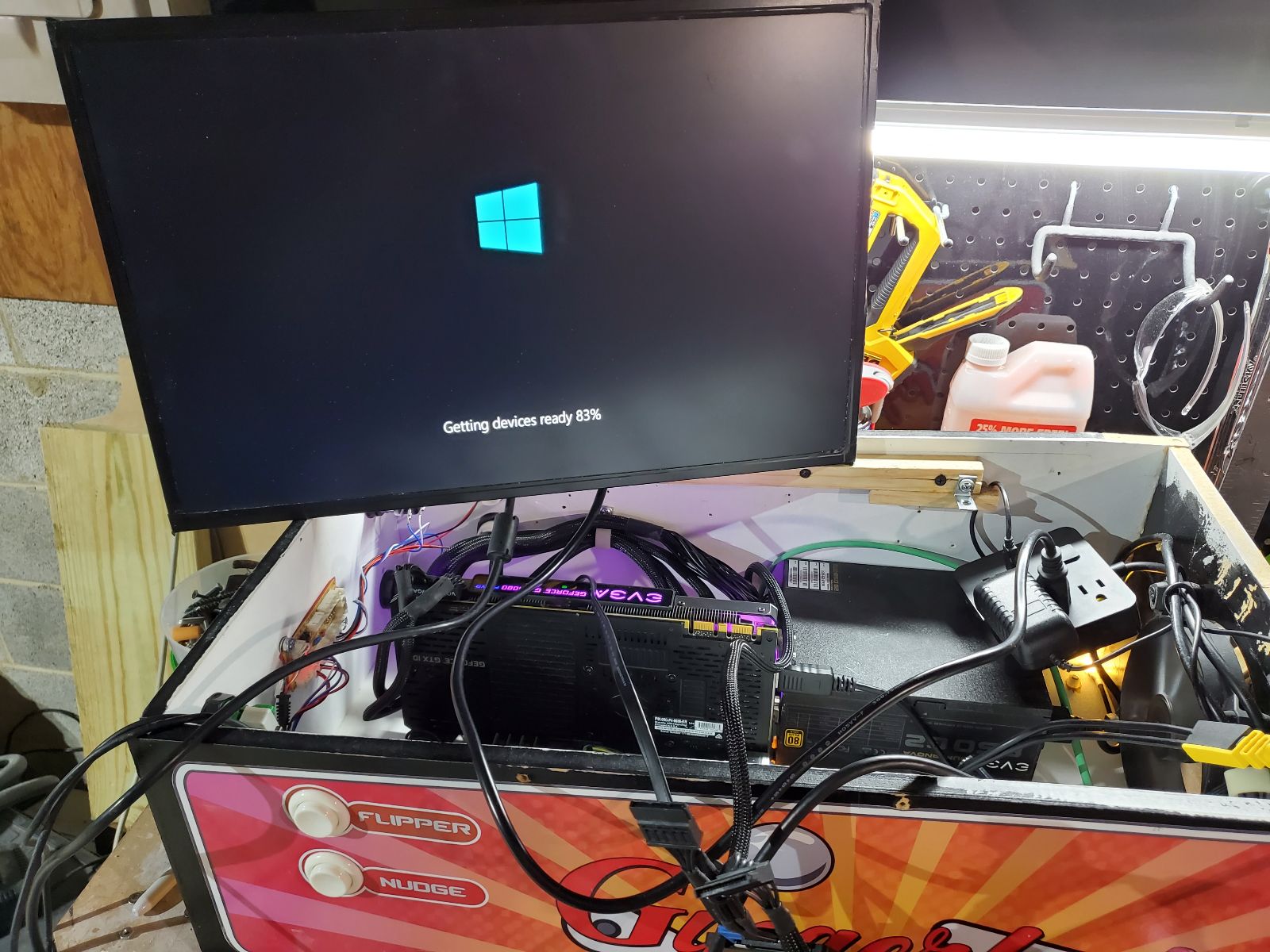

I ended up plopping my other 1080 (SC) in:
and it clocks pretty great, but I think it might run too hot.
https://www.userbenchmark.com/UserRun/46127837
