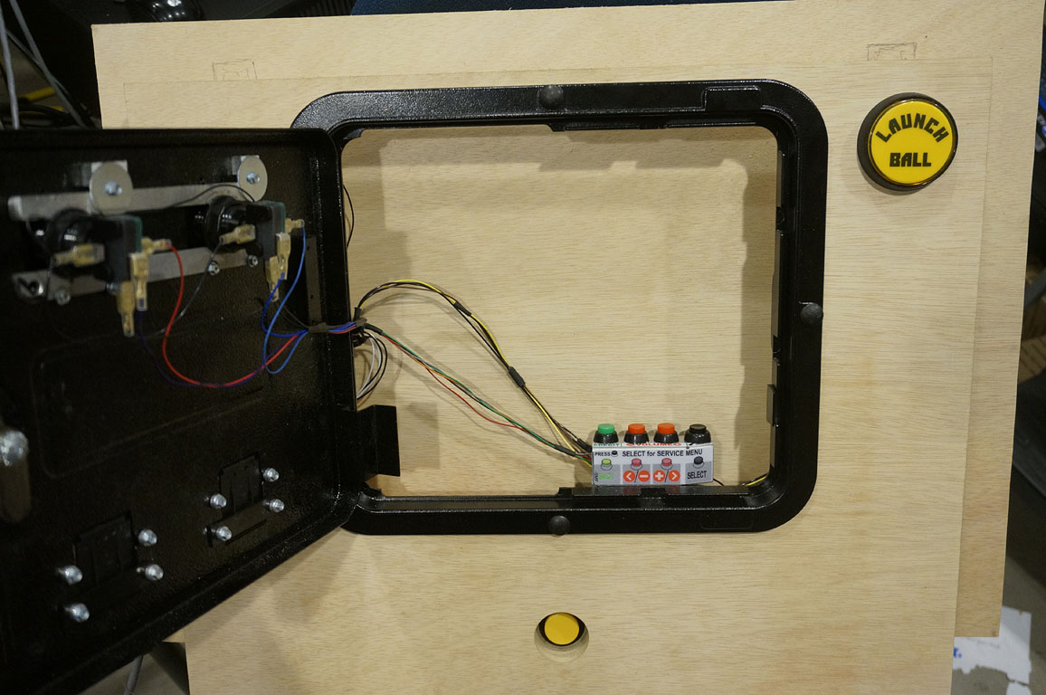

So, anyway, I started fabricating the front box of the pinball half of this thing.
Here's the first bit.  I used a jigsaw, dremel and orbital sander to inlet the coin door hole, I messed up one of the corners (top left, here) - but not worse than the coin door flange covers, so, enh.  Good enough.  The door fits quite well side to side and top to bottom, so the oversize corner isn't much of a problem.
Setting some stuff roughly where it belongs, here's the first mockup;
Actually, I'm lying.  This isn't the first mockup.  The first time I set this stuff together I realized I'd made a math error, the front panel was too wide.  (cough)
Luckily, cutting it down to the correct width gave me a chance to also adjust the centering on the coin door by about 1/16", so it's very centered now.    This is actually the second mockup.
The yellow Sanwa button at the bottom will be recessed behind the plywood, and will be the Exit button for pinball games.
Looking at the thing from a lower angle, you can see how thin the whole front box ends up being.
Considering how much of it is 3/4" plywood, once that's glued and screwed together and the legs are bolted in with 8x 1/2" bolts, I don't think torsional flexibility is going to be a major problem.  This thing should be pretty stiff.  (Heh, heh.  Heh.  Heh.)
There's going to have to be some shallow relief cuts in the inside of the back wall to accommodate the switch housings on the buttons, about 1/8" deep.  You can very much see why the coin door access hatch is necessary for servicing parts, reaching down that slot to the bottom to swap an exit button would be hellish otherwise.
A thing I think is cool about this design is that the legs are outset by their wall thickness both forward and out.  If everything works out as I've planned, you'll see their 1/8" wall thickness like they were traditional L-shaped pinball legs bolted onto the outside of a traditional pinball cabinet.

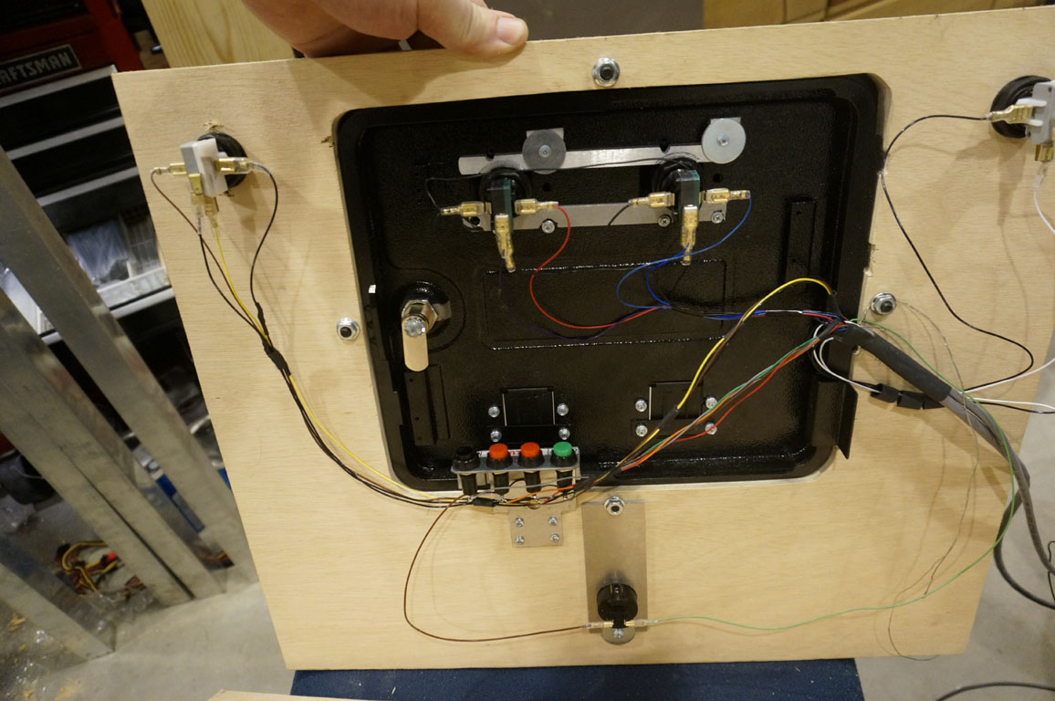

I've gotten started on the wiring harness for the front box.
Another interesting detail from this angle is that aluminum plate the exit button is mounted to.  I wanted it removable for servicing without repeatedly moving a screw in wood.  The screw and washer at the bottom never needs removed.  The plate is notched top and bottom, and fits snugly between that screw and the bottom carriage bolt of the coin door.  Remove the nut from the carriage bolt at the top of that plate / bottom of the coin door, and the plate tilts out from under the washer.  That'll mean it can be loaded from the top via the coin door opening when everything's permanently together.
Near the bottom is a 4-button bracket of pinball service buttons I'll be mounting in the box behind the coin door.
(This wiring harness still needs a fair bit of work and looming, it won't be quite this ugly when I'm done.  The door does swing completely open, the wire lengths on the coin buttons are good.)
But, from the outside -
Kind of starting to look a little like the front of a pinball machine, maybe!  I'm chuffed.

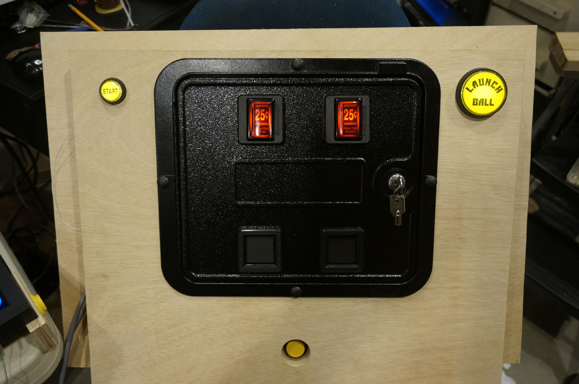

This yellow Start button - man, look at the light leakage from the white LED behind it!
The degree to which it does not match the yellow Launch Ball button next to it is absolutely untenable.   :cry:  What is this.  I can't even.
I tore the button apart and swaddled the LED with yellow translucent tape.
Much better.  Now they match:
Crisis averted.  Project salvaged.  I can now proceed.

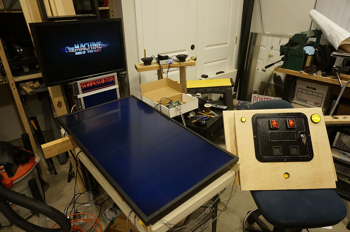

Anyway, once I had pinball service buttons, I had to play with them, so I lashed up another mock-up.  It was a chance to hack on the custom front-end software, too... and maybe a chance to sit down in a chair for a while, too.
Here's the custom front-end running in Pinball mode.
(The white masking tape line on the DMD monitor is the depth mark I plan to sink it to inside the backbox.)
Tables are selected with flipper buttons, they fade in and scale from the sides, the center one is fully opaque and much larger.  The next two games in either direction are visible.
Fake DMD display shows a fake DMD-ified logo, and scrolls DMD-styled instructions along if you don't get the hint.  I'm going to randomize among many Shapeshifter logos every time you go back to the menu, because I think it's charming if a machine named Shapeshifter doesn't stick to one visual theme there.
Pick a table with Launch or Start, and it loads up like so.

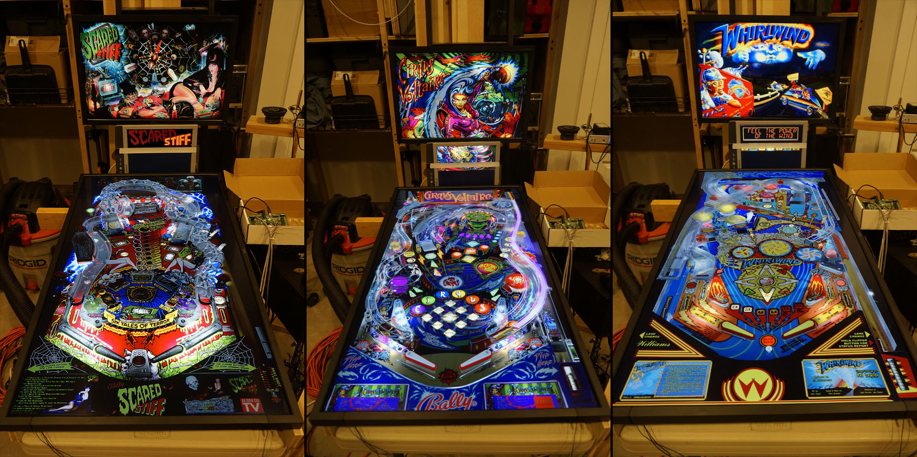

I have been tinkering a lot with the backglass configuration.  I am discovering that I am really picky - most vpins seem willing to aspect ratio squish the backglass art, and that drives me up a wall.  I had to add code to my front-end so that it overwrites the B2S resolution settings per table before launching, to allow me to micromanage how every single table on the list works individually.
I'm not using a real DMD because I want to be able to use that space differently in different tables.  Here's where I'm going with it so far:
On tables like Scared Stiff, it's pretty easy - the art fits on the big backglass monitor, the DMD fits on the DMD monitor, that's the straightforward case.  About half the tables turn out like that.
Cirqus Voltaire had the DMD down in the playfield.  I'd like to keep that look.  So for it, and for games that just had no DMD, I've carefully aligned the software position of the DMD panel to be centered, portrait, and below the backglass desktop, and I'm stretching the backglass across it.  It's not perfect, you'll have the bezel lines cutting it, but I like the effect better than blanking the DMD panel out - and especially better than squishing the art.
Whirlwind is an example of a game where the backglass did a good job with 15-segment plasma lights.  They look really nice.  With a lot of careful finicky tinkering I've gotten the segment display to line up nice in the DMD section, and that again keeps the art above at the right aspect ratio.  I lose the status lights below the segment display, but I think I can live with that.

Bit more progress to share.
Shapeshifter won't be clamping down the lockdown bar like a real pinball machine does, because the full assembly is 1) about $80 and 2) won't fit.  So, instead, I'm using a pair of overcenter control panel latches, like so:
The hooks mount on the lockdown assembly, the clamps mount on the back wall of the absurdly shallow 1 1/8" box.
For a sense of how tight things get in here, have a look down into the top when the coin door is closed:
The overcenter latches and the coin buttons occupy the same vertical height.  That red line in the circle is showing the actual clearance between the right latch and coin button.  Good times, eh?  They don't touch though.
Man this thing is thin.
Speaking of tight clearances, I want one of the driving-game-mode speakers to be on the backside of the front box.  The speakers I'm using have a mounting depth of 2" under the flange, and I'm putting them into a box with 1 1/8" of interior space.
No problem.
Here's the result of a lot of Dremel work.  Reasonably happy with it, though the burr did get away from me once, I've got a scar in the wood to bondo up later as a result of that accident.
If the fit looks a little rough, well... that's only a 4" speaker, man, this is a tight close up, the pic is larger than life size.
And... also, the fit is a little rough.
It was important that the speaker drop sub flush -
because the playfield / windshield monitor assembly is going to be swinging by just above this surface.
So, how does sinking the speaker in like that that possibly work with the total dimensions?  Well, there's also a clearance carved out in the backside of the front panel.
And you can see on the left, the back side of the coin door, showing again how much clearance I tend to have in this thing - that's how much the speaker magnet doesn't hit the coin door frame by.
All this work has the front box frame getting moderately close to assembly.  I think I'm going to shift gears next and work on the back box frame for a while.

Mostly, I've been working on software configuration, which isn't really conducive to gratifying photos.  Making a lot of progress on that side.
I found that the pinball service buttons sometimes don't work, because the emulated pinball machine doesn't think the coin door is open, and there's safety interlocks there.  That got me to thinking, hey, I could map a key to a microswitch there, that'd be cool!
Except, the software isn't straightforward for that, of course.  For the same reasons of computer-side convenience that lead to the old hi-lo shifter situation, they implemented it as a toggle, not a continuous input.
But I got to thinking.  I can still work with that.
So I made this:
That's an aluminum bracket that mounts a lever-type microswitch just under the L flange on the coin door.  I bent the lever, like so:
Hard to see, but it's kind of a carat shape, ^ - high in the middle, low on the ends.
I lined everything up such that the door flange isn't normally depressing it, but when swinging past, it rides up the ramp and clicks the switch then releases it, in either direction.
(If you ever do fall out of parity, it's easy enough to just open the door and click the switch one extra time.)
Works like a charm, and it's pretty cool to open the coin door with a pinball game running and have it flash the high voltage shutoff message and enable the service buttons.
