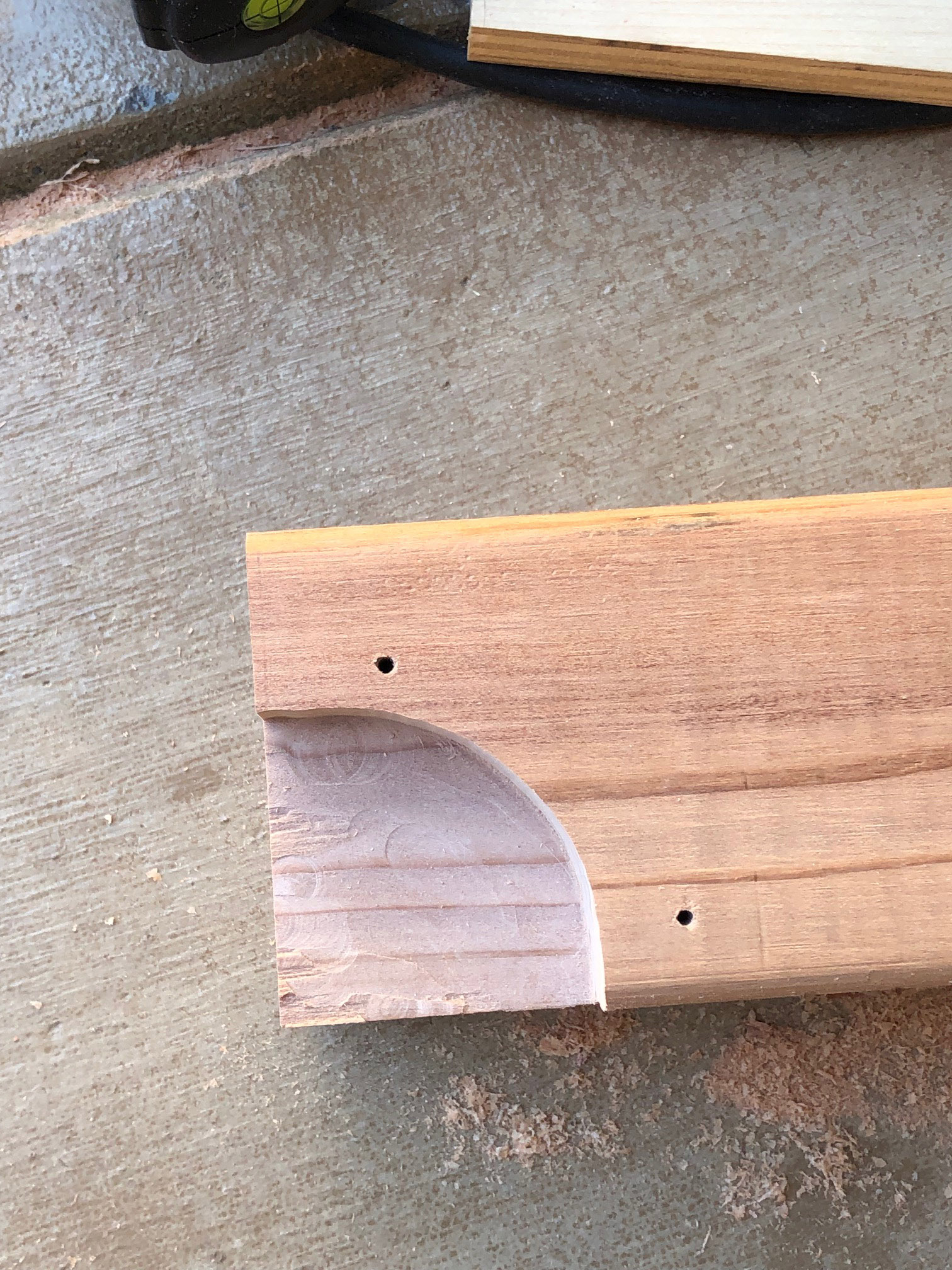

Got some time again on Sunday and a little yesterday.  Decided to tackle the base as I would like to be able to start assembling the lower half soon.  I bought some casters from Penn-Elcom as they were rated to handle a heavy load.  The metal frame on them is 3.25” so I was grappling in the design phase on how I would mount them.  I came across 3.5” redwood while looking around home depot and thought it would be perfect so I grabbed the default 10ft. piece:
I thought this would also help to add weight to the base to lower the center of gravity…just in case.
My usual techniques failed as a jig saw cannot cut through as the blade starts to bounce on the wood it’s not able to cut on the downstroke, started to get unruly.  I had borrowed a co-workers very basic circular saw with a very old blade and figured screw it:
Cuts didn’t come out too bad:
But the blade wasn’t long enough to make the cut on one or even two goes, so I had to repeat the above on all 4 sides.  Got me my rough cut and then it was off to routing for a smooth edge……errr:
As you can tell I could have really used a good table saw or circular saw as it became a pain in the ass to cut, lower, cut, lower, flip, change bit, cut, raise, cut raise.  Doing this for 4 pieces and 2 sides each translated to the better part of the morning/afternoon.  I did get my dimensions right and did have clean surfaces so that’s a plus:

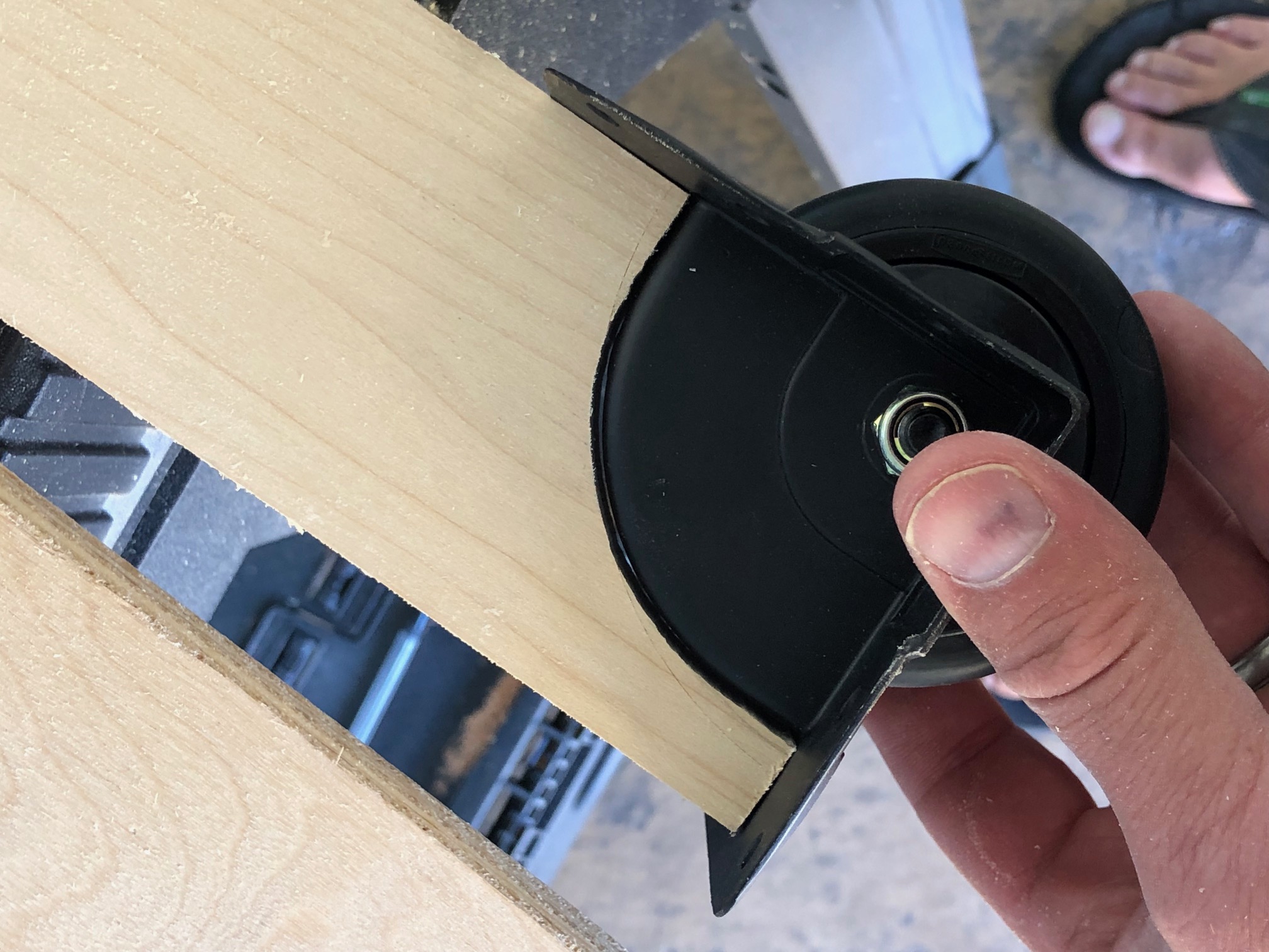

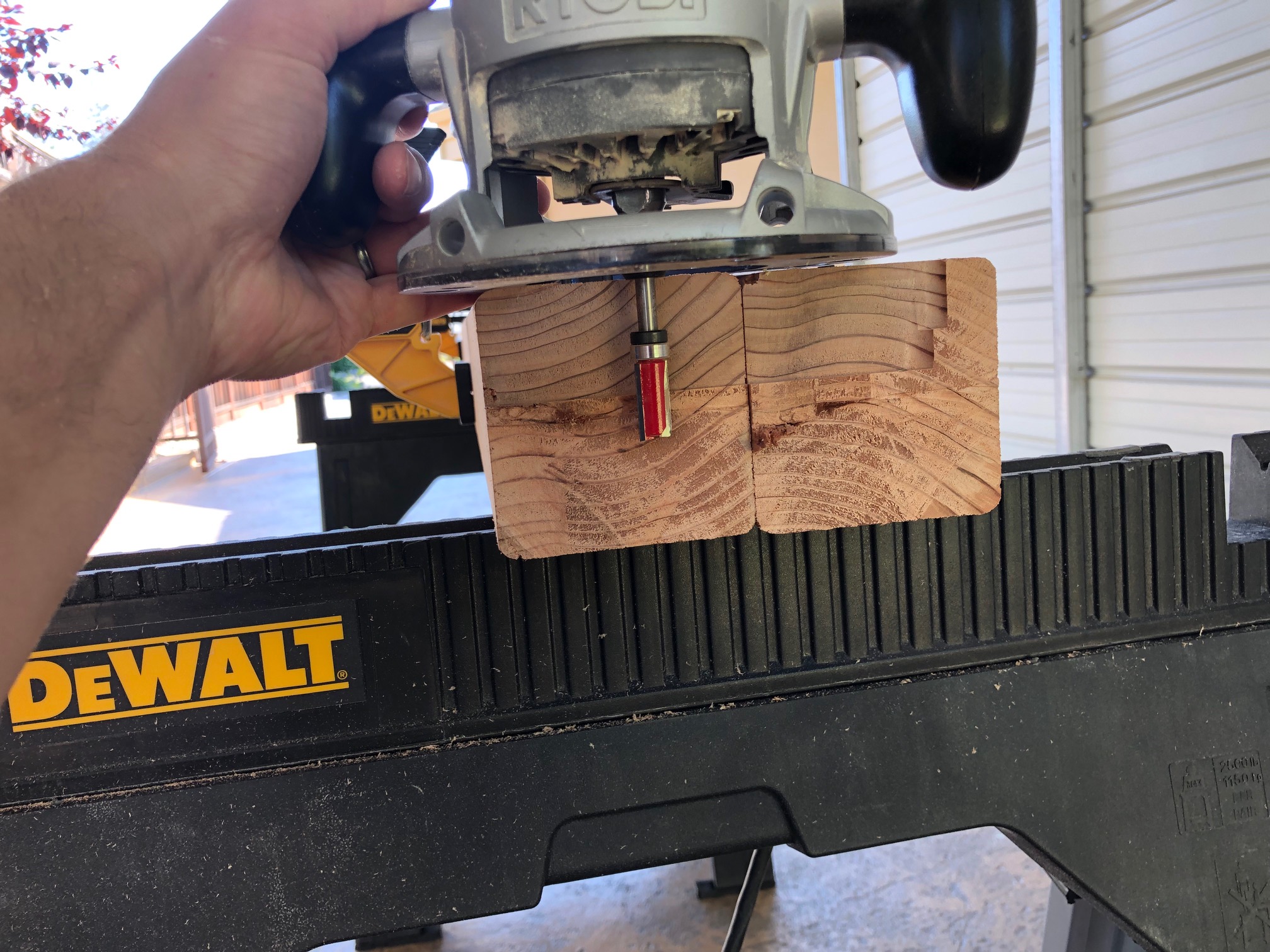

Next was routing out the necessary areas to fit the castor.  I struggled with this for awhile as it took quite a long time drawing circles for me to realize that the caster frame wasn't actually a circle but was straight near the edges.  So as I was short on time and because I wanted to get something done and this wasn’t going to be something anyone would see I decided to trace the outline as best as possible and freehand a template.  Didn’t come out too bad:
Placed the template on top of the piece:
which presented an issue setting up a stable cut, so this was the best I could come up with:
Could really have used a nice vice, but this worked:
Routed the other piece:
Was pumped to put it together:
Dooohh!!
Oh yeah it has bolts, duh.
Cut some more out free hand and finally got what I was looking for:

The Shop Vac has allowed me to work in the garage as dust was such an issue in there I stopped a long time ago.  This means I can get some work done during the week!
I needed to cut the support pieces (blue arrow) for the curve below the coin door so that it can match the curve on the side panels:
Printed first and traced:
Used my bender board and brackets again:
(Had to trace again to the left of the one to the right to capture the support of the brace on the right).
Needed the router table for this one as I don’t know how else you would cut this…..
Second pass on the back side with a straight piece of wood (cut most with a jig saw first of course):
Almost there:
Last pass on the back.
Now I use that as a template to cut 10 more…..this will probably present its own challenges and if I were to design this again I would probably make this a bigger piece so that it’s easier to work with….
