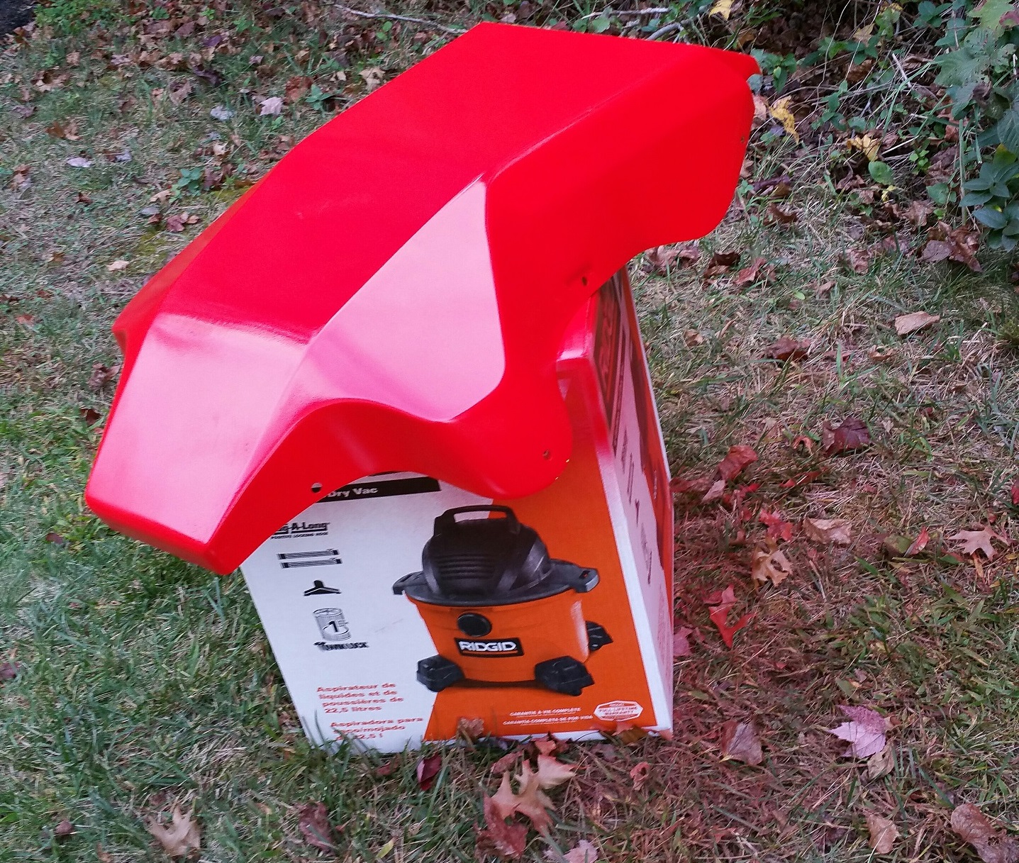

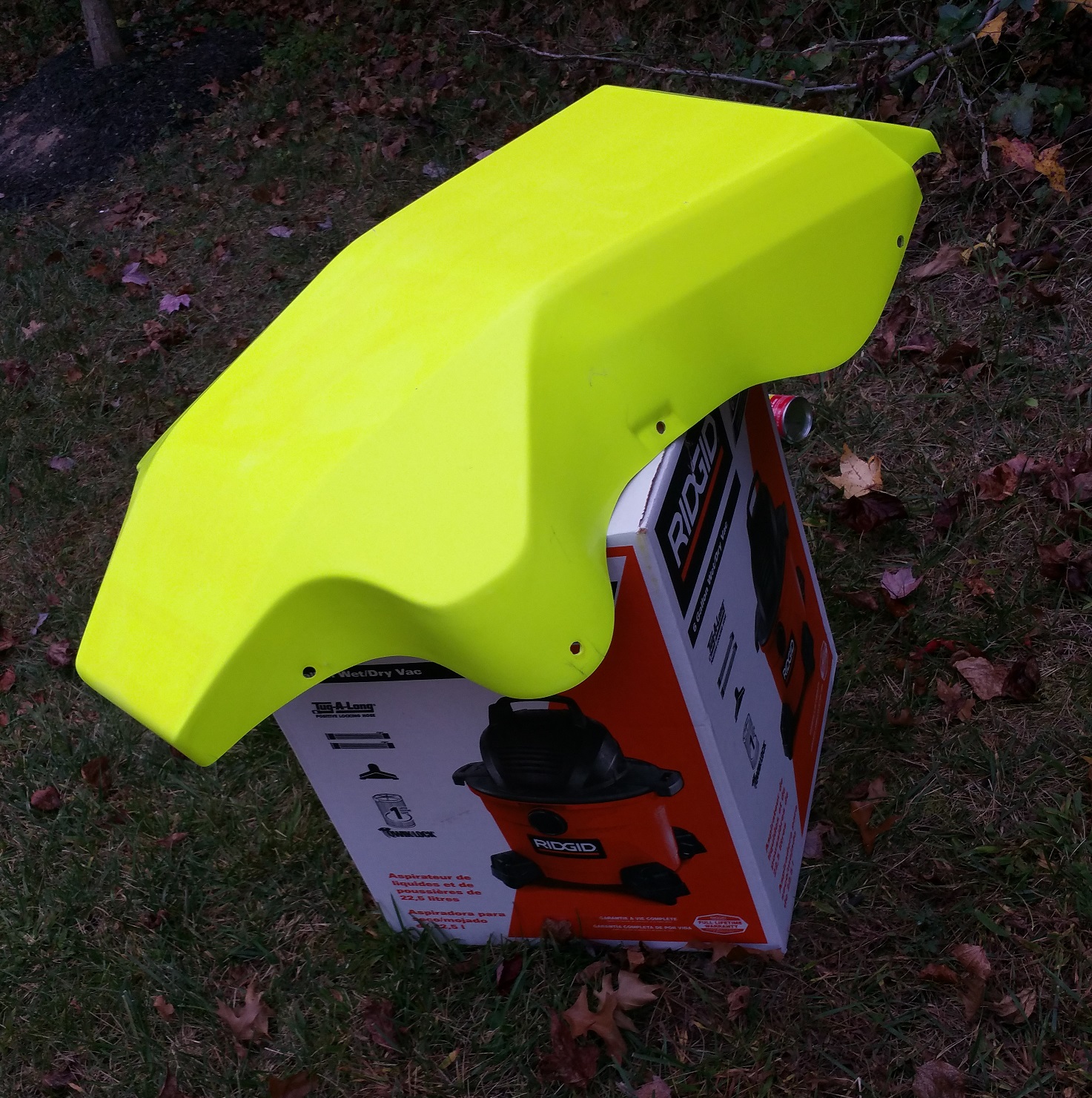

So then I decided to get started on the paint.   The lemon-lime yellow is getting covered. One of these were used as my guinea pig:
The are both scratched up and in rough shape.

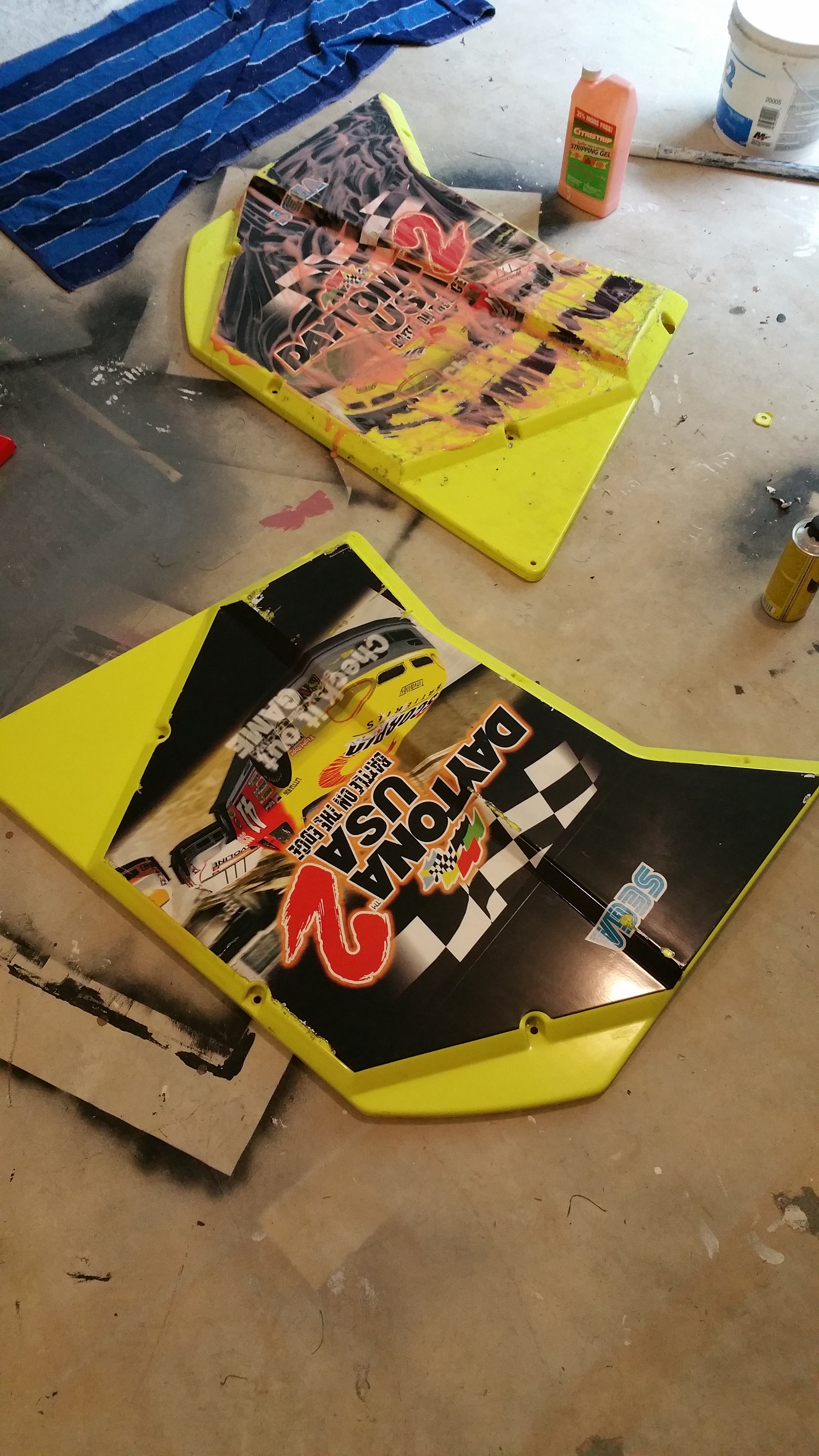

So I took the other one, thats actually WORSE than that one^ and prepped it for paint, and the results look promising!
I also removed all the decals you see on the seat in the previous pictures, and then prepped and painted it:

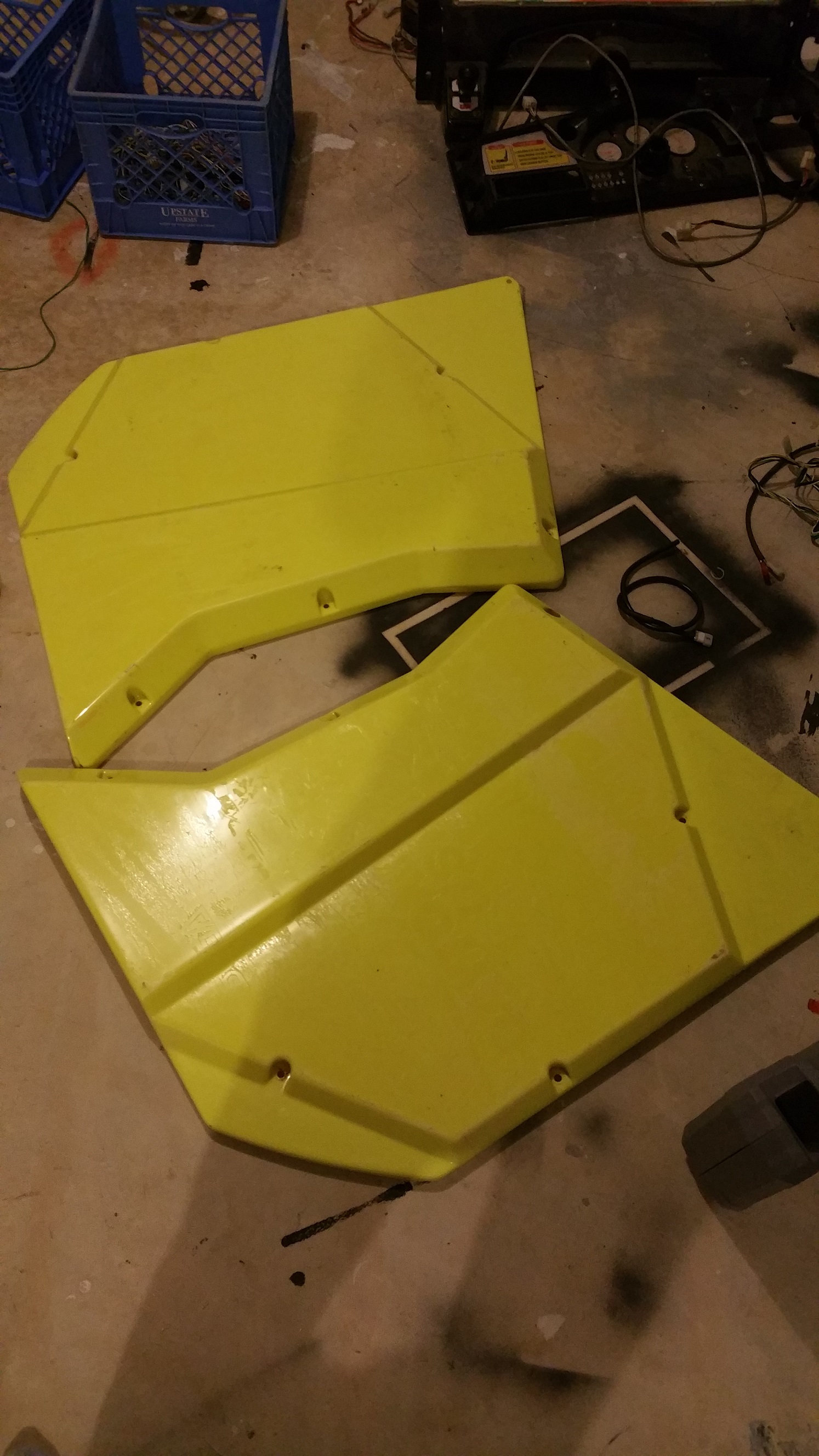

Last up is the sides. I only had time to strip the 2 sides and there is a TON of glue residue left over :(
you can actually see the word sega in adhesive on the bottom one. Will probably take a day or 2 to get it all off , then prep and paint the sides.

So the paint was just Rustoleum "2X Paint and Primer in 1" in Candy Red gloss.  2 coats with a 400 grit sand between and after, then a clear coat.
After many tries with many different chemicals, I gave up and sanded. 100 grit to bust up the rock solid adhesive, then 150 and 220 to smoother it all out.
Some JB Weld to hold the cracks together and fix some plastic. It smells terrible and almost made me sick.

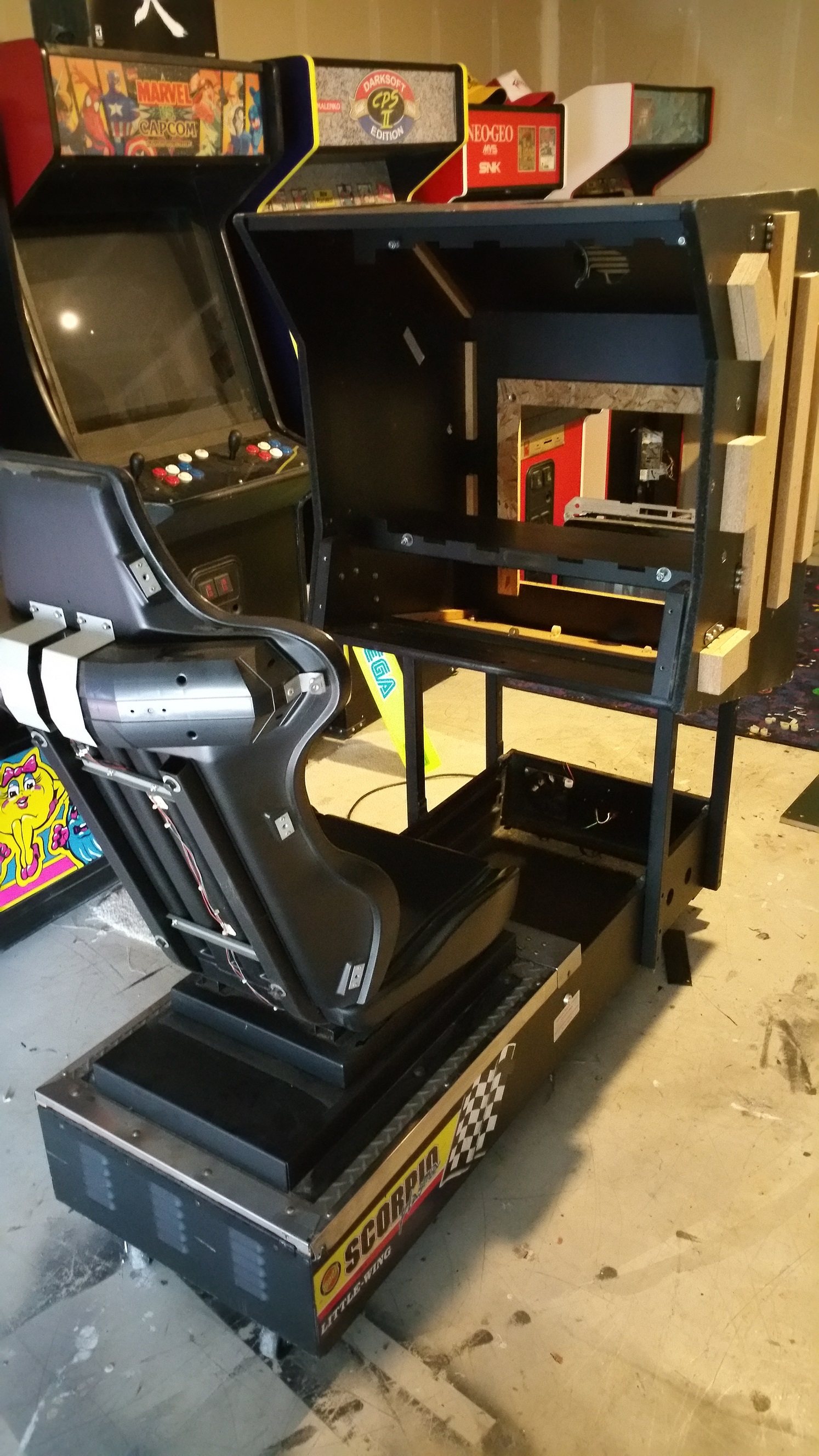

So I decided to go ahead and finish up the brackets for Cab 2.
This is like $200 worth of steel , no one had any for sale so fabrication it is!
No access to a shearer , so the "top plates" were cut with a band saw, they aren't 100% straight, but they are 99% straight and thats close enough for their purpose.
Here they are:
Dem welds.....
surface rust will be sanded off prior to painting
"test fit"
They are sitting there with no bolts or screws, everything lined up!

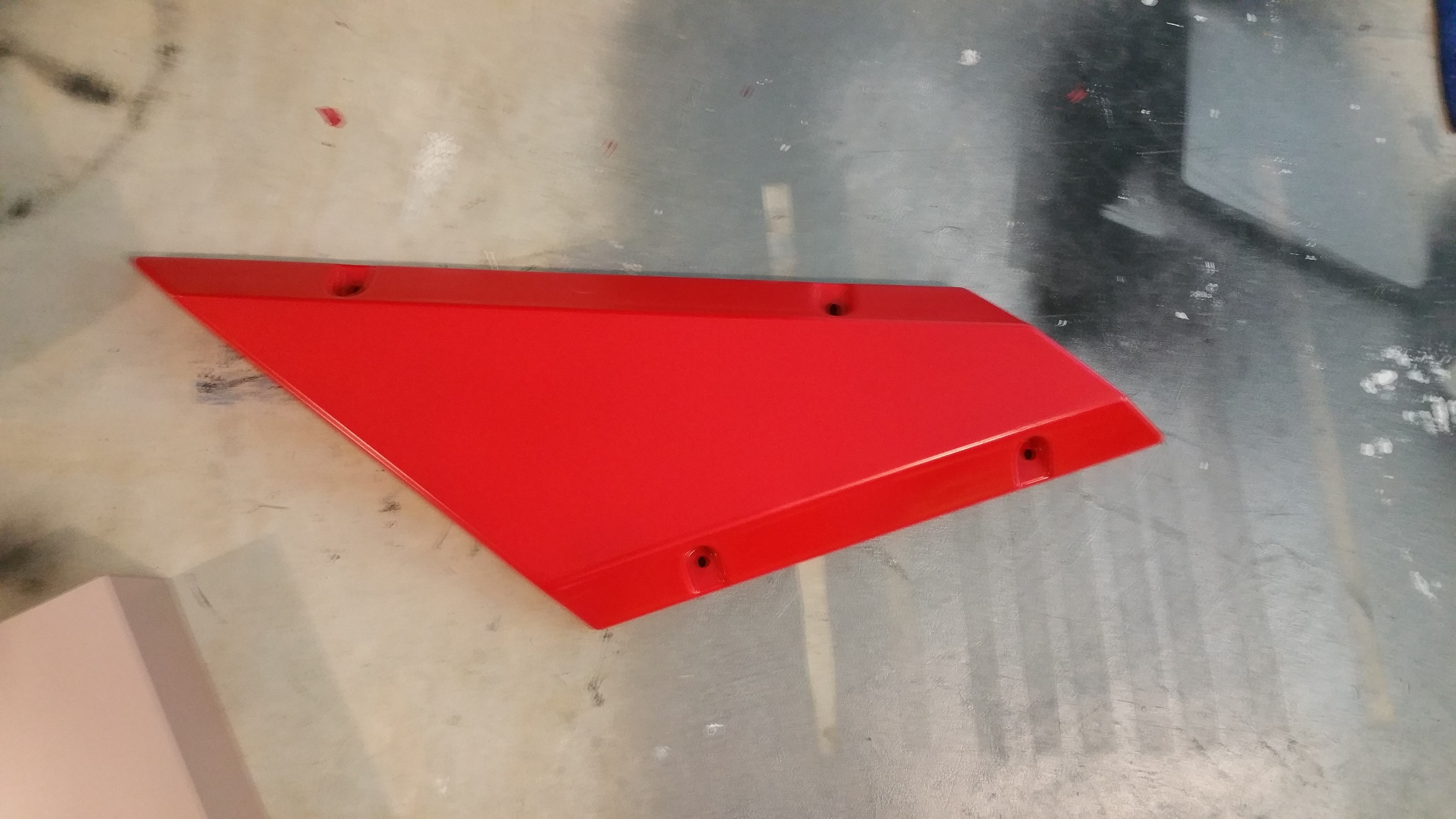

Taped off the sides and prepped for paint:
and painted
and tape peeled
put the plastic's batons on in position
and screwed them in
and here is how she sits now:
