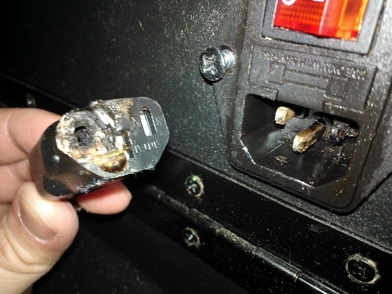

- When you don't touch the red lead to the black lead, you'll get the same open/infinite resistance reading ("1     ." in the video below) as you'll get on tabs 7 and 8 with the switch open.
-- No contact = no path for the current to flow from one lead to the other = open/infinite resistance reading.
- When you touch the red lead to the black lead, you'll get about the same reading as you'll get on tabs 7 and 8 with the switch closed.
-- The touching leads or closed switch will allow a path for current to flow and you'll get a resistance reading (ohms mode) or a beep (continuity mode).
I think your switch is oriented like the one in this video. (8  7  6)
The video shows less-than-perfect contact between the leads and switch, but if you make firm, steady contact you should get a reading of less than 2 ohms.
For all your power connections, you want a low-resistance connection to avoid generating heat like this.
This is why you always want clean, corrosion-free, mechanically-solid and low-resistance (<2 ohms) power connections.

One final check to make sure you won't have long-term heat problems:
- Unplug from the wall outlet
- Put the IEC switch to the "On" position
- Check resistance of the Hot, Neutral, and Ground lines from the wall outlet plug to the cab's power strip socket -- <2 ohms is good
The higher the resistance, the more heat the connection will generate and the more likely it will result in an electrical fire.
