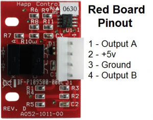

Do you have an optical encoder board that is just missing the USB cable? (not the "red board" shown below)
Groovy Game Gear has the Trackball Cable for Opti-Wiz™ "No-Solder" cable that connects the two optical "red boards" to an Opti-Wiz™ "No-Solder" optical encoder.

If you have an older IPac, you need an optical encoder board to translate the raw "red board" quadrature waveform output into mouse movements.
This quadrature waveform shows what you would see on the data lines (A and B) when you slowly turn the axis clockwise.
You can't connect a "red board" directly to a USB cable -- there has to be an optical (mouse) encoder board.

Not sure what you mean though by 'red boards'.
Most Happ trackballs come with these optical boards -- also seen in the first picture in this thread.   ;D
