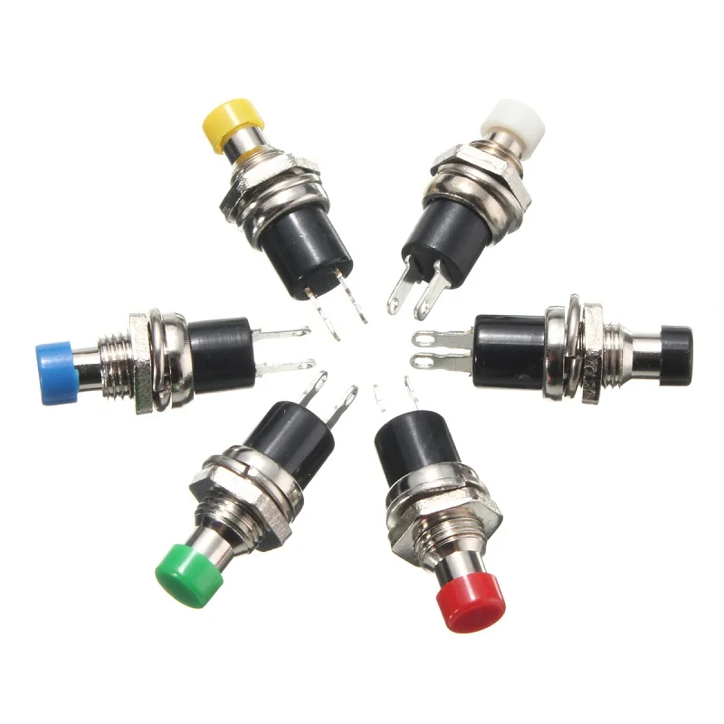

« Reply #3 on: February 28, 2017, 12:58:47 am »
i'd be interested in some good answers on this subject, as in the past i used the ones like in the pic below.  bad idea.. they suck, and eventually hurt your fingers!  (in my opinion they would only be good for something where u very rarely have to press it).

« Reply #5 on: February 28, 2017, 02:09:35 pm »
I use 1 of these as a "shift" button.... they do kinda suck. But they are small and easily hide-able and the stiffness makes it less prone to accidental pressing(mounted behind volume knob).
