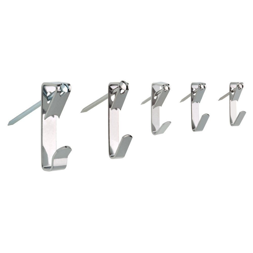

The other problem is that the joystick shaft can still spin freely.  As said previously, I am trying to make this an easy mod, so I don't want people to have to drill a hole through the joystick shaft.  Hopefully it won't come to that.  The only keyed thing on the original joystick shaft though is the 1mm notch in the bottom for tightening the balltop.  The rotary switch also has a 1mm slot. I can't imagine a 1mm bump of plastic holding up very long.  I didn't think a metal key that small would either, but then I tried the side of a large picture hanging hook and it felt pretty solid.
I figure these are easy to find and most people have dremels, so people could cut their own key out of them.  I might have to find something larger, but it will still be something readily available.
