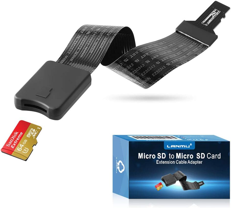

« Reply #819 on: July 29, 2020, 10:11:21 pm »
Ah, so it is using one of those SD cables with the screw mounts.  Glad I didn’t order one just yet, though i suspect if you crack open the plastic case found on some of them, you find the screw mount version inside.
The guy that posted the model on Thingiverse described the extender he used as "a 25cm one" -- no links or pics.   ::)
The screw holes in the base align with screw holes in the edges of the cover. (34mm center-to-center)
The hollow under the cover is 30mm wide x 37mm deep x 4mm tall.
I have an SD card extender like the pic below, but the plastic case makes it too tall to work with the cover.   :banghead:
- Looks like the cover was designed for a low-profile regular-size SD card holder.
- Not sure if he used something like this one that has no case or decased one like mine.   :dunno
If you can't find an extender that works with the cover dimensions listed above, it shouldn't be too hard to make a custom cover.
  • Posts: 19445
Re: So ... 3d Printers....
« Reply #820 on: July 29, 2020, 11:28:05 pm »
I'm pretty sure on the dreamcast versions of these prints you take the cover off the extender but I'm not 100% sure.

« Reply #821 on: August 03, 2020, 05:37:23 pm »
Since the SD card extender I mentioned above is too big to fit without decasing, here's a cover for MicroSD card extenders like this one (7.5") or this one. (19")
The .zip file contains the STL file and the OpenSCAD, DXF, logo image, and Inkscape files along with directions on how to vectorize a logo for OpenSCAD if you want to customize yours.
The OpenSCAD file is fully commented and parametric so you can easily customize the cover by changing the associated variable(s) -- no programming ability needed.   ;D
Print the cover with the small, flat back side down with no supports. (i.e. rotate -90 degrees on the X-axis.)
This cover is about 3mm taller than the original, but it should still fit inside with the CD lid closed.

// Extender case
    hull() {
        translate([CaseX/2 - CornerDia/2, -CoverY + CaseY  - CornerDia/2 - CaseOffset, CaseZ/2])
        cylinder (CaseZ + 0.01, d = CornerDia, center=true); // Back right corner
        translate([CaseX/2 - CornerDia/2, -CoverY + CornerDia/2 - CaseOffset, CaseZ/2])
        cylinder (CaseZ + 0.01, d = CornerDia, center=true); // Front right corner
        translate([-CaseX/2 + CornerDia/2, -CoverY + CornerDia/2 - CaseOffset, CaseZ/2])
        cylinder (CaseZ + 0.01, d = CornerDia, center=true); // Front left corner
        translate([-CaseX/2 + CornerDia/2, -CoverY + CaseY  - CornerDia/2 - CaseOffset, CaseZ/2])
        cylinder (CaseZ + 0.01, d = CornerDia, center=true); // Back left corner
    } // End extender case
// Ribbon cable space
    translate ([0, -CoverY + CaseY + RibbonDepth/2 - CaseOffset - 0.1, CaseZ/2])
    cube ([RibbonWidth, RibbonDepth, CaseZ + 0.01], center=true);
// Front curve
        translate([0, -CoverY - CurveOffset/2, CoverZ/2])
        cylinder (CoverZ + 0.1, d = CurveDia, center=true);
} // End difference

Had to take a soldering iron and hobby knife to it, but got it mounted.  Holes were a little too tight, and there’s some alignment pegs on the case that were blocking it.  I think the original author snapped his off or maybe his console revision didn’t have them.  So I melted out a notch and waved the shaft around in the holes to widen them and good to go.  I tacked it to the case with a few drops of hot glue, and used two tall mounting posts in the back and two short ones up front.  Used 2 8mm M3 screws to hold the SD card cable housing to the plate.
You have to twist the SD cable to get it turned the right way internally but no big deal.
Looks great and will protect my internals and keeps my hands off the Fenrir.
Thanks, PL1.

Glad to assist and glad to see that the taller cover still fits under the CD lid.   :cheers:
If anyone printing their own has this problem, LMK how much larger the holes need to be and measurements for where and how big to make the alignment notch.
I'll update the OpenSCAD code here with easy-to-adjust variables for modifying the original base.   ;D

I started out with good intentions and my drill press, but I was afraid I was going to blow out the edges of 3 of the holes so I went to the soldering iron.  I’d make the holes bigger and expand them inward.  It’s not much.  I have no idea how you’re supposed to put it all back together without securing the insert to the top case first.  Probably just a little masking tape would have been fine as it’s really clamped in tight once the case is screwed together.
It'll be easy to reverse engineer the current X/Y position and size for the four mount holes -- then anyone can adjust those variables as needed, render, and export as an STL file.   ;D
I can guesstimate, but the three measurements I'd need to make the notch accurately are:
  1. The X-axis distance from the right edge of the base to the right edge of the notch.
  2. The X-axis width of the notch.
  3. The Y-axis depth of the notch.
