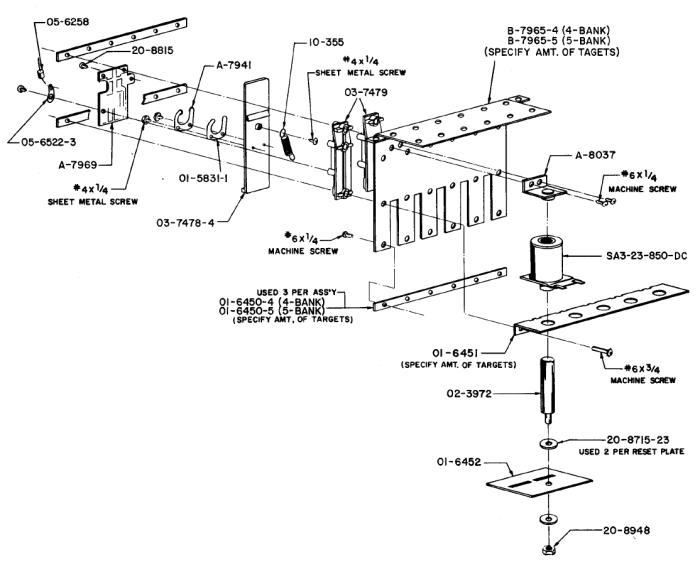

Not-so-good news: No luck getting readings from the photos to match up with thread-size charts.   :banghead:
Good news: Found a diagram for the Williams D-7931-5S drop target assembly on Marco Specialties showing that the machine screw is #6 x 3/4".   ;D
Mixed news: The PCB screws are labeled as P/N 20-8815 in the diagram below and P/N 20A-8815 in another version of the diagram.
The horseshoe screws are sheet metal #4 x 1/4".
Question for PBJ: Are the PCB screw threads the same diameter and pitch as the horseshoe screw threads?
Anyone know where this diagram came from?
Haven't found any manuals with a similar parts breakdown.
Found it.   ;D
Planetary Pinball has online copies of Bally and Williams parts catalogs, including Williams 1980.
Drop target assemblies are on pages 113-118 -- they all use the 03-7479 guide.
The D-8362 assembly diagram on page 116 shows PCB screws that are the same P/N as the horseshoe screws. (4104-1001-06)
EDIT: Working printable version of this Wiliams Drop Target Guide posted here.
