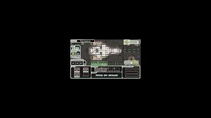

@Calamity Any idea why most games display the artwork just fine but Donkey Kong struggles to fill the screen? It's not a big deal but I'd like to use the full artwork and full screen if possible :)

I'm not sure if I understand the issue. The option artwork_crop in GM is used to ensure that the native resolution of the game if preserved, even if this means cropping the artwork. If this is not what you want, then try disabling artwork_crop for dkong.

The issue is that the game + artwork (like bezels) stretches to the whole screen (well, vertically at least) in MAME while it's kinda "zoomed out" in GroovyMAME (like when you select integer scaling in others emus and the image sits small in the center). I'll try to make a screenshot later (but it basically looks like this). Does dkong + any of Mr. Do's artworks work fine for you? If you wanna test it for yourself, set artwork_crop to 0 of course.

Hi Anuskuss. I don't use artwork here. Probably GM is using integer scaling for the game + artwork combination. Usually integer scaling is disabled when the resulting borders are too big. The reason why it's not happening there is imposible to guess without a log. You can always force fractional scaling by forcing -unevenstretch in a specific game ini.

You're right, even though unevenstretch is set to 1 in my config (unevenstretchx and unevenstretchy don't preserve the aspect ratio), it only works by forcing -unevenstretch via command line. That's gotta be a bug in GroovyMAME, right? Using the identical config does work in MAME.
Looking at the log, SwitchRes sets these:
Code: [Select]
-rotate -noror -noautoror -norol -noautorol -keepaspect -nounevenstretch -nounevenstretchx -noblack_frame_insertion -syncrefresh -notriplebuffer -waitvsync -nofilter
It would be nice if one could deactivate SwitchRes entirely. I only use GroovyMAME for D3D9ex and frame_delay because I have no use for SwitchRes (on my LCD anyway).
No. Groovy has some settings that take priority above MAME.INI. I can't find a link to the priority order at the moment but you are able to override it without needing to change your commandline.

Anuskuss,
Create a blank file called raster.ini, then place unevenstretch 1 in it (only that).
Switchres takes priority over mame.ini, but every other ini has priority over Switchres.

@Calamity Okay, I think I understand it now. From this line
Code: [Select]
rng(0): 1920 x1080_60.000000p 0.000000 [integ] scale(5, 4, 1) diff(3.70, 5.19, -0.6061) ratio(8.571, 4.219)it seems that GM prefers integer scaling but only if the margin is small enough (in my case 5.19%). So now it enabled integer scaling but by using the artwork the output suddenly grows too big so it has to go from 4x to 3x. There's probably no way to know beforehand how big the output (game+artwork) is gonna be or to change the screen mid-game (e.g. when toggling the artwork) so I'm just gonna stick to the workaround. Thank you for your help!
