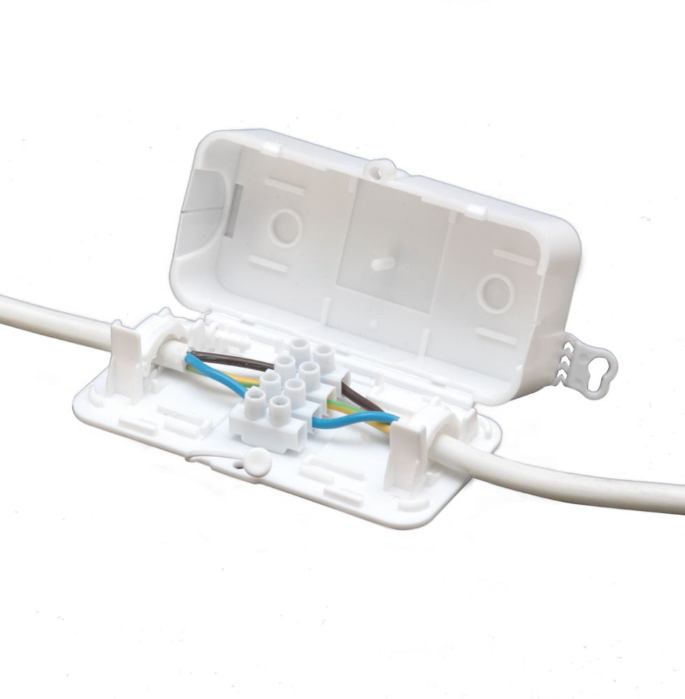

Is there room for a couple inline connector boxes inside the unit ?

That looks like exactly what I would need. I will investigate those further.

Yes, that guide is fine if you're planning on only using other controllers besides the ones that came with it.  The connector on the actual controller PCB is a JST SJN, and the only way to remove that is desoldering.
I plan on putting a standard female JST socket on the PCB and JST male connector on the actual controller connector.  Which is the arrangement that cable has inside the actual console.  Frankly, that's probably how it should have come from the factory, but Nintendo shaved a couple cents off the manufacturing.
Other option is a splice at the console end of that controller cable, but then you have an unsightly splice in the middle of the cord.
