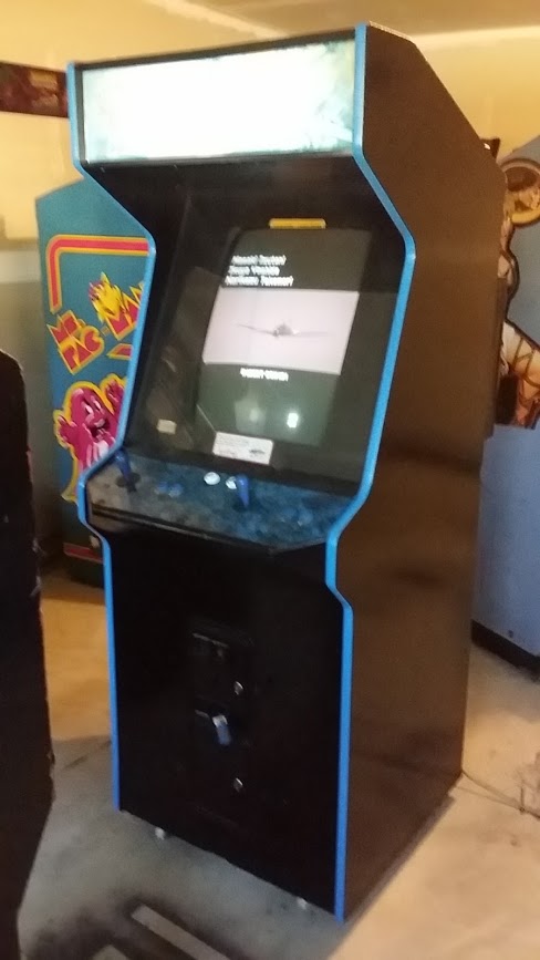

Picked up a faux Dynamo HS5 cab when I got my real HS5 cab. Couldn't find any manufacturer labels or anything of that ilk, but it has a real Dynamo HS-5 control panel along with a pull out drawer (that uses latches to secure instead of just gate slides). other major difference is the lack of the "box" on the bottom yet its still the same height as an HS5.
Here's how I got it (the soul edge cab in the back is now my Multi CPS2)
First thing I did was remove the clown car sized caster wheels off the bottom.
It's currently set to vertical orientation and has Strikers 1945 in it.
Has a pretty gnarly monitor bracket:
All I've really gotten done so far is start to patch the front , it looked like someone ran over gravel with a lawn mower and shot the rocks at the front.
And I started stripping the control panel, that blue camo has to go.
Never found pennies under a dust washer before:
depopulated:
Either the holes weren't punched right, or this is a bad bootlegged art:
