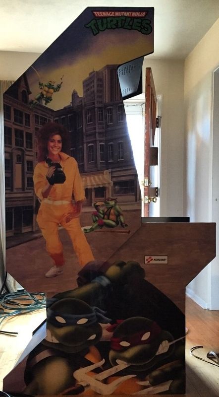

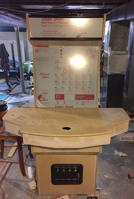

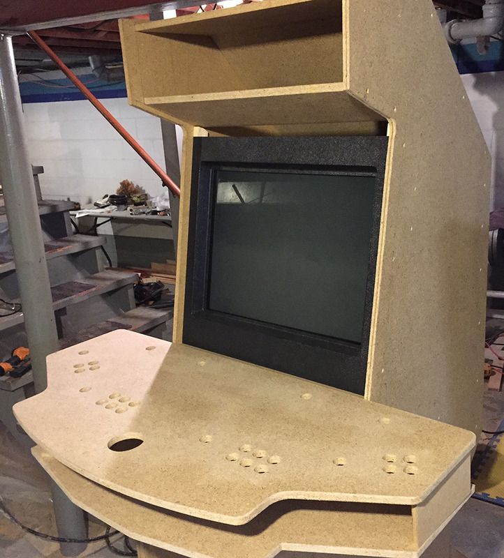

Hey guys.  I am far enough along now that I feel like I can post.  I've been working on this for maybe a year now but recently have had time to really get some things done.  I wanted to recreate the original TMNT Cabinet but update it a little in the style of the UAII cab.  The control panel is a design I worked up from reading all the great feedback from this forum.
All that is really left is to finish the painting, wire the control panel and apply the artwork.

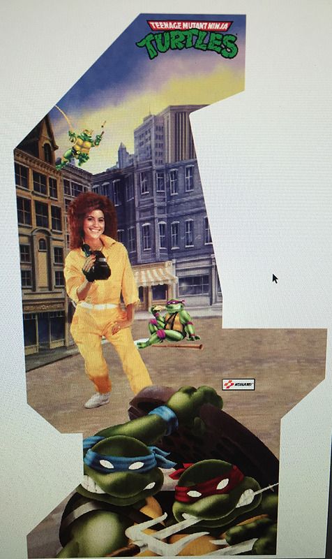

I have sent to art off to print.  I took the original artwork for the side and control panel and modified it. I spent hours in photoshop filling in all the original button holes and what not so that I would have a clean slate for my own sides and control panel.

This is using a 27" Sony CRT

Did April O'Neill always have a broken leg in that picture? I may have never noticed that as a kid.
I always LOVED the art style of the Turtles on this cab, though.
Your work looks great, and I love how the back opens!
Sent from my Atari 2600
I never noticed her leg either!  She is definitely in a weird stance.  It's probably because I was always fixated on her sexy 80's hair.

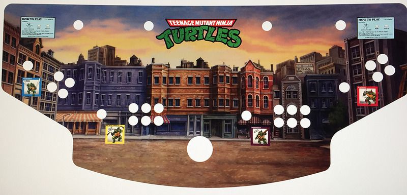

Well I realized I screwed up on my control panel after I already got it all mounted and buttons installed.  I followed the original control panel design.
Original from Left to Right is as follows
P1    P2        P3      P4
Leo  Mikey   Don    Raph
Since I followed the original control panel design my button colors associated with correct turtle are all messed up except for Raph because from left to right I have
P3    P1        P2      P4
Leo  Mikey   Don    Ralph
I did this so P1 and P2 were the center most players to the monitor.  I didn't think about switching the graphics around to compensate for this change.
This is only a factor when you are playing the actual Turtles game.  I can't decide if it bothers me enough to reprint the control panel.
« Last Edit: February 08, 2016, 03:32:35 pm by dheck »
  • Posts: 9795
  • Last login:Yesterday at 09:05:24 pm
Re: UAII Style TMNT 4 Player Cabinet
« Reply #5 on: February 08, 2016, 04:47:11 pm »
Just remap the controls for P1-P3 in MAME and you're good to go.   ;D

I did not even think of that!  Clearly I do not have a lot of experience with MAME just yet.  You just saved me a lot of heartache!
