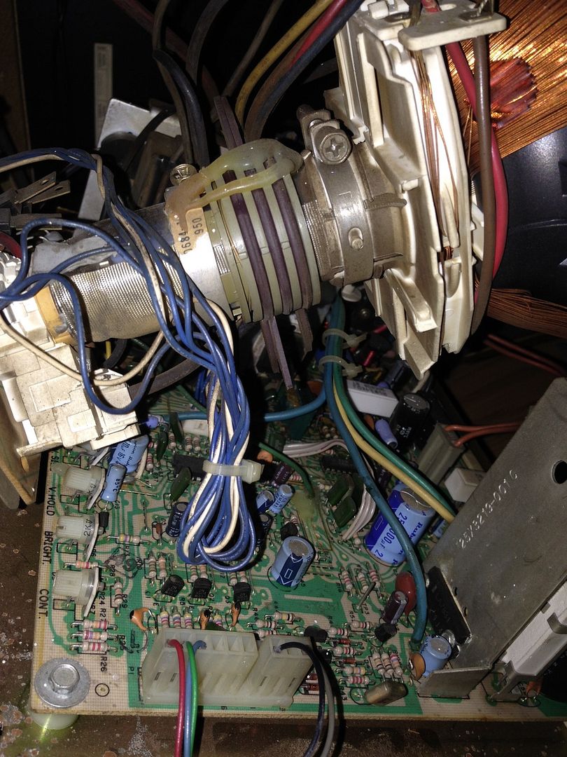

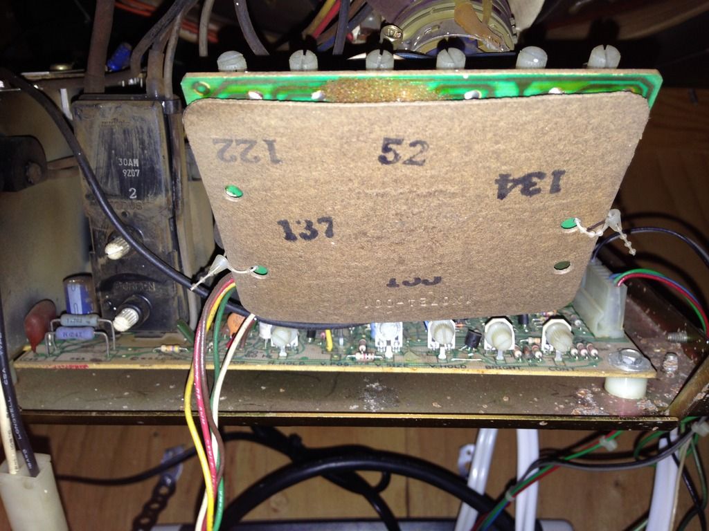

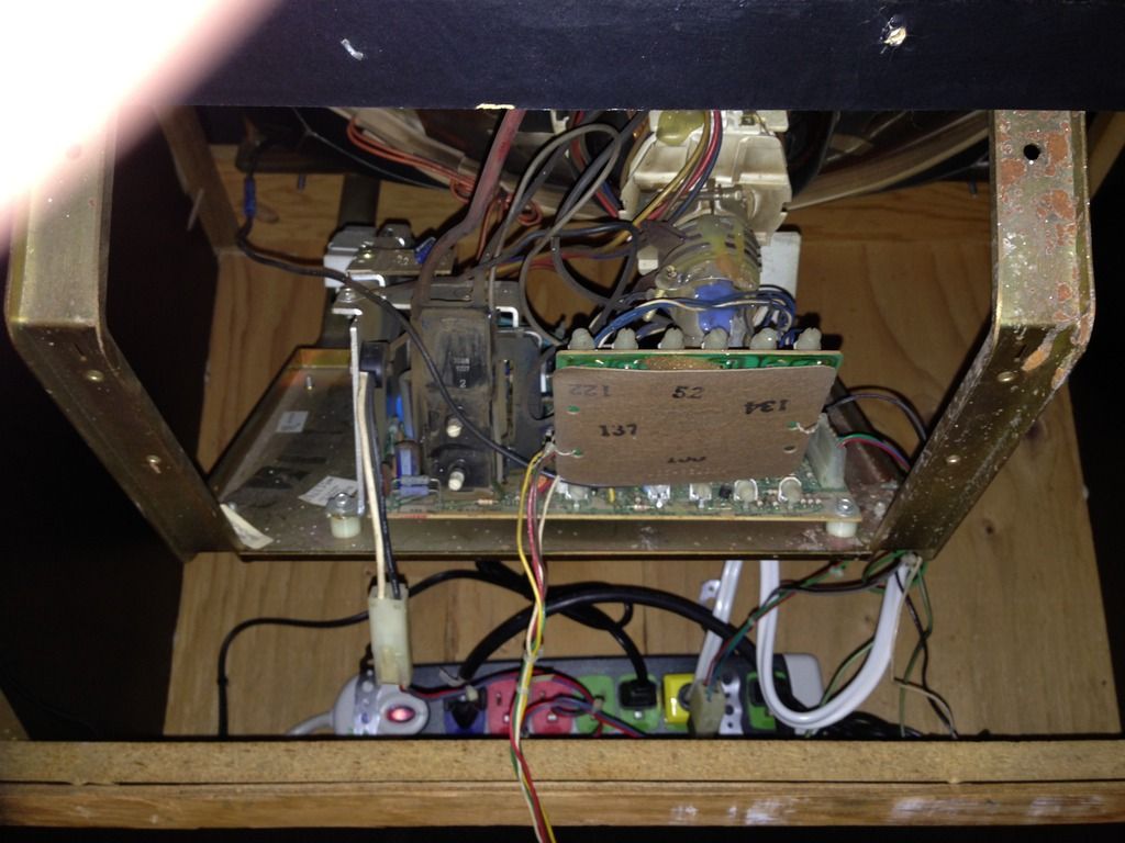

I've been having a heck of a time trying to get a picture to fit entirely on the screen, seems like the picture is cut off vertically and horizontally and no matter which knobs I turn on the chassis or on the pigtailed board, nothing brings the picture in.
I also have no clue what chassis I have.  I know it is a WG judging from the serial number sticker but I cannot find any other identifying stickers anywhere, I even pulled it right out to check.  I took some pictures in the hopes that somebody can identify it and hopefully give me some pointers on the scanning adjustments.

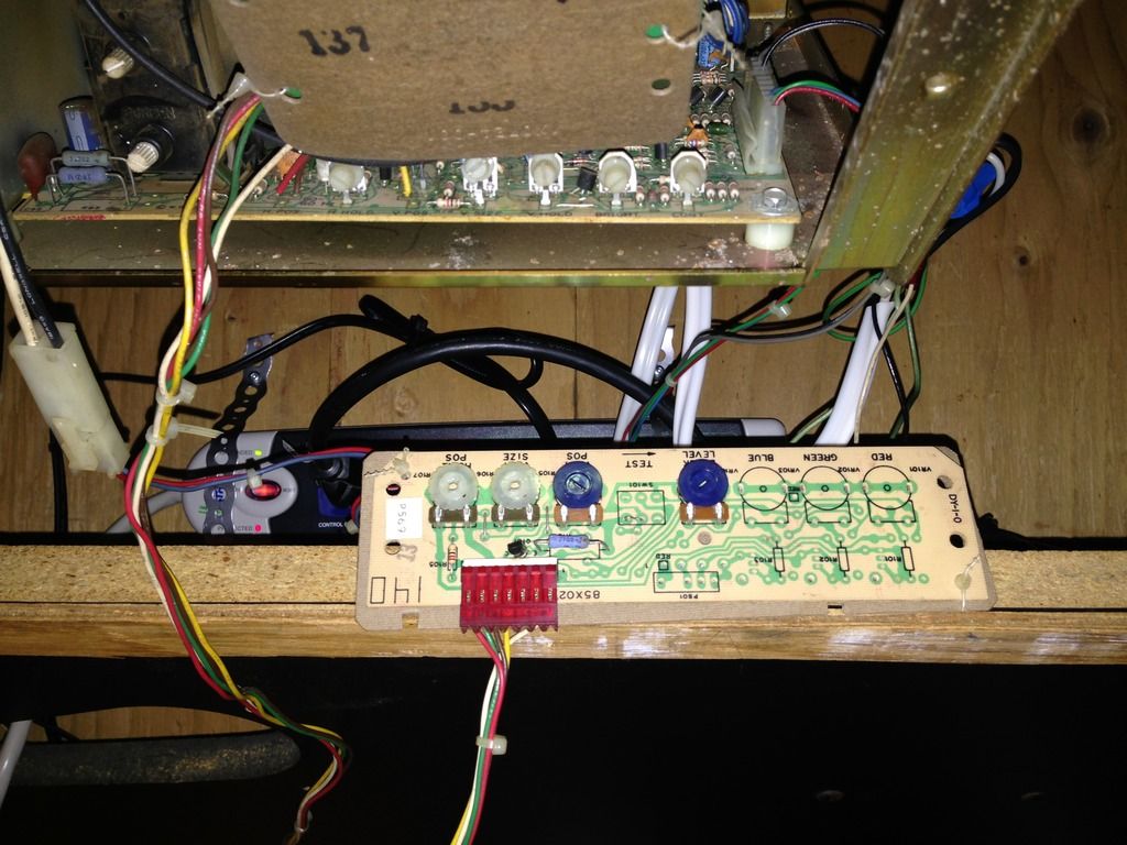

Edit - the knobs on the loose board are "black level - vert pos - vert size - horiz pos"

Do the size adjustments do anything to the image? The first thing I would do is cap the monitor. Once you cap it see how things look and take it from there.

Looks like a k7000. Grab a cap kit for sure. There is also quite a bit of reference out there for those flybacks with the white knobs. I would probably go ahead and replace that too while you have the chassis out.
http://www.therealbobroberts.net/k7000.gif

Choose a resolution with max 256 lines vertical. If that solves the problem great. Otherwise there's a pot that can be adjusted that may help. I can send a pic if you need it.
