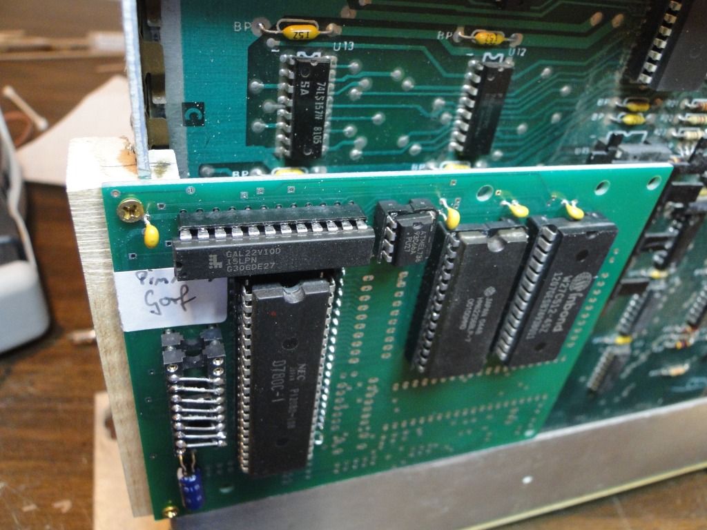

The kit is a daughter board that plugs into the Z80 processor socket.  The Z80 then goes into a socket on the daughter board and the ROM board is removed from the rack because the ROM now resides on the daughter board.  There are software DIP switches included that take over for the DIP switches on the CPU board.

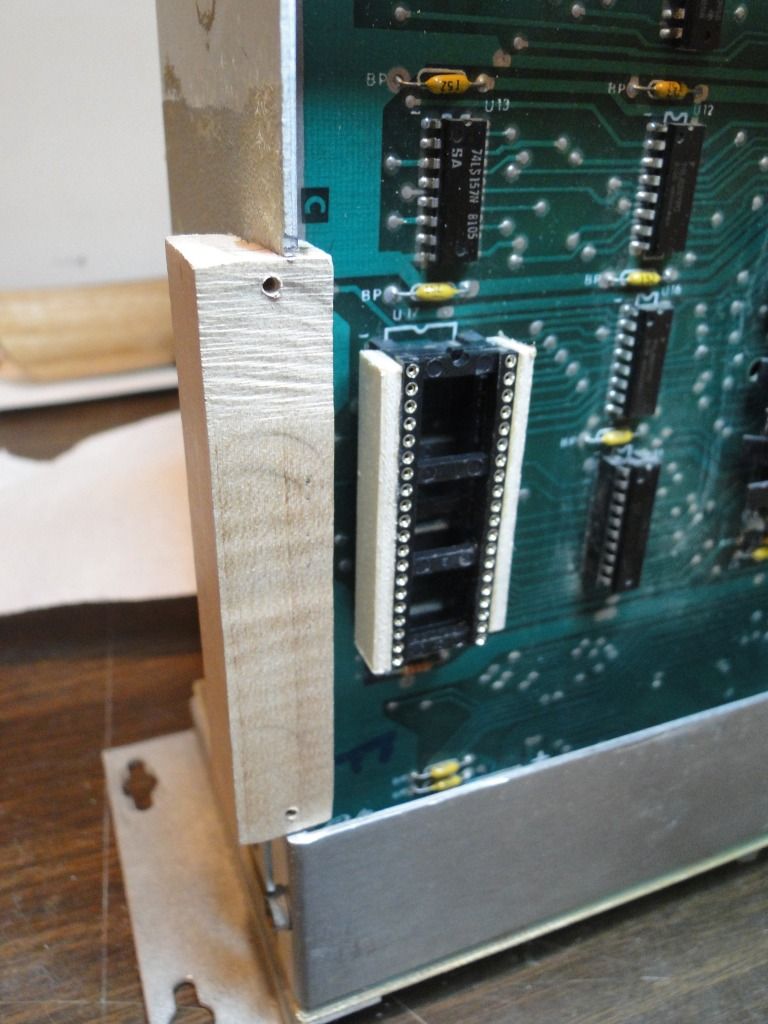

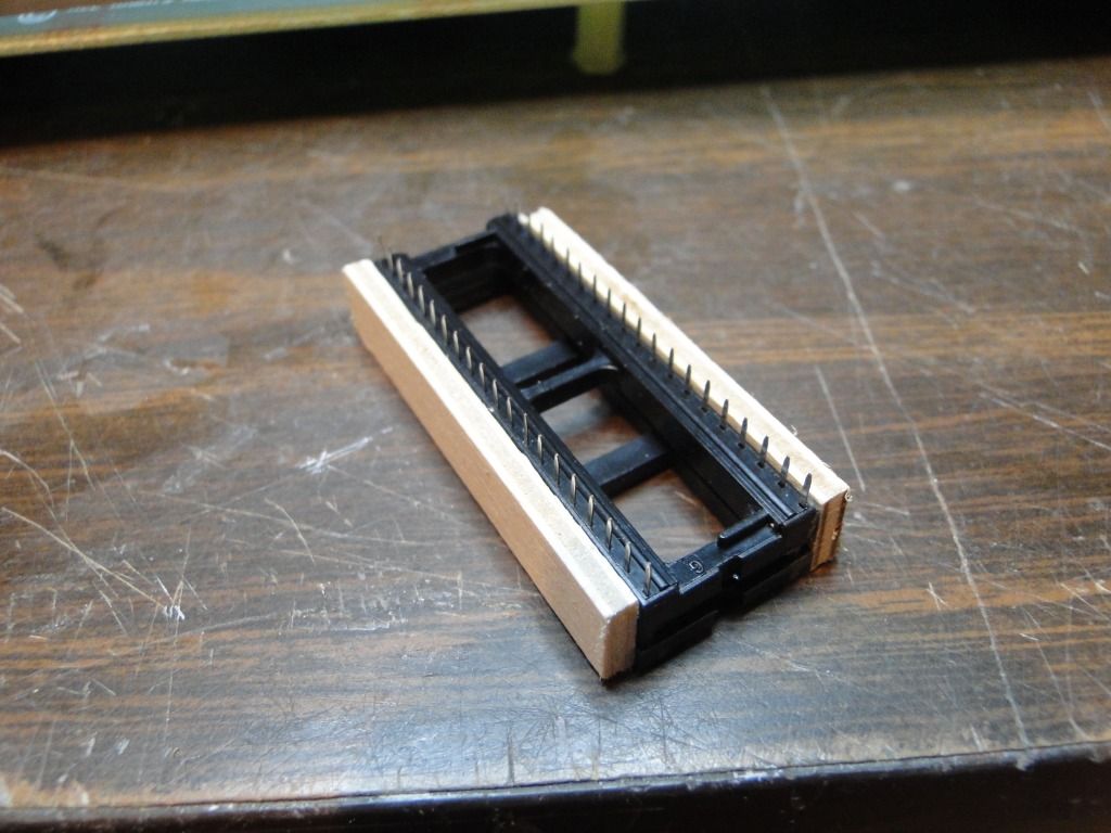

Because the Gorf game uses a Bally rack system, there are several standoffs included to get the board far enough away from the rack to prevent shorting of pins in the metal rack.  The pins on the Z80 are standard thin chip pins but the pins on the standoffs are larger and round.  This prevents the pins from seating well in the socket and makes the board very prone to disengaging (I couldn't achieve good continuity without a fair amount of pressure on the sockets).
I solved this by buying an 40 pin socket from Radio Shack and I used a couple of pieces of wood to permanently glue the round pin socket into the Radio Shack Socket so that there was good continuity between the socket pins.
This socket fits snuggly and securely to the Gorf board.  I also added a wooden standoff to the edge of the rack to allow me to screw the daughter board to the rack so that I am sure that it doesn't disengage should the rack get jostled.
The high score board now can be secured to the cage.
