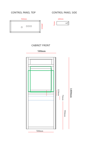

This project is going to be a wooden scratch built Japanese style candy cabinet. The design is influenced by a number of projects seen on here (mostly mako72's build) and a Sega Naomi sit-down cabinet.
I have never built anything from wood before (or any other material for that matter!) so hopefully this project will serve as some inspiration for people who have been putting off an arcade build because they think they're lacking the know-how.
I've got a circular saw and a small workbench, so this will be an exercise in construction with the minimum tools required!

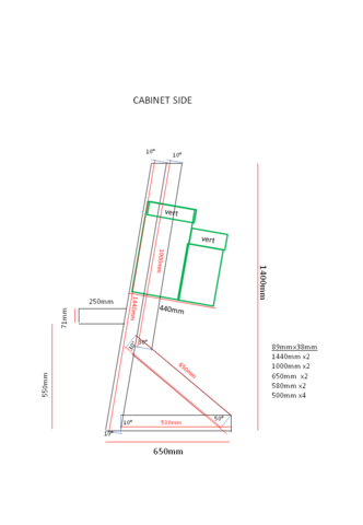

I did the plans fairly roughly using PowerPoint to work out the lengths and angles etc.
The plan is to use a 21" PC CRT monitor and use a Sega Dreamcast as the brain of the cabinet. I'm also going to make the monitor rotatable by mounting it on a square sheet of MDF that can be turned as needed.
The main focus of the cabinet is for shmups, so it will probably have a 3 or 6 button single player setup. Although I am also considering a 2 or 3 button two player layout.
Will update with build pics soon!

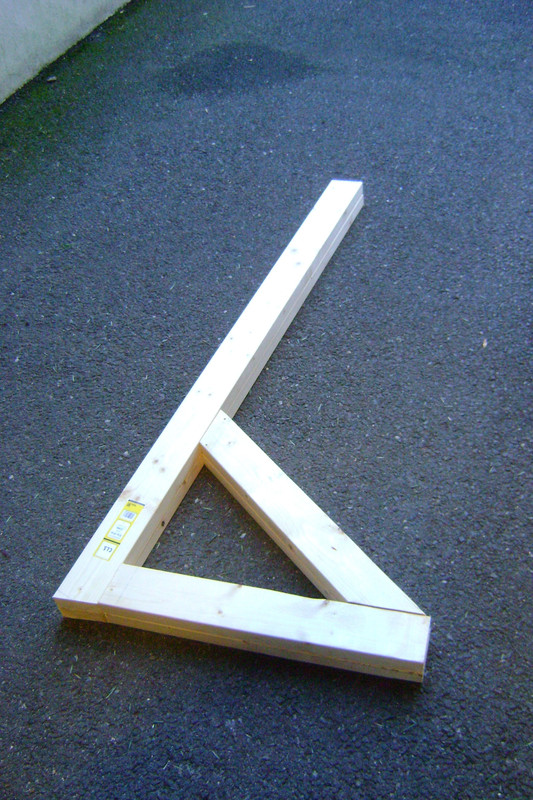

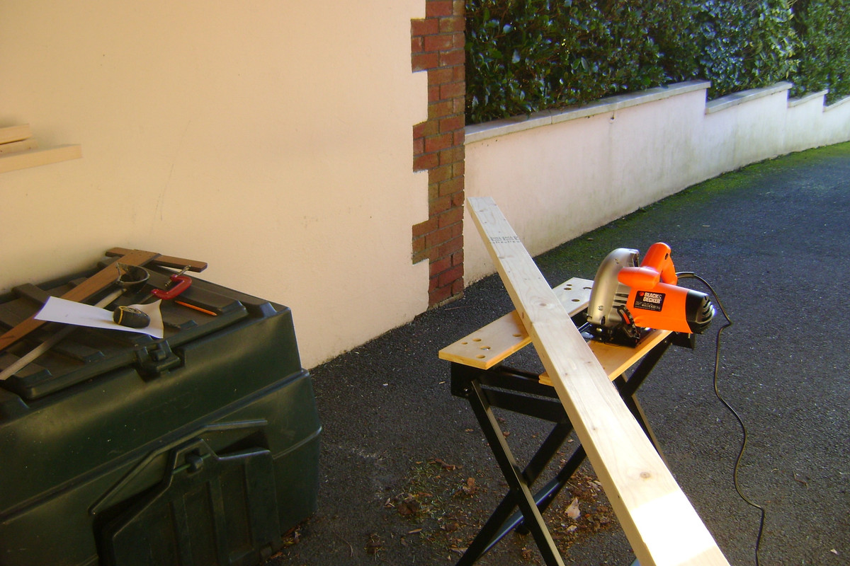

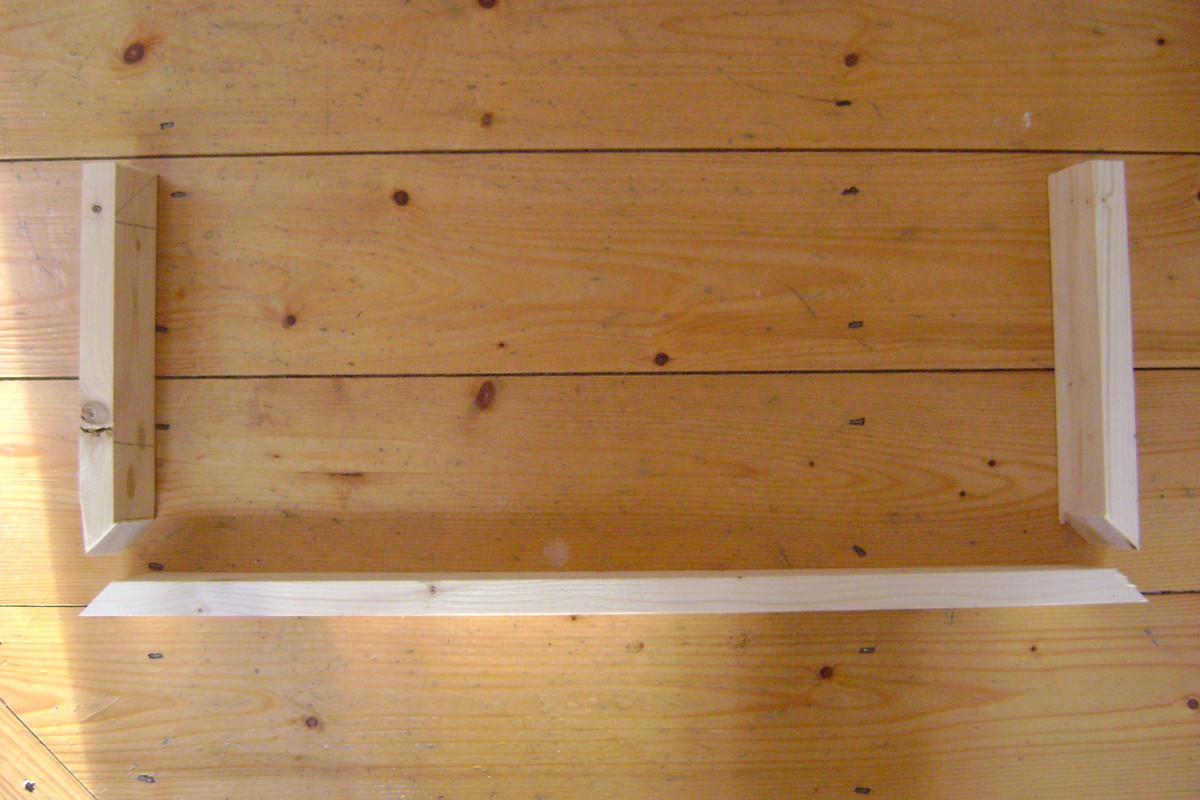

Getting ready to cut the frame:
All pieces for both sides of the frame cut. They seem to all line up nicely. That took a lot more effort than it looks like!  :laugh:
Next is cutting the middle pieces and assembling the frame together!
« Last Edit: April 30, 2020, 02:32:53 pm by Don »

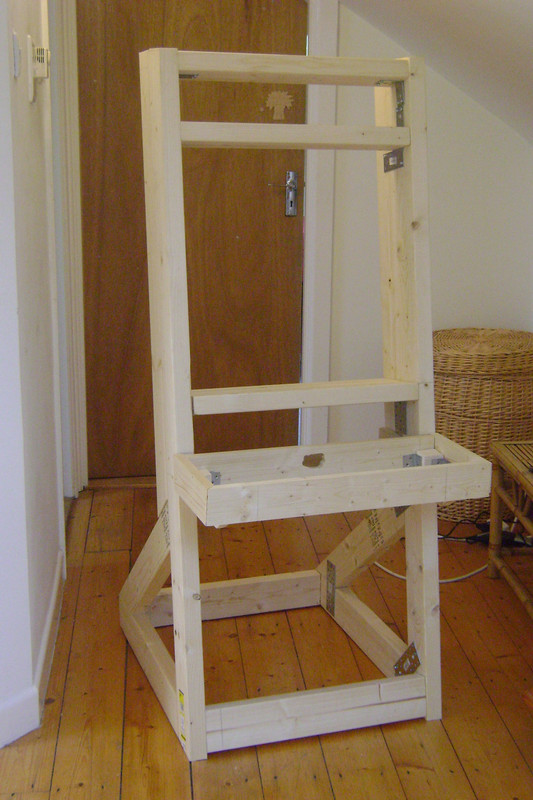

As I didn't have a 'speed square' or protractor, in order to get the angles for the frame I printed out an of image the angles I needed and then cut them onto card:
Here are the two sides of the frame and all the middle pieces cut:
And the frame assembled!
« Last Edit: February 13, 2017, 01:24:56 pm by Don »

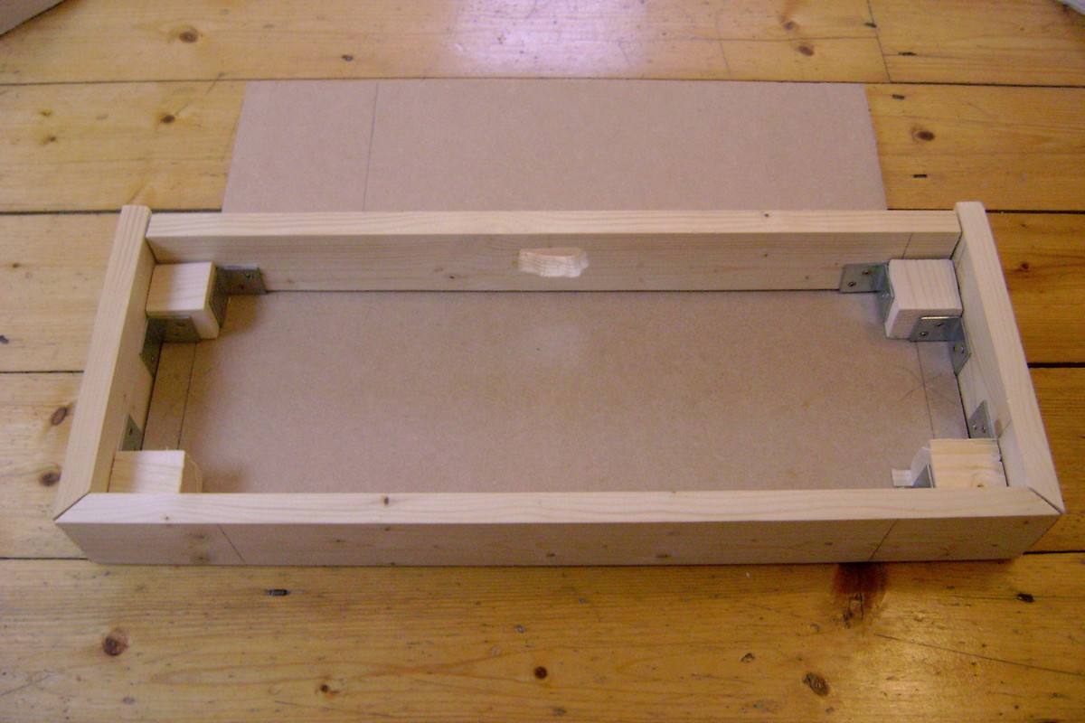

Got some work done on the control panel
Side pieces cut:
And the whole thing put together:

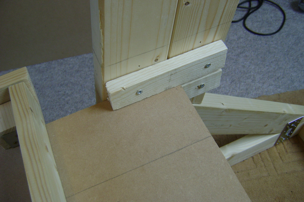

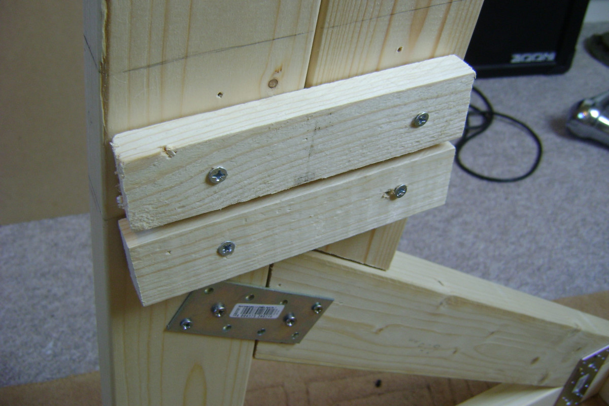

To attach the control panel to the cabinet I attached two pieces on either side for the panel to slide into. This seems to work pretty well, and I will add locks to the sides to keep it from being pulled out during play:
I also attached the monitor and speaker shelves and added extra support pieces on either side of the frame. It's beginning to look like something now!

Looking good, nice cuts.  All of your joints should have wood glue and you need more than just 2 screws in those plates at butt joints (which is most of your joints).  It may feel sturdy today, but it'll wobble and loosen up during use if you don't use glue and more screws in the plates.
Don
  • Posts: 106
  • Last login:March 26, 2024, 04:39:03 pm
Re: Mini Candy Cabinet Scratch Build [First Project]
« Reply #9 on: January 28, 2016, 11:49:25 am »
Thanks. I've been adding more screws now that it's all assembled, but I had overlooked wood glue! Will start adding it at the joints.

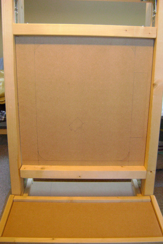

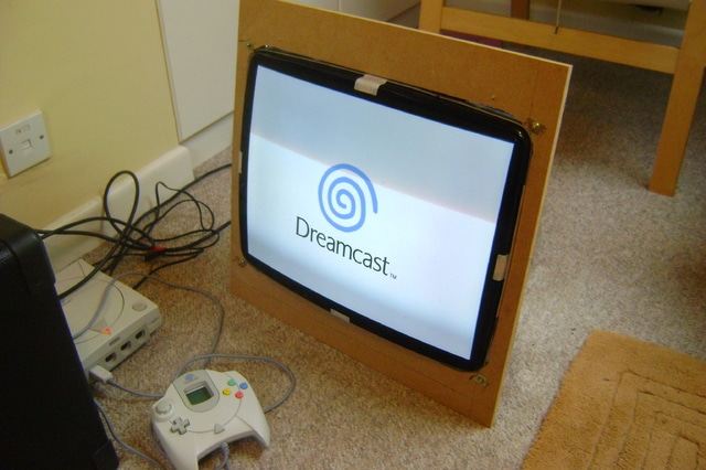

After a fairly long delay, got back to working on this recently.

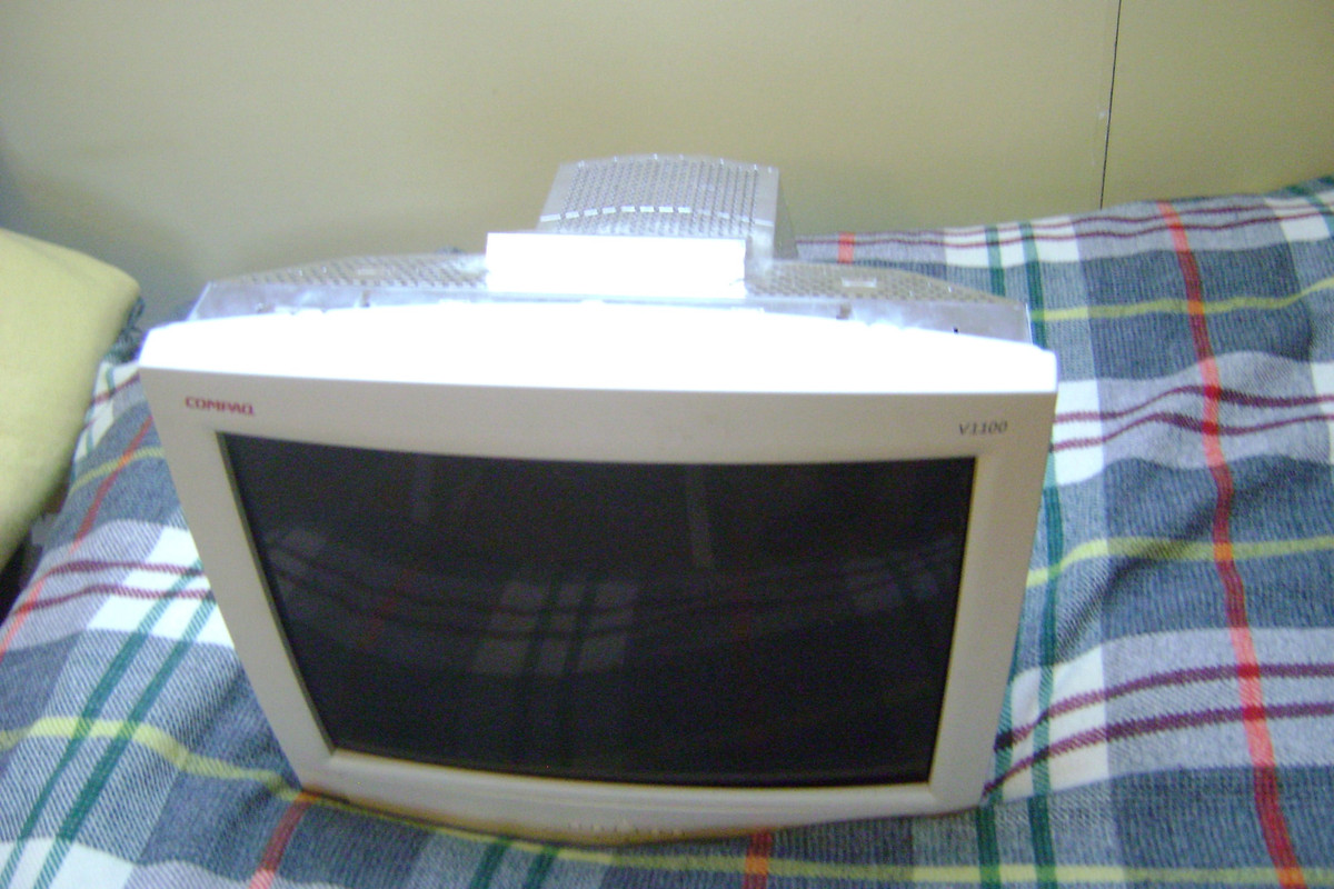

I cut the monitor bezel to be a square, so if I want in the future it will be a relatively easy job to rotate the bezel to a horizontal setup.
Here is the monitor that I will be using, a 21 inch CRT PC monitor:
And the monitor de-cased and mounted on the bezel:
And slotted into the cabinet!
« Last Edit: April 30, 2020, 02:26:18 pm by Don »

« Reply #13 on: February 19, 2017, 06:28:13 am »
That CRT makes me happy.
Same here. Kudos to you.
Thanks! It had to be a CRT for me. Using a PC crt as I will be playing 31khz games, but possibility of switching to crt TV in the future for 15khz games.
Here's the monitor in horizontal mode.

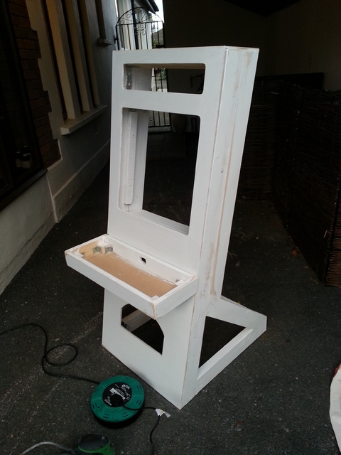

« Reply #17 on: March 18, 2017, 10:53:37 am »

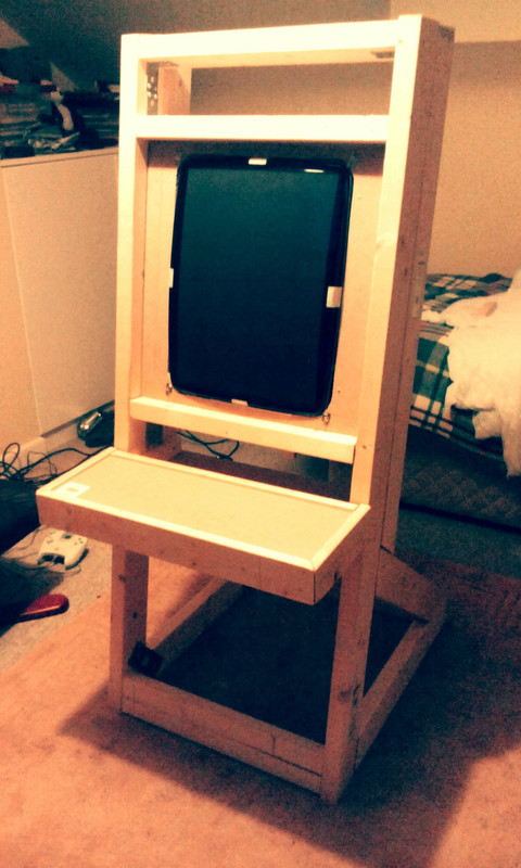

Cut the front panels and did some primer painting and sanding. There will be a led-lit display area for the dreamcast, hence the semicircular hole!
I also put on some rubber furniture feet which seem to work well.
Next up is fitting the speaker material and cutting the bottom panel and display shelf for the dreamcast.
