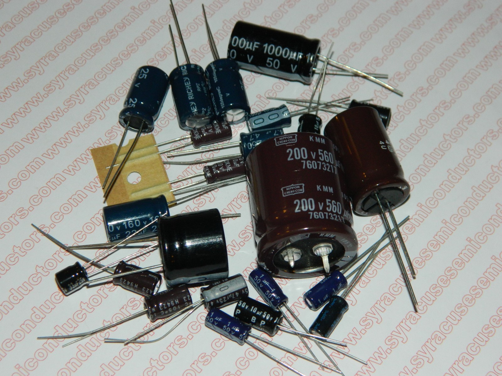

Cheers for the reply Shawn. Cap kit is already on the way, although it might not be here for a couple weeks. Has to come all the way from New Hampshire. Took a couple snaps of the chassis in it's current state just to have for reference.
See if there is a vertical size adjustment.
Yes, so I printed off the manual and gave this a go. Vertical size adjustment had no effect at all; results were the same more or less. The only noticeable differences today were that the flatline remained on screen for a lot longer this time before the stunted image showed up. No green today, only white. Also, the image was flickering like crazy. Couple of pics below for anyone interested.
This is the cap kit I have on order from syracusesemiconductors on ebay.

Capkits are a very US deal, but in all the other countries you write down the rating of the bigger caps and buy some spare of the others: in the end you have all the caps your monitor needs and some spare left at the same price... and WAY FASTER ;)

... and do not rely too much on the capkit caps specs: replace capacitors with spares with the exact same capacity and same or higher voltage rating. The values on the chassis caps are the right one, not those of the "per-model-universal" capkit
