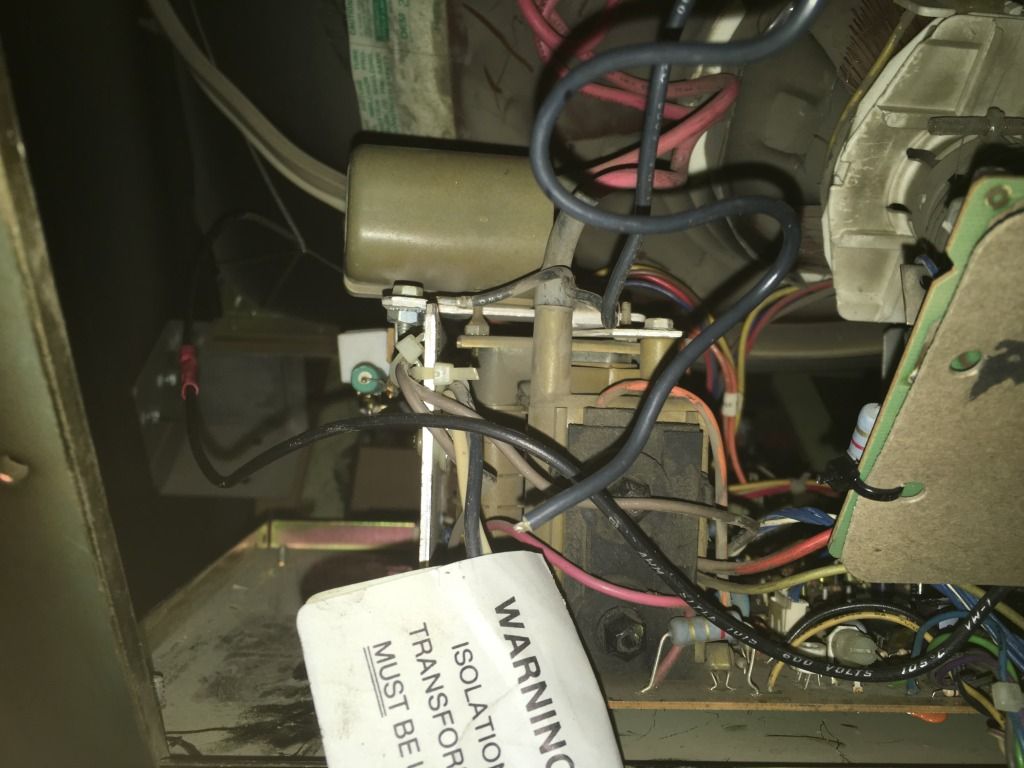

Let me front end that I am new and still learning my way around arcade hardware, but am having a blast so far. Here are my issues.
I have a WG 25K7191 monitor inside of an old "Hit the Ice" cabinet. I tried turning the game on and I get a blip of light in the upper left corner then nothing. It lasts a split second and sounds like the monitor wanted to turn on before it gives up and shuts down. No sound, video, nada. I checked the power supply and have 136.0V coming in and going out to the monitor. The 5V and 12V that go to the JAMMA board are pretty close (4.98 and 12.05). The continuity and solders in the actual JAMMA board look good and I don't see any glaring issues (cold solder joints, dark solder or bulged caps). I'm having trouble wrapping my brain around a few things and was hoping someone could help.
*Don't laugh too hard* What is this main power unit called? [/URL][/img]
***edit*** The picture is of the isolation transformer.
Is the 136.0V output to my monitor too much? What can I do to change this voltage (if needed)?
Is the chassis more than likely the issue and not my power supply or game board?
This is my intention. I just ordered an Arcade VGA card from Ultimarc. I have a PC that I will be hooking up to this cabinet. I would like to bail on the old controls (4-player but only 2 buttons) and go to either 2 or 4-player with 6-buttons. I will more than likely do this with an ipac. What I would like to do before I purchase the ipac, joystick and buttons is to make sure that the monitor works.
Any idea what might be causing the issues for the monitor?

Re: WG 25" K7000 issues - AC Voltage 136.0V
« Reply #3 on: October 29, 2015, 07:38:36 pm »
136vac is a bit too high,i would think 130vac is a push on this model
you should still get a monitor running at that ac level though,might get regulation issues but it would sort of run
your issue is an actual chassis fault-which could be a multitude of things

« Reply #5 on: October 29, 2015, 08:30:47 pm »
I have similar issues from my mains supply,i am in the u.k and the supply is meant to be 230vac but mine is 255vac-this means i have to make sure any transformers i use are tapped on the ac input primary as high as possible(i.e 240vac)
if i don't do that all my ac voltages from the transformer are 10 volts higher than they should be-causes issues mainly on electrohome chassis rather than k7000
the k7000 has a regulator ic and i reckon it can soak up a bit of the higher ac
that wiring looks like it could be a midway cab,in that case i think you may find there are ac input primary links that can be moved(its on the big white molex connector i think)-you would need a manual to confirm this
for instance if you find that your ac supply is 130v and the transformer links are tapped to 110v then that would be the problem,you would then move the transformer links to 130vac and i bet your secondary ac would then drop to 120vac

Your monitor is in xray protection. It's a zenith k7000 (k7000a) and the block you see is part of the (almost impossible to find) flyback. Not sure what that brown fluid/glue is, but the yellow one under some caps is there to reduce caps movements during charge/discharge cicles.
Extra components under the board are not necessarily a prior op clue: such factory revisions of the boards are common

Check continuity with a meter between the leads going to the monitor and the plug that goes into the wall.
I did not get continuity between the prongs on the plug and the adapter that attaches to the monitor. Does this mean that the isolation transformer might have gone bad (see 1st picture above).
Kevin Mullins
  • Posts: 4504
    • Me on Myspace
« Reply #27 on: November 01, 2015, 10:52:55 pm »
That is fine, that is what you wanted to see, that means it IS isolated.

I made one rather large error before initially posting this. I did not measure the voltage at the outlet, only the voltage that was powering the monitor inside of the cabinet when not under load. Now that the monitor works properly I am seeing 125V at the monitor and seeing 123-125V at the outlet. Game on!
