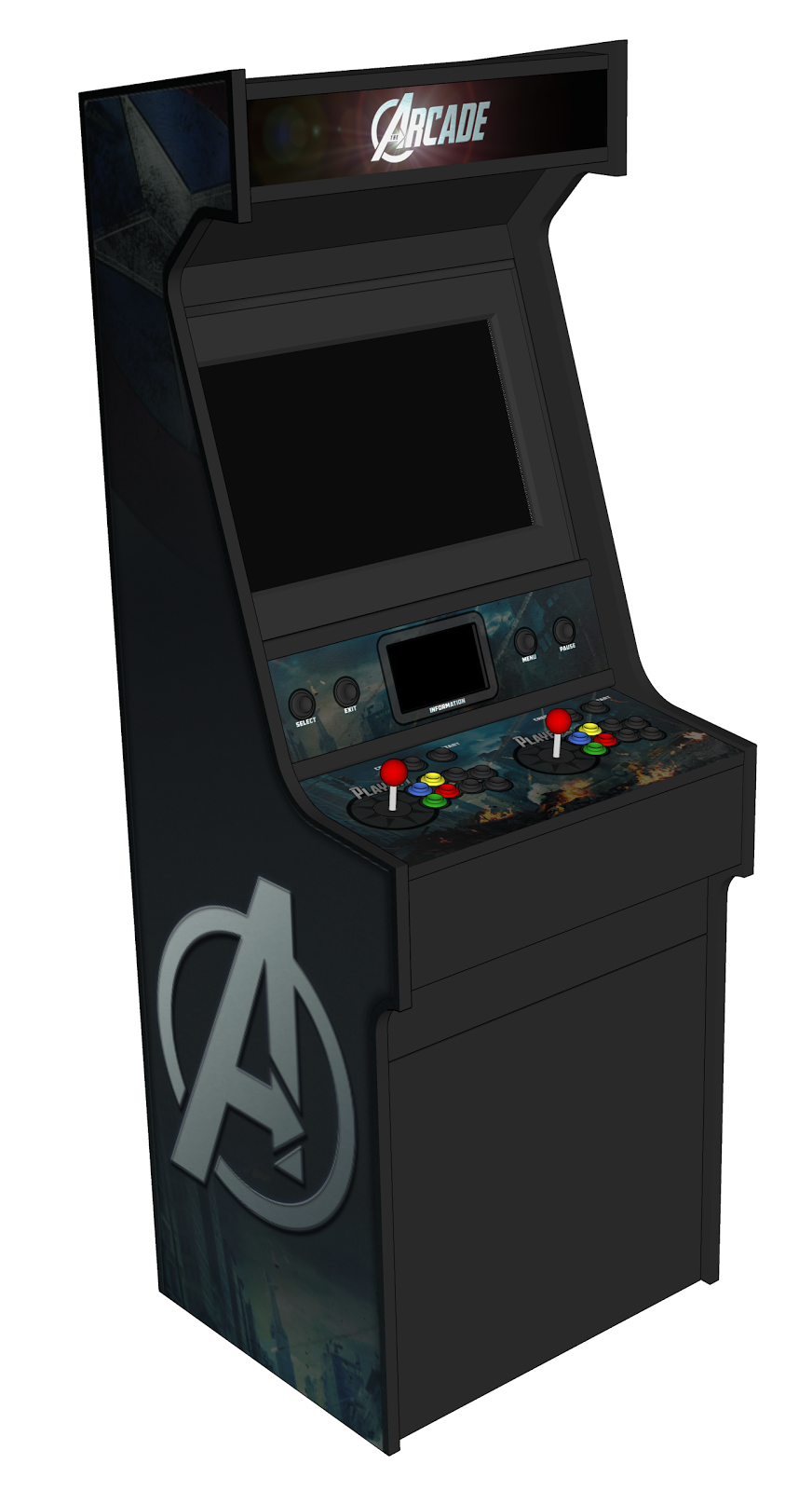

Submitted my order Friday night (total cost was $88.46, including shipping).
This morning (Monday), I just got an email saying it was done, along with a photo and a tracking number.  So far I'm happy.
(and as you can see, there's not a lot to my art, so I wasn't that concerned about color reproduction)
Photo from Souldraw
Sketchup render of my cab
