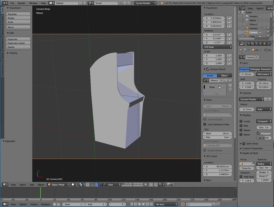

I started Blender and ended up with this:
The previz didn't exactly "Wow!" management:

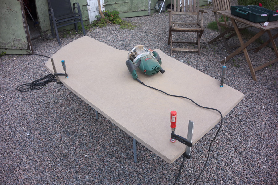

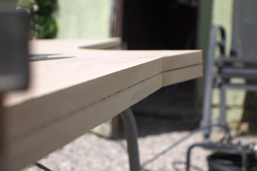

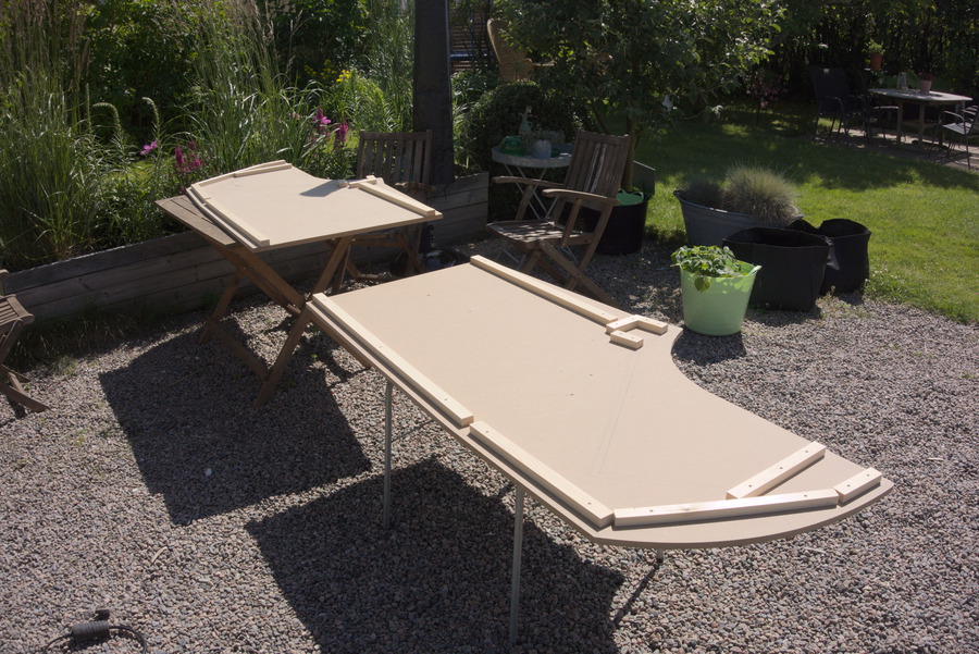

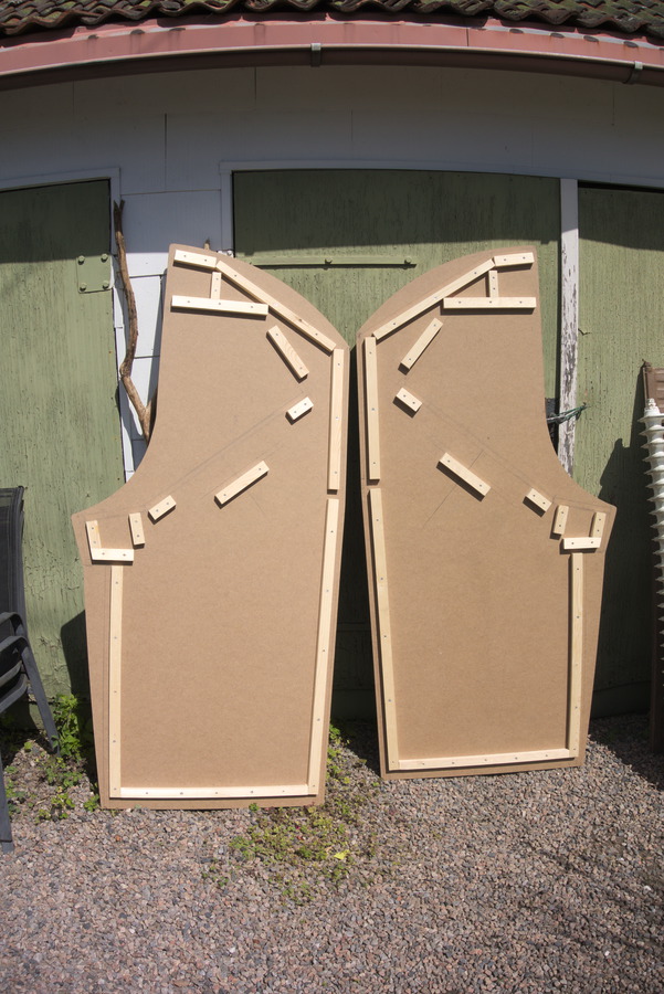

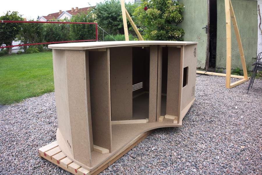

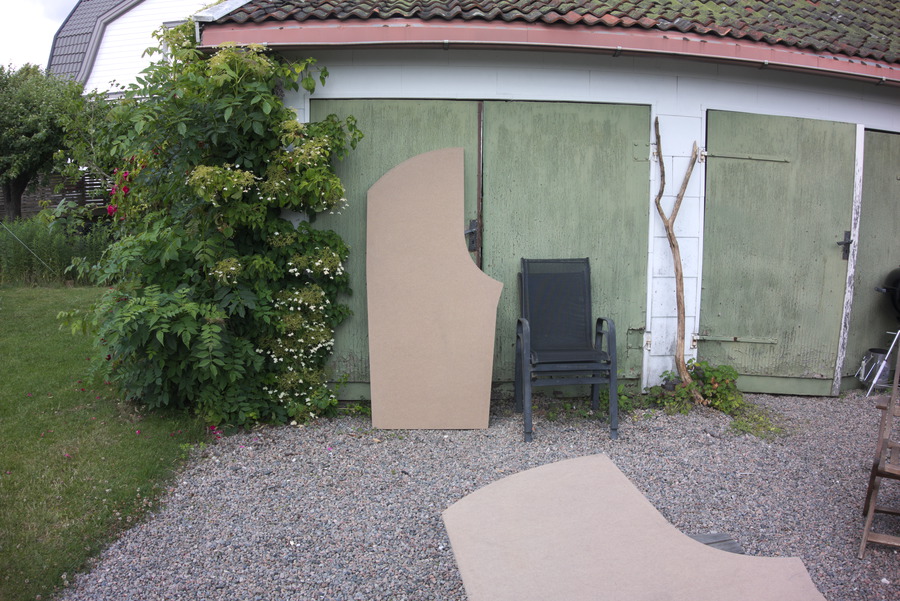

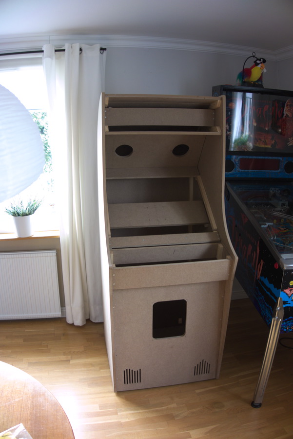

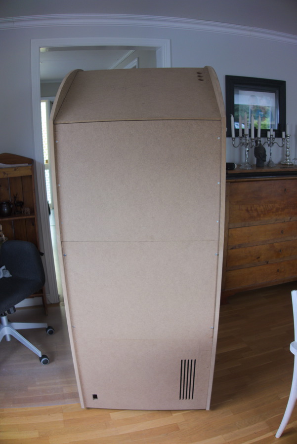

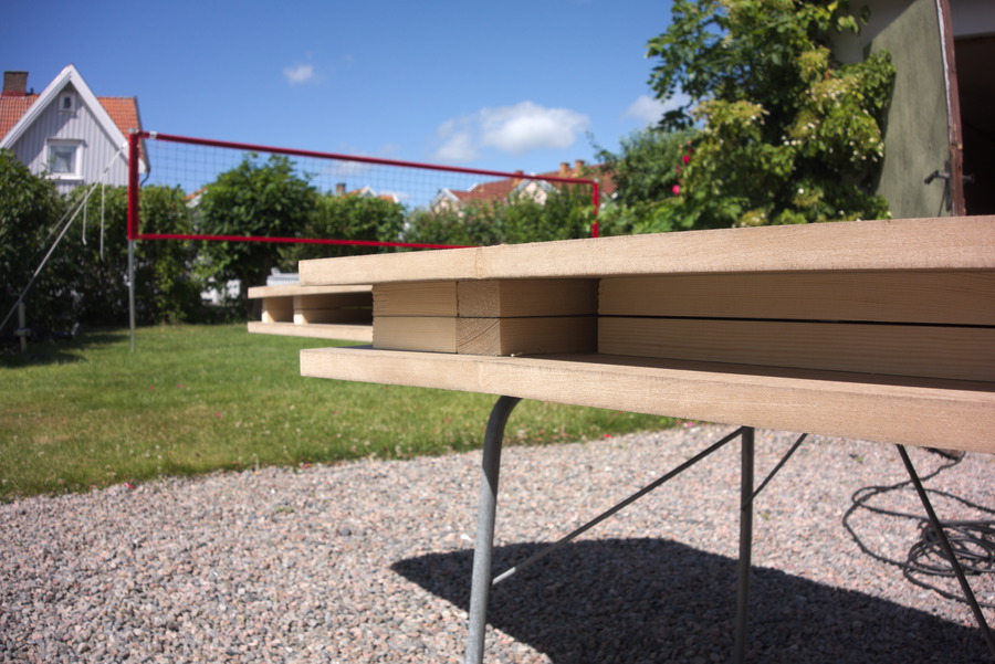

The build begins... 16mm mdf.
A few days later:
I call this piece "The Router Exam":

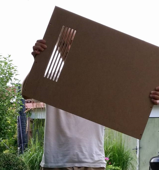

Front..
..Back

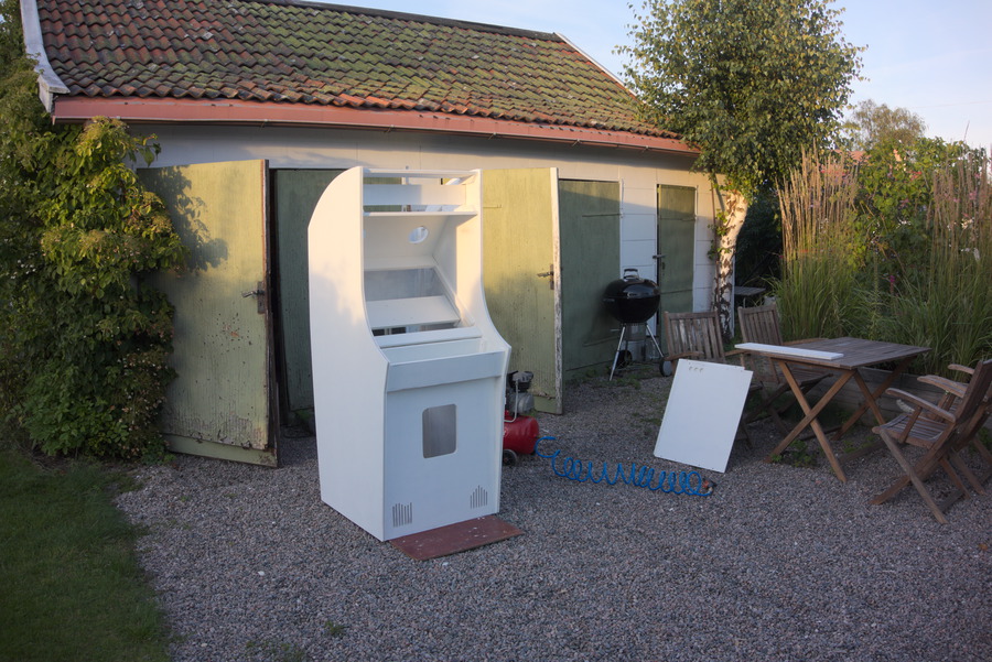

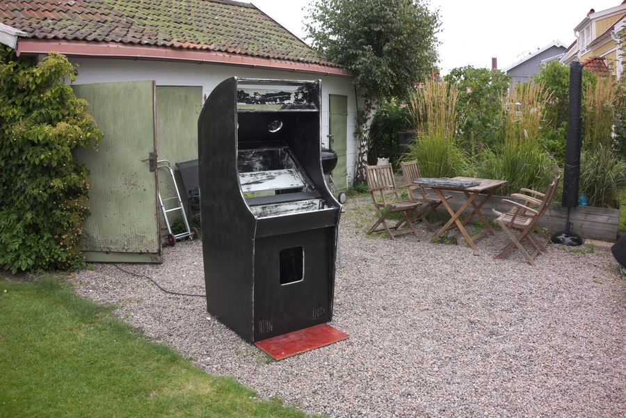

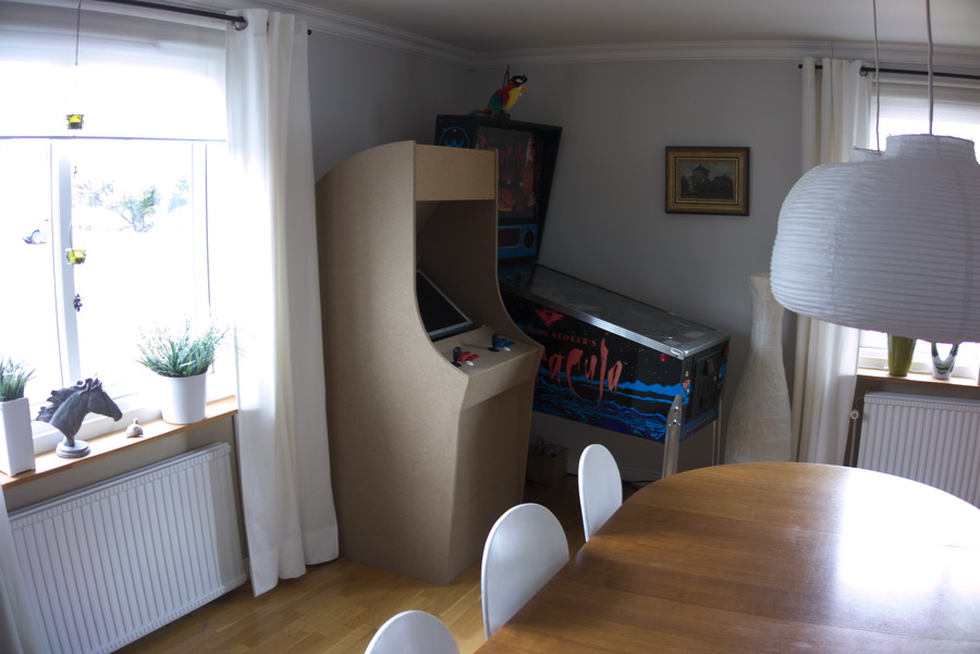

Sand, prime, cover screw holes with PP100, sand, prime, sand.. ready for paint:
Paint, sand.. ready for second coat:

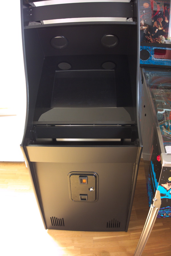

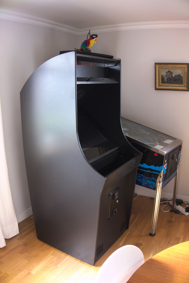

Painted again, mount bezel, t-molding, coin door. Ready for center stage:

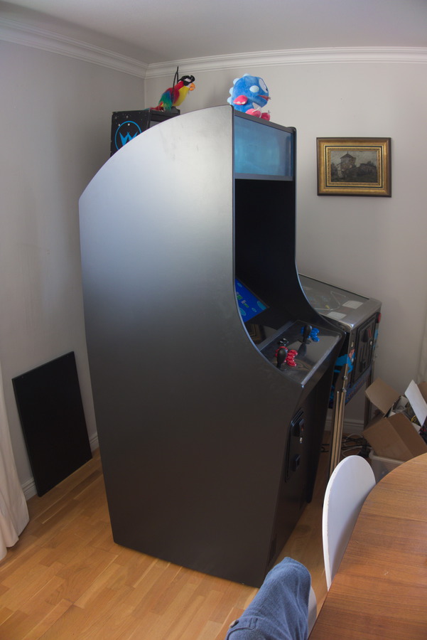

Mounted marquee lights (Ikea Dioder, 4-piece strip), buttons, joysticks, sound, computer, internal powerstrip:
2*Admin buttons, 1*Computer Power Switch:
Rear view:

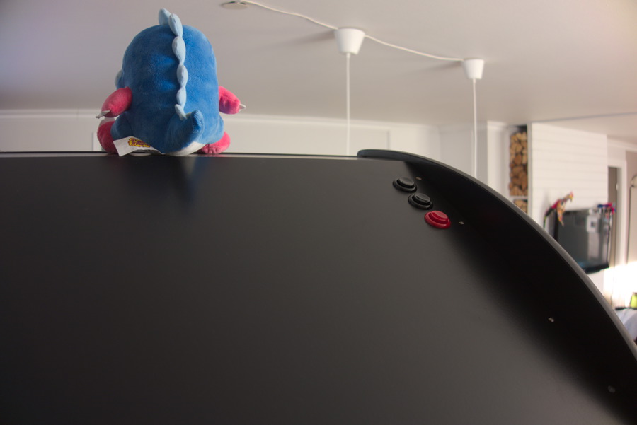

Side view:

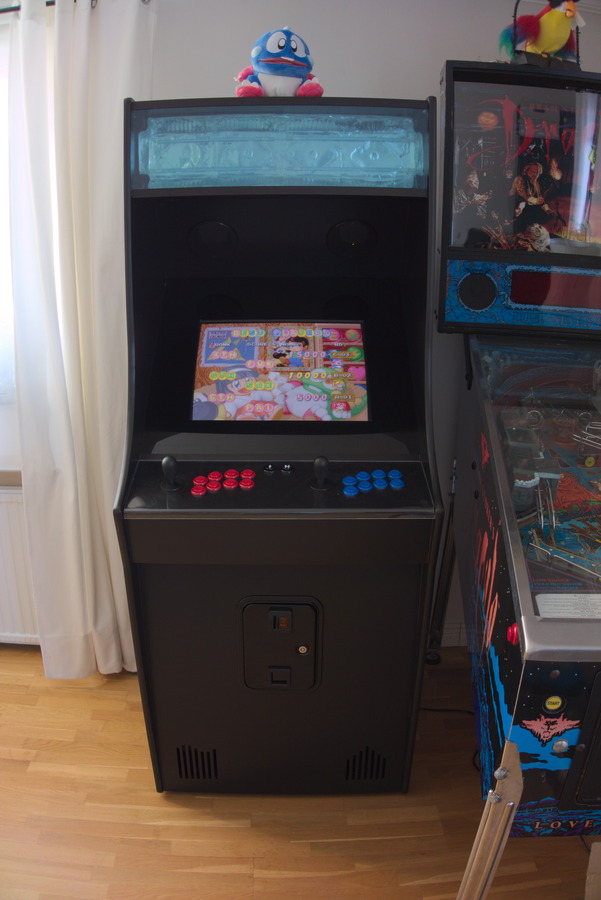

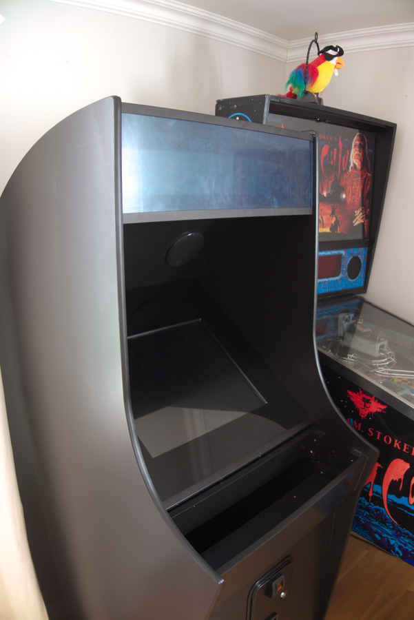

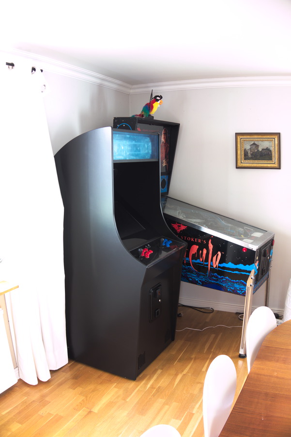

There it is; a clean canvas, themeless arcade.
- Ready for art!

Man! What a great paintjob!  :applaud: And you definitely passed the router exam!  Great job!

Regarding the paint..
I used a roller both for the two coats of primer and the two coats of paint (in some places 3 coats of paint).
Breakdown:
- I lightly sanded the bare MDF  (For sanding I used a multi-sander, Bosch PSM 160 A)
- Applied 1st coat primer
- Covered screw holes (Plastic Padding PP100)
- Sand everything
- Applied 2nd coat primer
- Sand everything
- Applied 1st coat paint
- Sand everything
- Applied 2nd coat paint
(skip sanding)
- Touch-up 3rd coat
The primer was a "normal" wood primer (oil-based to dig into the mdf).
The black paint was... I'm searching for words.. "cursed magic"!? I got it recommended by my local dealer.
Perhaps you can see this link ( http://www.nordsjo.se/sv/produkter/ambiance-superfinish-40 )
If not, the paint is acrylic latex with added polyurethane if I'm reading the description correctly.
Stirring it reminds me of mercury. Odd!
In places where I really did the sanding correctly the paint would just magically stick and float to perfection.
In places where I rushed priming/sanding or sanding was hard to do the paint was like... painting over silicone!? Done that? It would just not stick. (You can see what I mean in the picture above where the first paint coat has been sanded, the insides are almost bare as I had not spent that much time sanding there)
Please note; I've never done painting like this before so I cannot tell if I any of the steps were unnecessary.
Regarding the 8 buttons..
Simple math: S-F(3+3)+N-G(0+4) = 8
I figured that 7 would look even more wonky than 8 (for anyone not regular to this forum).
I've currently got top right buttons wired to Coin when playing Mame. (Works for me!)
If I ever redo the CP, which I might, I'll go with 4 buttons only as SF is not that important to me.

This 7 button setup was done tastefully.
Most pro-sticks have the 8 button layout as well, so it's not a whether it's needed or not, its a personal preference in regards to what layout allows you to play the game more efficiently.
Some people are good at the combo button presses, but what makes it easier is where those buttons are on the stick.  So the 8 button layout accounts for that, more flexibility for mapping.
To some folks its not all about aesthetics, this is a very nice cab which has the option of maximum mappable buttons to kick somebody's ass in your favorite fighting game.
I wouldn't call adding extra buttons being lazy, he's just optimized his layout for full compatibility across the board.
