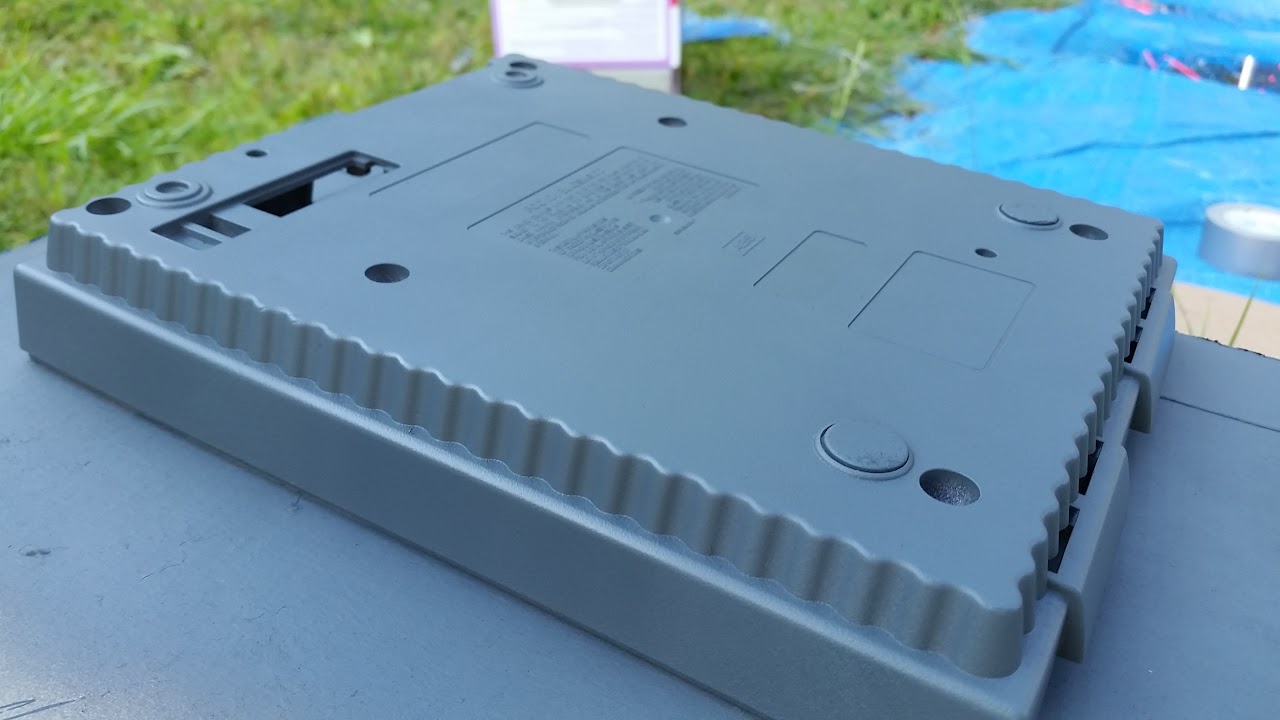

then came the painting. i used Charcoal Duplicolor Vinyl and Fabric coating that i picked up at AutoZone.  this stuff is amazing..it doesn't sit on top like regular paint, but soaks into the plastic like a dye.  It is hard to tell from the pics, but the shell looks like it came this color.
The buttons were painted with Rustoleum UltraCover 2x Gloss Plum spray paint.  the color matches very closely to the original purple.  they came out ok, but are obviously painted...no where nearly as nice as the Vinyl dye.  i learned this trick from someone on anther forum, tape a piece of tape, sticky side up, to hold small items still when painting...it works very well.
here is the painted shell, along with the paints that i used..
