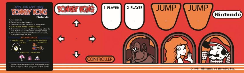

One issue that has been bugging me as I don't know if one action button will be sufficient on the CP.   Thought about adding one more action button, but will need someone to redesign the CP overlay with the additional button.
I know that most printers probably prefer vector files to print, but if someone has a stock CP overlay graphic that is high enough resolution, I don't mind attempting to modify the image myself with Photoshop.

Here is the 2-button layout I used for my Mini Donkey Kong. But you can't use this because it is the wrong 1:1 size. Just showing you for a mockup example:
Also, you can obtain just about any DK artwork you want here. If you are only comfortable in photoshop, you can export the .ai file as a .tif or .jpg and photoshop it from there.
For what it's worth, I only put 2 buttons on mine because it was a mini cab. I guess it depends on how "true to the original" you want to be but if I was building a full size DK, I'd just do one button. Others may disagree.
And if you really wanted to get carried away, you could build 2 control panels!

Thanks, vwalbridge.   Your bartop build was awesome.   That's where I got the idea to add another button.   I didn't bug you for the artwork yet because I knew it was not 1:1 scale.   I think that 2 action buttons are a happy medium between "omg must play every game" and being semi authentic looking.    I'm pretty sure that most visitors to my house won't even notice the extra button if I implement it as well as you did on yours.
My last build had 2000+ games.   When it becomes a chore to select a game, I get funned out quick.   Looking at maybe 20-25 roms on this one.
« Last Edit: July 30, 2015, 03:45:11 pm by Psychosys »

Yea, I always forget the good vertical shmups out there that are going to require 2 buttons. Among others. If I had to do it again, I'm not so sure I would have included the orange badge and JUMP text on the second button. Seems a little weird to have 2 buttons labeled JUMP. I tossed around the idea of having the second button say "ACTION" or "BOOM!" just for fun... but nothing seemed to fit. In the end, I should have just put a second button without any label.

Haha.   I like the unlabeled idea.   Started drawing out the side panels using the jakobud plans.   First thought was "holy crap, Nintendo cabs have a lot of measurements and jakobud shows nothing of the interior panels".  Second thought was "I wonder if staples can print these".   Going to staples tomorrow for the side panel templates
