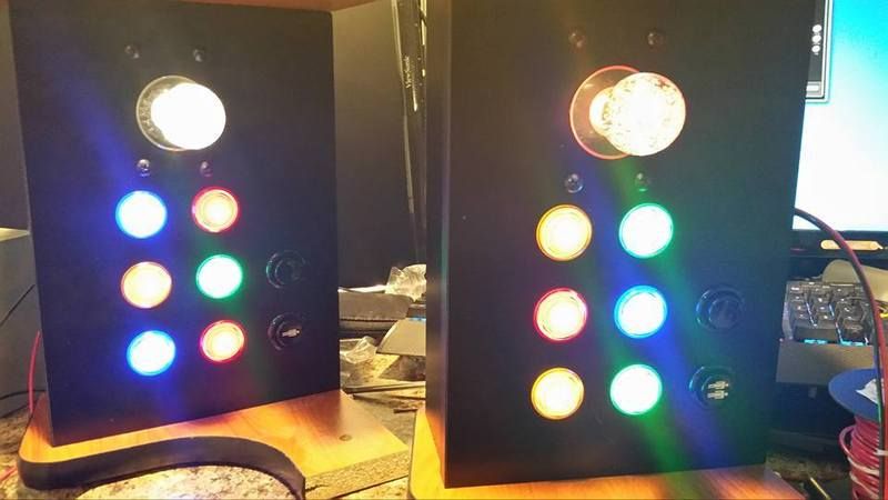

So I was able to get the guy who has a kitchen cabinetry shop to route me out a groove to make the LED joysticks fit properly. I finished off the daisy chains for the power to them, finished programming the computer that is going inside, and now have both joysticks fully operational and MAME controlled completely by joystick control.

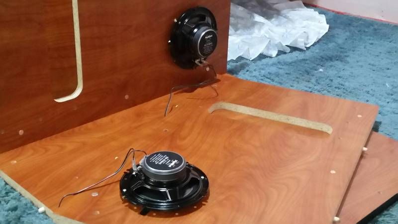

When I had spoke with the consultant at recroommasters.com and asked about speakers... he recommended 4", but not over 5", so 4" is what I had originally purchased... however.. after examining the parts when they arrived, I noticed I could have EASILY added something bigger. So I made a trip over to Wally World and picked up a pair of 6.5" Sony X-Plod's. For reference... one could EASILY install a pair of 6x9's as well.
But anyways... got ALOT of it done... taking a breather ATM and gonna go for more in a bit...here is what it is looking like so far:

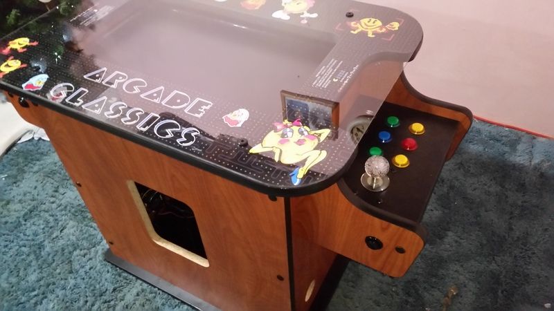

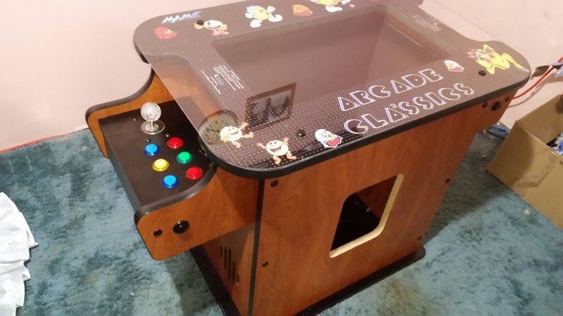

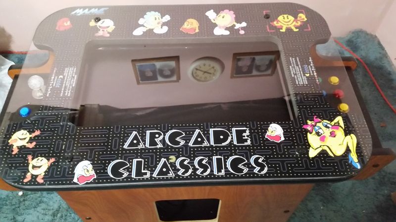

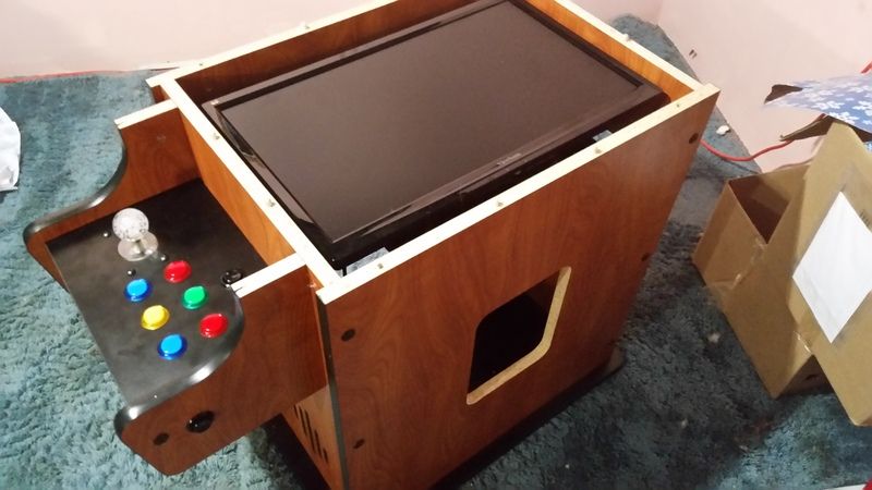

Here's a couple more photos of the build:
And last, but not least........THE FINISHED PRODUCT !!!!

Third.. I noticed that the monitor can be raised just a bit more.. like maybe about an inch.. So I'm gonna make a trip to Menards and get some more washers and some longer bolts then what came in the kit and raise it up till it's about flush with the underlay board (OCD kicking in). All in all, recroommasters.com offers an excellent kit. Great way to make your very own arcade game!!
