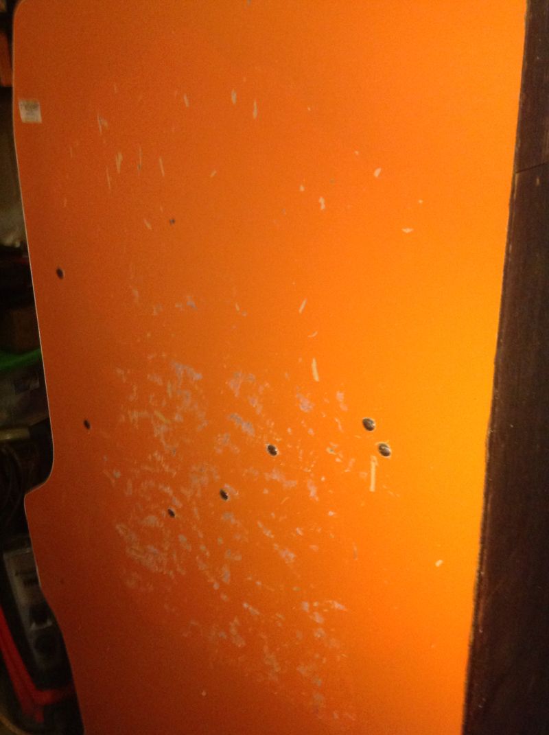

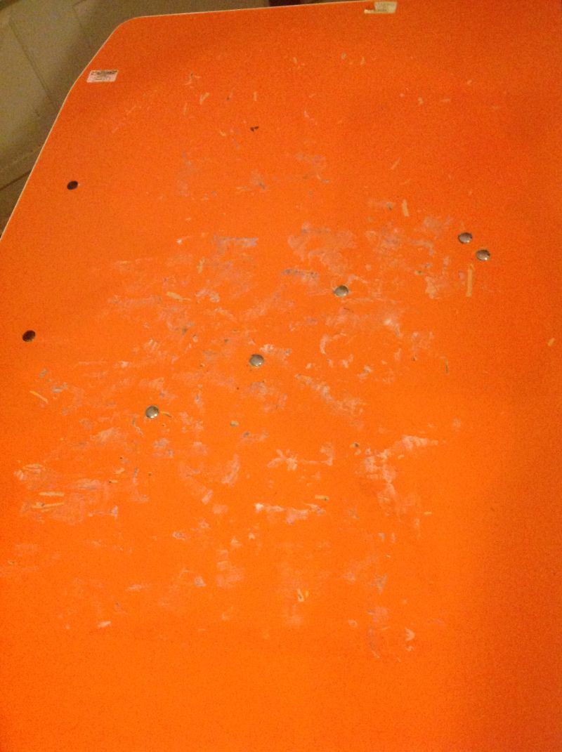

So I worked the side of the cabinet with a plastic razor, goo gone adhesive remover, and a wire scrub brush and I still couldn't get all the old adhesive off of it!

« Reply #100 on: January 20, 2016, 11:38:21 pm »
Here is the cab side after I initially worked it over for around an hour or so.
And here it is once I stood it up again and worked it with plastic razors swapping them out every three minutes or so.
Somewhat improved but not really.
