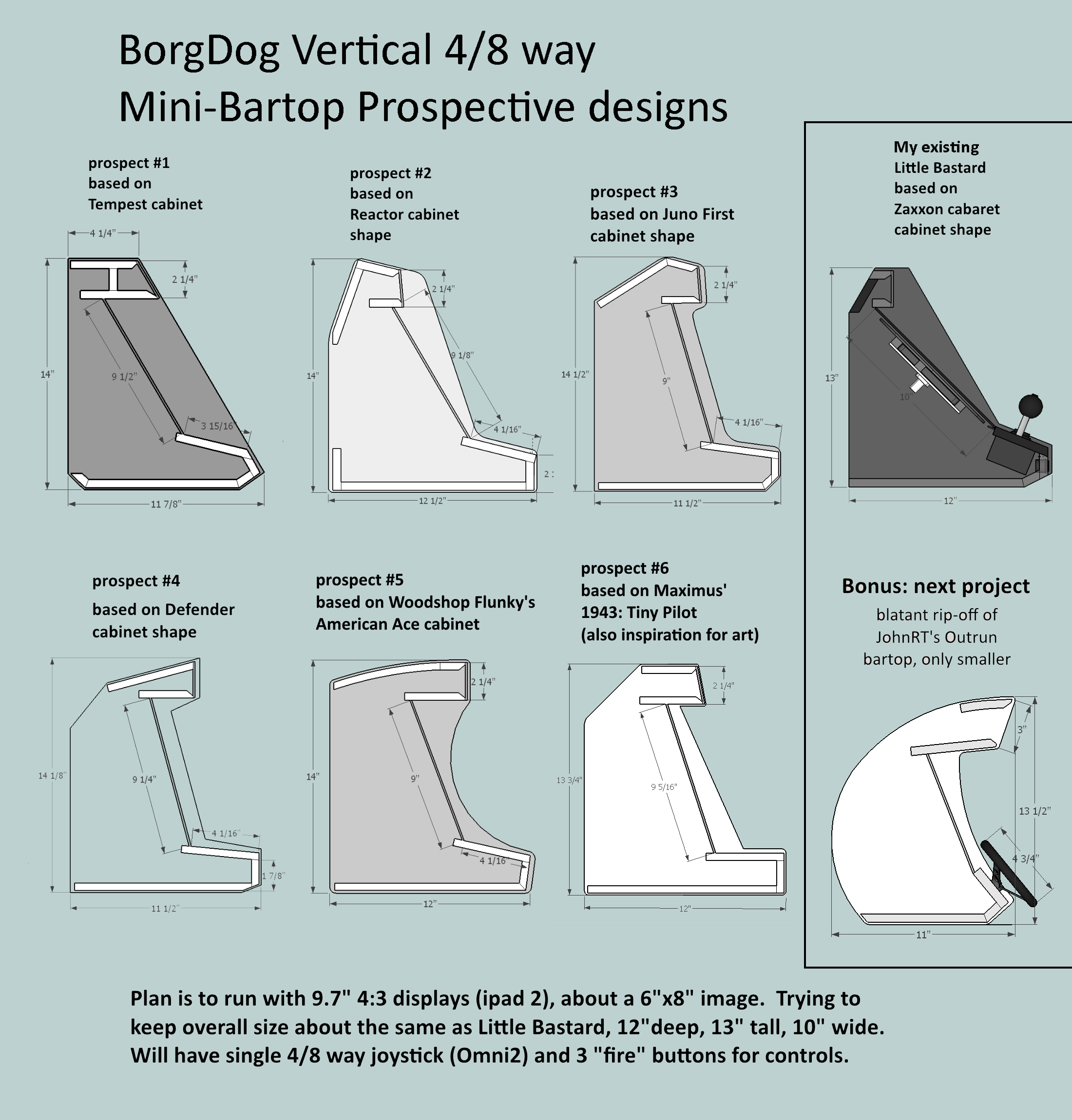

The plan is another small bartop about the size of my Little Bastard (link in sig) or around 12" deep x 13" tall x 10" wide.  I really like that size of ease of taking somewhere with me, and for fitting in a small space at home in the office/laundry room. This one will have a fixed 9.7" display vertical orientation (ipad2 display).  I mostly have tried to mimic real cabinets and play around in sketchup to get the profile.  My prospective designs are:
Despite going with a 1943 theme inspired by Tiny Pilot and American Ace, I really like the clean lines of the Tempest cabinet.  I did a quick printout of my planned control panel and think the closed sides may be an issue for joystick control and hitting my hand into the side, so will likely go with one of the others.  What profile do you all think would work good?  Any other cabinets that you think would translate well to this size?  A big consideration on something this small is keeping the marquee from sticking out to far into your face as generally I sit pretty close to Little Bastard to play.

I like #3 best, followed by #6. I like the 1943 art too. It's going to look great for a shmup cab.
