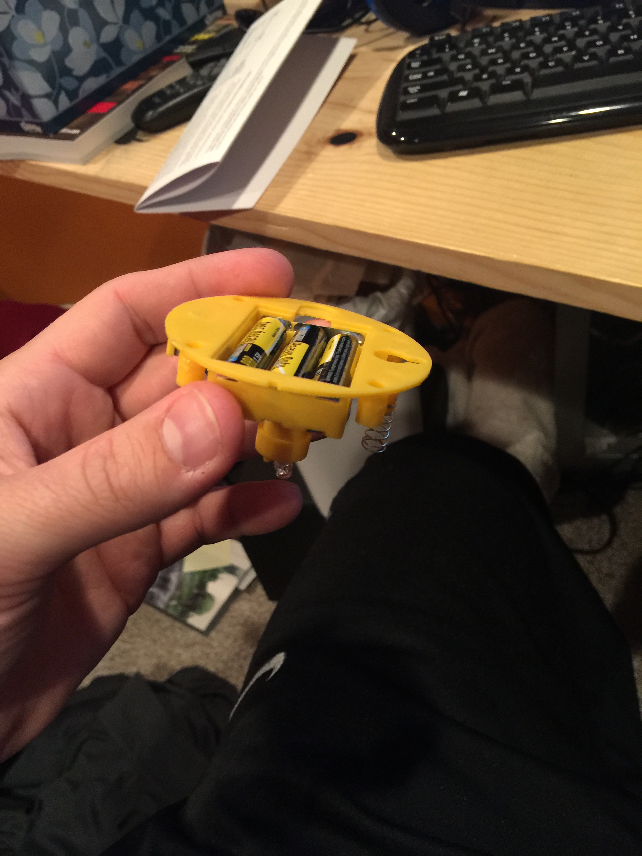

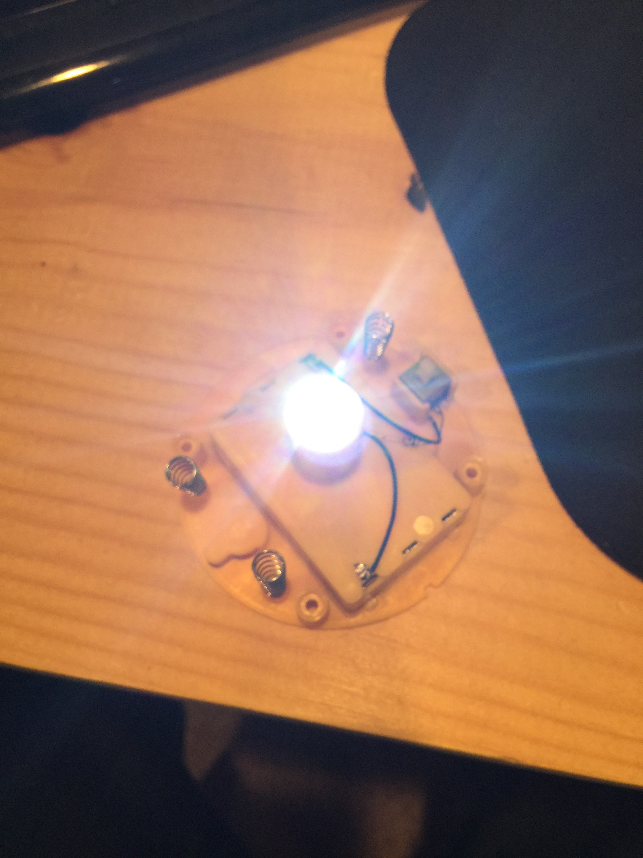

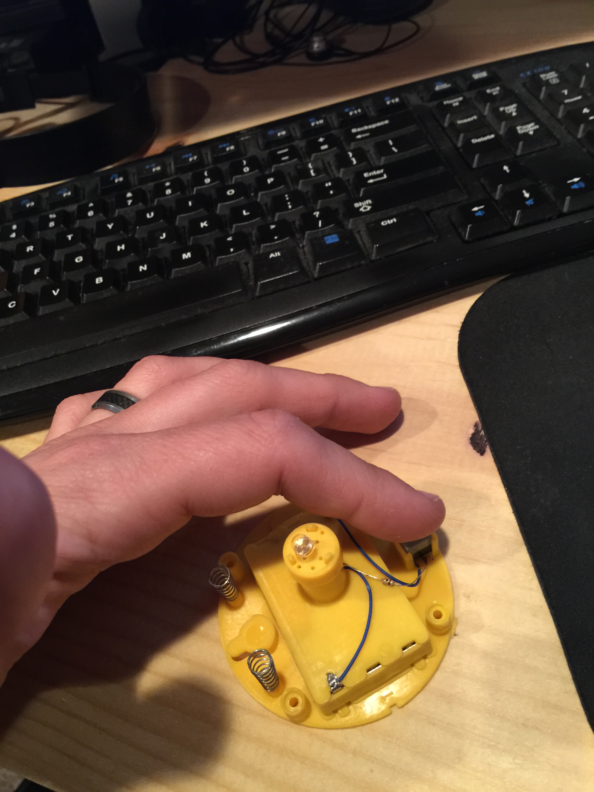

Hey everyone.  Just hoping someone might be able to lend me a little electrical knowledge.  I have this small device.  All it is, is when a switch is pushed it turns on a small LED light on the top.  Currently, it's battery powered by 3 AAA batteries.   I'd like to make it so that this thing is attached to USB to be powered instead.
Here are some pictures of the device.  Top View:
Switch:
Lit Up:
Bottom Batteries:
My real question is, is it as simple as chopping those two wires going to the battery bank and splice those over to a USB cable instead?  Anything I am missing?   I need to figure out what wires to use inside a USB too...

The quick answer is just chop the USB lead and connect the 5V and GND to the + and - of the battery contacts. The reason is simply that 3x1.5V is 4.5V and the additional half a volt will make at most 3-5mA difference to the LED. You won't even see a difference to the brightness. You'll be fine.
