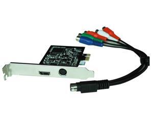

I have an older Sony 4:3 LCD tv which has S video and ypbpr inputs.  Also have a Dell dimension 3000, p4, 2.8, 2gb ram, running xp sp3.  Does not currently have a standalone video card (just the factory provided integrated graphics) System will be for mostly console emulation genesis, snes, nes, and some mame.  I've been researching for a bit trying to find the best way to utilize the component inputs on my screen, but a lot of the info is 10 years old.  I looked into converters which seem to either have poor reviews or are completely price prohibitive, I've also looked into adding a graphics card.  New card option is limited by the  Dell only having PCI capability (no PCIe, etc).  Looks like there were several ATI radeon cards made which were capable of component output but I can't seem to locate any currently available (8500/9500/9600/etc).  Is it worth my efforts (or even possible) to find a PCI compatible graphics card which can output to ypbpr, or should I just grab a video card with s video and call it good for probably around $15?  I've built a cab following OND's plans on this site, but completely underestimated what was involved in outputting from VGA to S video or (preferably) component (noob issue... just thought I could buy a vga to component cable and go to town...)

I right clicked your text: "PCI compatible graphics card which can output to ypbpr"
and google found this
(click it)

The card shown is not a PCI card.  That seems to be where I'm running into issues with finding viable options.  Are there PCI cards available outside of the ATI Radeon cards listed in my initial post which can be adapted to output ypbpr?

that is a pci-x 1x card. newish pc have a couple of the slots. mostly used for audio and controller cards.
