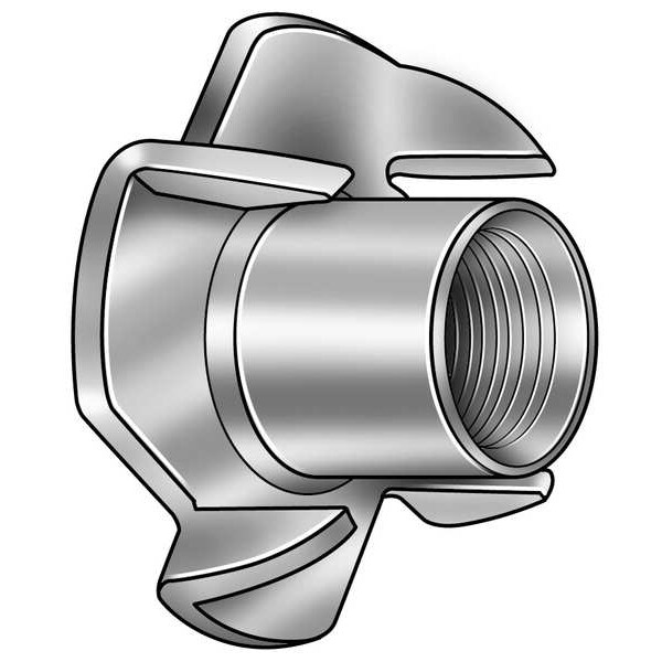

Probably right.  I need to find the right screws and inserts for 1/2" MDF.  The only ones at the big box way too long.  I currently have some hanging ceiling tile braces I was going to use for the bezel.

I copied martijn and use T-nuts in all my top marquee rails
Re: Slim NoName Multicade - Back to Building
« Reply #74 on: March 04, 2015, 09:48:10 am »
Actually, 99% of the games BITD used T-Nuts.  :cheers:
