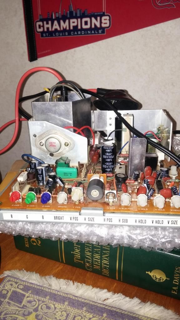

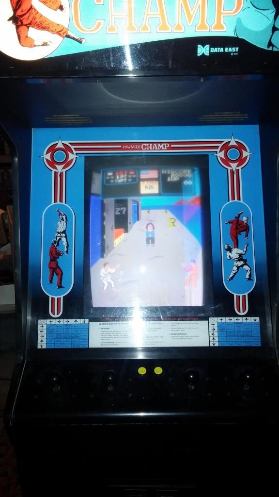

So on the advice of grantspain I replaced a bunch of the caps on the monitor board. Thank you! I am feelin' like I'm a lot closer to making this monitor work great. I don't have all the caps I need to replace all of them on this board. RadioShack only had two caps that I needed in stock. Is that because this thing is 30 years old or is radioshack just not the place to get caps? What's the best place to get 'em online? I've just got some lines on the right side of the screen now. I think replacing the last few bad caps will fix that. I've never actually replaced caps before. This is pretty satisfying to do so far.

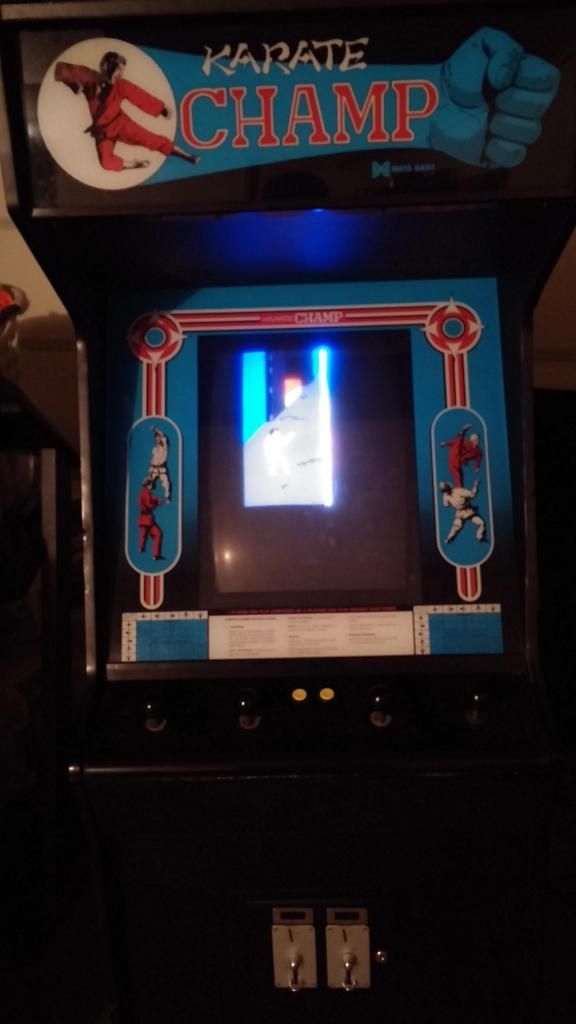

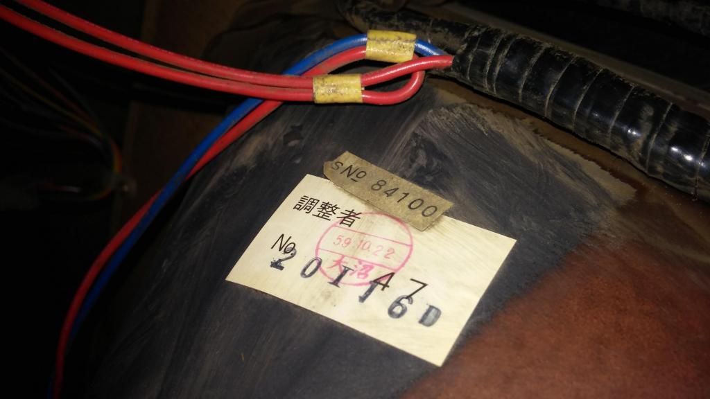

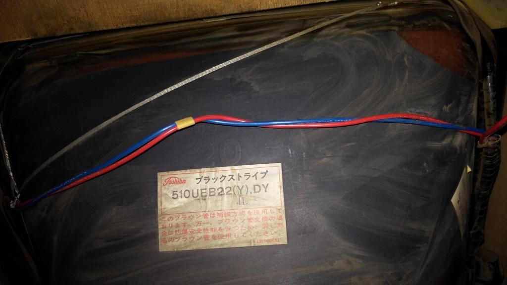

Recently bought a Karate Champ arcade game from a thrift shop (yes somebody actually donated an arcade game to a thrift shop) and I'm trying to fix the monitor. It's currently not playable and taking up space in my garage much to the dismay of my wife. I'd love to make it look nice and be able to play it with my son. I'm a complete newbie here though :( I have no idea what the make and model of the monitor is so I've included some pictures the show the monitor's board, a couple pictures of the monitor itself and a shot of what the monitor displays when it's on. This thing was filthy, it was just caked in dark rusty colored dust. I took the pics after a lot of cleanup but it's still pretty dirty. I tried adjusting the picture using the control knobs on the board (two of which broke off as if they were made out of old cheese) and then I apparently blew a fuse because the monitor went black whilst twiddling the knobs. I did find a 1.2A fuse on the board that is indeed blown so I'll replace that. In my haste to just get this thing working I did buy an LCD converter thing and a cap kit (likely for the wrong monitor lol). I'd rather use this monitor it I can get it to work right. In the picture of the screen you can see the problem. The right half of the screen won't display anything. It's cut off on that side and at that cutoff line there is a really bright line of color as if the whole right side of the screen is smooshed into one thin bright line in the middle. So what is the problem with this thing? A bad cap somewhere or something more than that? Should I ditch this monitor and just go with the LCD? Anyway thanks in advance to anyone who even looks at this. I'm brand new to the forum but love arcade games and have always wanted to have a couple since I was a kid. What a fun hobby!
-So here's what the screen looked like before I blew a fuse
-And here's some pics of the Monitor and its board

looks like an early sanwa chassis
you can clearly see blown caps on the chassis, these plus your broken controls would almost certainly cause the issues

Early Sanwa? Thanks that's Awesome! Thanks for looking and offering your advice. I was hoping that there was an easy fix for the screen looking the way it does. The image looked that way before I touched any of the controls. But gee I suppose I'll just warm up the soldering iron and replace a ton of those caps. Don't have a tester so maybe I'll just replace all of them. Good idea or waste of time? I don't know how you can tell so easily that some of those caps are bad. Been doing this stuff for a while? The new ones I bought are considerably smaller. For example the new 160v 100µf capacitor is like half the size of the old one on the board. Are they just smaller these days or what?

« Reply #3 on: January 07, 2015, 04:16:14 pm »
yeah being working in coin op since 1986
yes modern caps will be smaller
the 100uf 160v cap is clearly knackered from the photo
there are not that many caps on that chassis so changing virtually all of them should not take too long,whilst you at it check for bad solder joints

Hey thanks again. I replaced several of those caps and slapped the thing back together again it really does seem to have helped. The whole screen was initially all scrambled but after playing with some knobs I think I've gotten it to look as good as it is going to look before I can track down some more capacitors. Troubleshooting is tough when you've really got no idea what you're doing haha.
