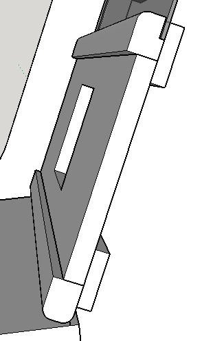

Re: RxBrad's Nameless Cab - SketchUp drawings, about to start cutting
« Reply #1 on: December 31, 2014, 03:05:17 pm »
Redesigned the frame.  I think that's a lot more structurally sound than what I had.
Also bought myself a speed square so I could get some nice square cuts; and also bought a spare 2x4ft sheet of 1/2" MDF so I could make a sawboard, since I don't have a table saw at my disposal.
Let's do this!
« Reply #2 on: December 31, 2014, 03:10:31 pm »
You really don't need a frame to make it sound. If you look at original cabs, NONE of them have any internal framework.
And I've never been a fan of 7" insert screens, but I do have to say, I like how you've integrated yours. It helps get rid of all that wasted space under the monitor. The way you intergrate it with your artwork will really make or break it. Keeping an eye on this one.  :cheers:
« Reply #3 on: December 31, 2014, 03:21:22 pm »
Yeah..  I know. Might as well build it like a tank, I figured, so I know it'll live through whatever abuse comes at it.  :bat
That, and I'm paranoid that it'll be topheavy & tipsy, so the frame adds a little junk in the trunk.
As much as anything, it makes it a less likely for me to build the cabinet and have it end up not being square.
« Reply #4 on: December 31, 2014, 03:24:11 pm »
It's not very fun moving a tank. Original cabs were held together with brackets like these.
« Reply #5 on: December 31, 2014, 03:28:42 pm »
OK.  Maybe a wimpy little sissytank then.  :)  I'm only using 1x4's, so the frame is actually fairly light.
I actually spent 5 minutes at the Home Depot this afternoon hovering over a bin of similar brackets trying to decide if I wanted to use those instead of furring strips.  My cheaper side got the best of me, and I decided to stick with the furring strips.
« Reply #6 on: December 31, 2014, 04:44:36 pm »
Old maximus pulled it off.....
However, furring strips, screws and woodglue will do just fine sir....
The internal structure you got goin on is overkill, it will be a tank though and beotch to move.......Looks good though.

Re: RxBrad's "Avengerless Avenger" - [2/1/15] Side Art Designed
« Reply #34 on: February 22, 2015, 05:31:48 pm »
Obligatory SketchUp render with art applied.   8)
It's a fairly complete version, just missing the speaker grills and the USB hub below the CP.
« Last Edit: February 22, 2015, 05:33:46 pm by RxBrad »
