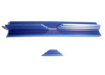

So I think I'm going to run into a lot of trouble with the T molding at these corners:
Should I round them off a bit or is that going to take away from the look of the cabinet?  Do I really have any other option?  :badmood:
Also ordered some chrome T molding from England.  Couldn't find blue in 1/2", didn't want to go with white or black.
Getting the T-molding to look good on those corners will be tough.  If they were rounded it would be easier.
IF you look back at the plans you used for this they have the corners rounded - so shouldn't take away from the look if you liked the look of the plans  :dunno

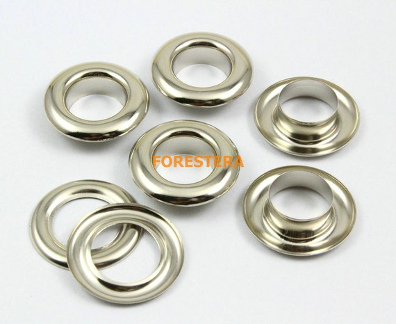

Now, I've got the 5 vent holes in the back...what does everyone think about finishing them off in chrome?  Too much?
https://www.etsy.com/ca/listing/192757023/100pcs-27mm-silver-round-grommet-eyelet?ref=sc_3&plkey=c2b9c51868b538f77c074c96c63c20b9da0aab02%3A192757023&ga_search_query=15mm+grommet&ga_search_type=all&ga_view_type=gallery
AzureKnight
  • Posts: 474
Unless you can think of a clever way to put a vented hockey puck over them the chrome sounds like a good second option.

...Now, I've got the 5 vent holes in the back...what does everyone think about finishing them off in chrome?  Too much?
Route a bevel into them, and put a piece of black wire mesh across them inside.
Yeah, never thought of that, would look pretty good I think.  Too late now, cab is painted and those chrome rings are ordered.  I think they'll look pretty good on the back.

mvolke1
  • Posts: 338
I saw your note about having trouble with the t-molding on those corners. When you're installing it, use an exacto knife and cut out a little section of the T-molding's inside groove. It'll help eliminate that bubbling you could get from the molding bunching up.
Does that make sense?
Here's a pic.

Thanks guys, did a test run with the original black T mold.  Really wraps nicely without the "T"
