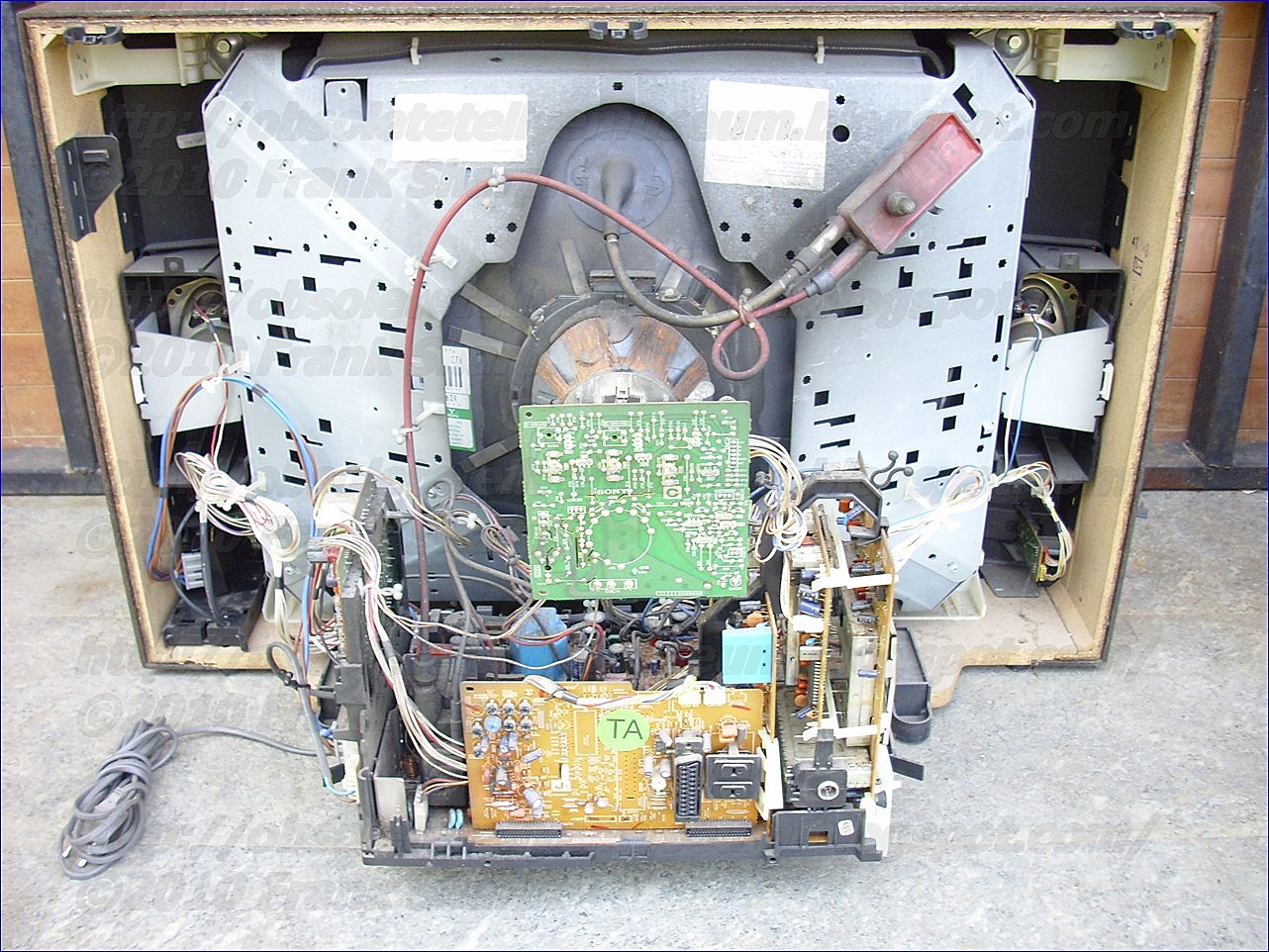

Hi guys
So I finally was able to pick up a Sony Trinitron PVM monitor. For extremely cheap on craigslist. However I'm having a big problem with it I picked it up as a repair thinking that it was only a sound issue. However when I opened up the back and turn the monitor on I noticed the spark. The monitor is not displaying a picture. Is this something I can fix I am pretty handy and know how to solder capacitors. Just not sure where to begin with this.
I took a video of the issue. I hope someone can help. The plan is to RGB all my retro gaming consoles and hook them up to this monitor.

Update: So i've been all over the internet trying to figure out what to do.  I came across a few inspiring threads that have really sparked a fire in me and now i want to see this thing through.  At any rate, it looks like the red box is called a "fly back."  So i'm going to continue my search to see if these things are fixable or if i can find one that is working maybe I can swap it out.  I understand that before working with the CRT i need to discharge the tube.  Therefore i'll be heading to HOMEDEPOT tomorrow to pick up some alligator clips in order to discharge the tube (as seen on ) before working on it.

    You will need to get a replacement, There is no realistic fix for a shorted flyback. Be careful playing around with that however, it will shoot like random lightning at you, and possibly electrify your chassis.

Currently looking for a replacement flyback for this unit..  So far no luck.. Any recommend sites that might care it?

>To bring this back up, I think I've got it fixed!
I was thinking about my tests I had done, and I thought that maybe the TV was smart enough to know if someone defeated the block. And since I had, it wasn't working for me.
I tried to order the replacement part from a few places, but no one would sell it to me! "Oh, thats a high voltage part, we can't sell you that unless you are an authorized service center." "You sure? I know what I'm doing." "It doesn't matter, we could lose our parts contract with Sony if we did!"
But I finally found Sony's own parts center: http://servicesales.sel.sony.com/web/index.jsp
And lo and behold, I placed an order, and it arrived! How odd, that Sony would sell me the 'dangerous' part, but no one else would...
BTW, the new part number is 1-230-712-23, and its white and orange, instead of red and clear. Physically, however, it is the same size and shape, with the same connections and inputs, and Hstat control.
It was a royal pain removing the red flyback wire from the original block, but I finally got it.
The TV has now been running for about 3 hours continuously, without a hickup! Thats the longest its gone in MONTHS, so I'm inclined to think that its fixed.

Hi Ed!  Thank you so much for helping me out with my search.  I acutally just came across that website myself and was about to update my thread when i saw your post. I guess that RED BOX is not a FLYBACK after all it's an HVR..
However it looks like the part is disconnected. The OP of the thread listed 1-230-712-22 in his #11 post, but then said the new part number was 1-230-712-23, not sure if that's a typo, but 23 is not found and 22 is discontinued..  That thread was created back in 02-04-2006  I guess it's back to searching https://servicesales.sel.sony.com/ecom/accessories/web/productSearch.do

i see your foucs control in that block.,or is it a sub foucs control ?
if it is foucs then u can jurry rig in a divder..

Thank you too Ed.  I've edited the top pictures to show were the FLYBACK is.  If any additional pictures are needed please let me know.
Also i came across this website http://www.asapsemi.com/manufacturer-sony/page6.aspx and they had the part number listed with suggestions to others.
1-230-712-22 RESISTOR ASSY,HIGH-V
When you click on the P/N from the list it will take you another page where you can call/email them about it.  They also list Related Components to 1-230-712-22, however the only ones that says RESISTOR ASSY,HIGH-V are 1-230-127-41 & 1-230-089-22.  A quick google search takes me to www.encompassparts.com which says that 1-230-127-41 is compatible with Sony DDM280 & DDM2802F. This item is not in stock, but i am able to add it to my cart.  There's also 1-230-089-22 which is compatible with Sony VPH722 & VPH722QM, not in stock and suggested to use substitute part 1-230-089-00 which is compatible with Sony VPH472 & VPH1031, also not in stock.  So there you have it part#s and model#s now my next step is to search the web to see if any of these are compatible with the PVM-2530 and if they are to try and find them in stock.

yup that is your flyback down there :):)
by the way your little red box there is a hvr not olny is a divder
but also a high voltage trippler..neat little pkg...
ed
