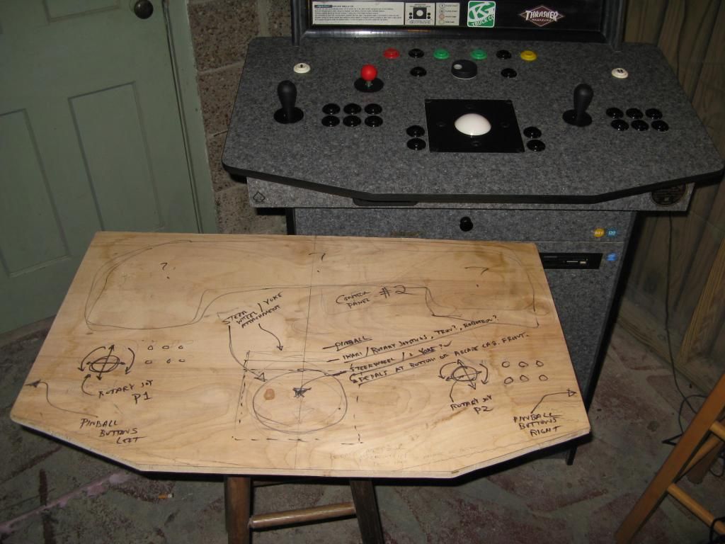

Hello,
Thought I'd build another CP (just CP top) with controllers that will allow me to hopefully play some games I've been really wanting to play.
Just looking for input, advice or any ideas :)

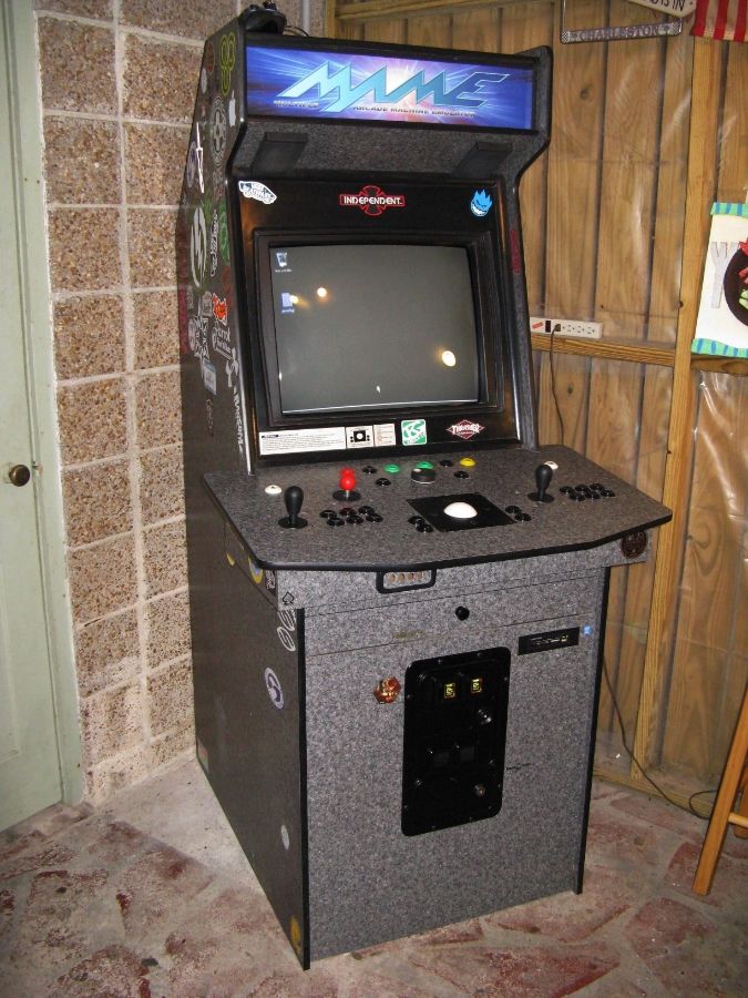

Here's a pic of my current CP (top), has Happ Super Joysticks (x2), 4-way joystick, oscar Spinner, Happ 3" trackball.
The bottom-bare cut out is the the start of #2.
Here's my cab after..12-13 years since I built it lol :)
Anyway, was thinking about making a CP with two mech. rotary joysticks.  There's several games I'm itching to play on it, including Ikari War.
As far as buttons for player 1 and 2 (rotary joy buttons)...not sure how many to add or the layout.
Btw, the rotary joystick that Happ sells is mechanical?
In the middle, I'd like to make a Steering wheel/Yoke(which I may try and build) mounting base or point.  For the pedals..gas and brake...was thinking of making a small recess at the bottom/centerish of the cab and under the coin mech.  Not sure what pedals to even look at (automotive, ones that come with some steering wheels....).  Ahh, How about a shifter?  Do I need it? or do most Steer wheels come with shifter on wheel?
The rest of the top..not sure what to do, apart from the Esc, coin, pause buttons...
Another thing is I like pinball (I know it's not the real thing but I still like it :)  was adding 1 maybe 2 buttons mounted on either side of the CP box...1 or 2 buttons?  This CP panel is not as wide as my first as I wanted to get as close as possible to the edge of the CP box, for pinball buttons on side.
Hmm..not sure what else, etc... but always like to hear any advise or ideas :)

*** Check to be sure that you have at least 4-3/4" clearance under the panel for the sticks. ***
Happ makes both mechanical rotary (50-5618-00) and optical rotary (50-5619-00) joysticks. (Divemaster has both here -- specify 50-5618-00 in your order notes to be on the safe side)   ;D
List of rotary games and MAME settings here -- Ikari 3 uses 3 buttons and all the others use less.
There are several Rotary Encoders to chose from.
I recommend a KADE or KADE-compatible Minimus ATMega32U2 AVR.
You can piggyback flippers (shown below) on certain player buttons, but since you're using swappable panels, I'd just use a KADE that stays in the CP box for the flipper/nudge/ball launch buttons.
No pinball tables have both Upper Flippers and MagnaSave, so you can wire both inputs to one button.
The pinball emulators are not as easily-configurable as MAME, so I suggest configuring the pinball controls like this for maximum compatibility.
PROTIP: Don't use normal microswitch pushbuttons for flippers. (too much hysteresis)  Goldleafs are much better. I've also heard lots of good things about the GGG Class-X with True-Leaf Pro, but haven't picked up any to confirm those claims/observations yet.
On the subject of steering wheel/pedals/shifter I recommend looking in the Driving & Racing forum.

Do I need the special rotary encoder or will an I-pac or similar keyboard encoder work?
An IPac won't work for the rotary part.
The rotary joystick has a 12-position switch (lower left) with a wiper arm (center top) like this one from an LS-30 (Ikari Warriors) rotary switch.
One of the outputs is always grounded ("pressed"), but you only want a keystroke sent when you turn the handle to the right or left.
Here's the basic theory of operation for the KADE and GP-Wiz40 encoders that use 3 inputs plus ground for rotary control. (From the KADE Forums thread here)
The 13 pin connector has 12 directions + ground.
Connect every third directional connection together and you're good-to-go -- 1(1), 2(2), 3(3), 4(1), 5(2), 6(3), 7(1), 8(2), 9(3), 10(1), 11(2), 12(3) + ground.
Only requires three inputs, output keystrokes on transitions.
Input 1->2, 2->3, or 3->1 = right turn.
Input 3->2, 2->1, or 1->3 = left turn.
Of the five encoders listed on lthe wiki page, only the GP-Wiz40, KADE, and Ultimarc rotary are commonly used. (Druin isn't making his anymore and the Hagstrom looks like an expensive "translator"  :puke)
The Ultimarc is plug and play, but only handles the rotary function -- you'll need another encoder for the buttons/joystick directions.  :(
The GP-Wiz40 is a gamepad-style encoder that handles the rotary and the buttons/joystick directions.
The KADE rotary firmware is a keyboard-style encoder that handles the rotary and the buttons/joystick directions.
Since you're planning on using Visual Pinball, I recommend using the KADE since VP was originally designed to be played using a keyboard and almost all VP/FP tables are designed to work with the default keystrokes without any modifications/script edits.
Forgive the dumb question...What exactly is 'hysteresis'?  And you're basically saying go with leafspring type pushbuttons for the flippers?
Sorry for the undefined technical jargon.
Here is a pic that illustrates hysteresis as it relates to button presses.
I recommend using either Ultimarc Goldleaf or GGG Class-X with True-Leaf Pro over any microswitch button for flippers.
So you're saying only need 1 pushbutton on each side (for flippers)?  What about tilt, etc..?
Depends on what you want.
1 button each side (1 flipper) -- Covers most tables (~95%), but does not allow nudging.
2 buttons each side (1 flipper, 1 nudge) -- Covers most tables, allows nudging.
3 buttons each side (2 flippers, 1 nudge) -- The second flipper button adds support for the tables that use Upper Flippers or MagnaSave -- maybe 5% of all tables including titles like Family Guy, Black Knight, Nip-It (seen on Happy Days), and Defender.
This does not include the ball launch button and up nudge on the front.
