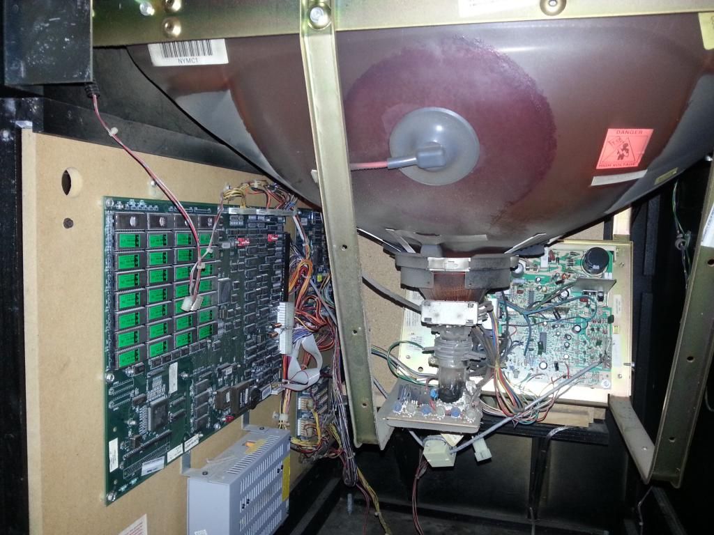

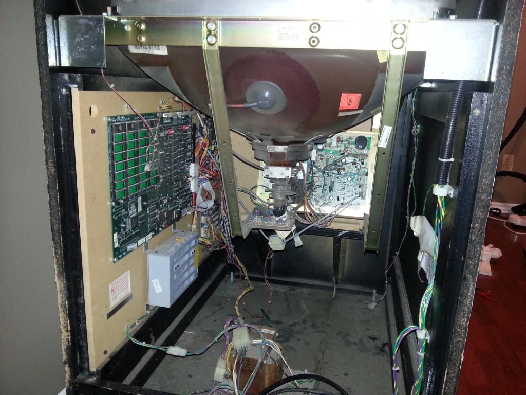

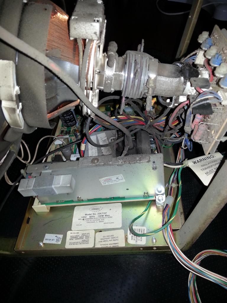

Well with lots of expert advise from Ed over the phone last night i finally got some progress made... of course after moving this big thing into my place...
MonMotha
  • Posts: 2378
Re: Raspberry Pi to CRT Monitor?
« Reply #18 on: August 14, 2014, 10:25:35 pm »
You can run SD (480i or even 240p) over HDMI, assuming the video controller on the Pi is capable of such low pixel clocks.  You'll need an RGB DAC to hook it up to the monitor, and maybe a video amp, since most of the DACs will output broadcast industry-standard 0.7Vpp, not the ~3Vpp that arcade monitors typically want.  The somewhat-popular "HD Fury" may be capable of low res, but check.  This is of course trivial to slap together at the component level, but the interconnect is such that a PCB is needed, so an off-the-shelf solution is probably desired...
ed12
  • Posts: 3972
« Reply #19 on: August 14, 2014, 10:34:03 pm »

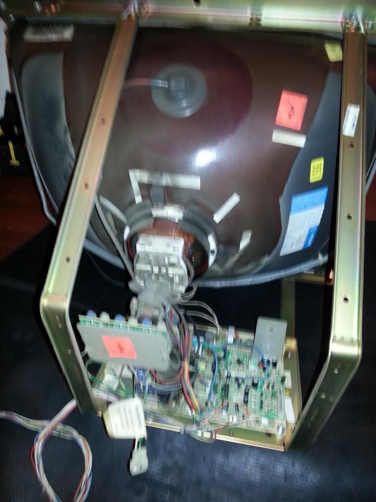

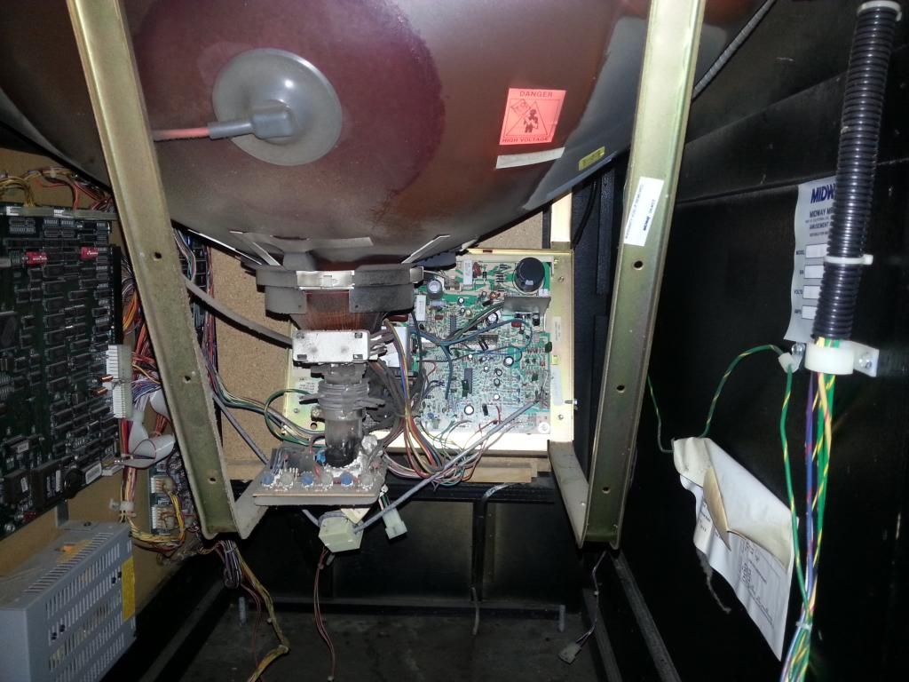

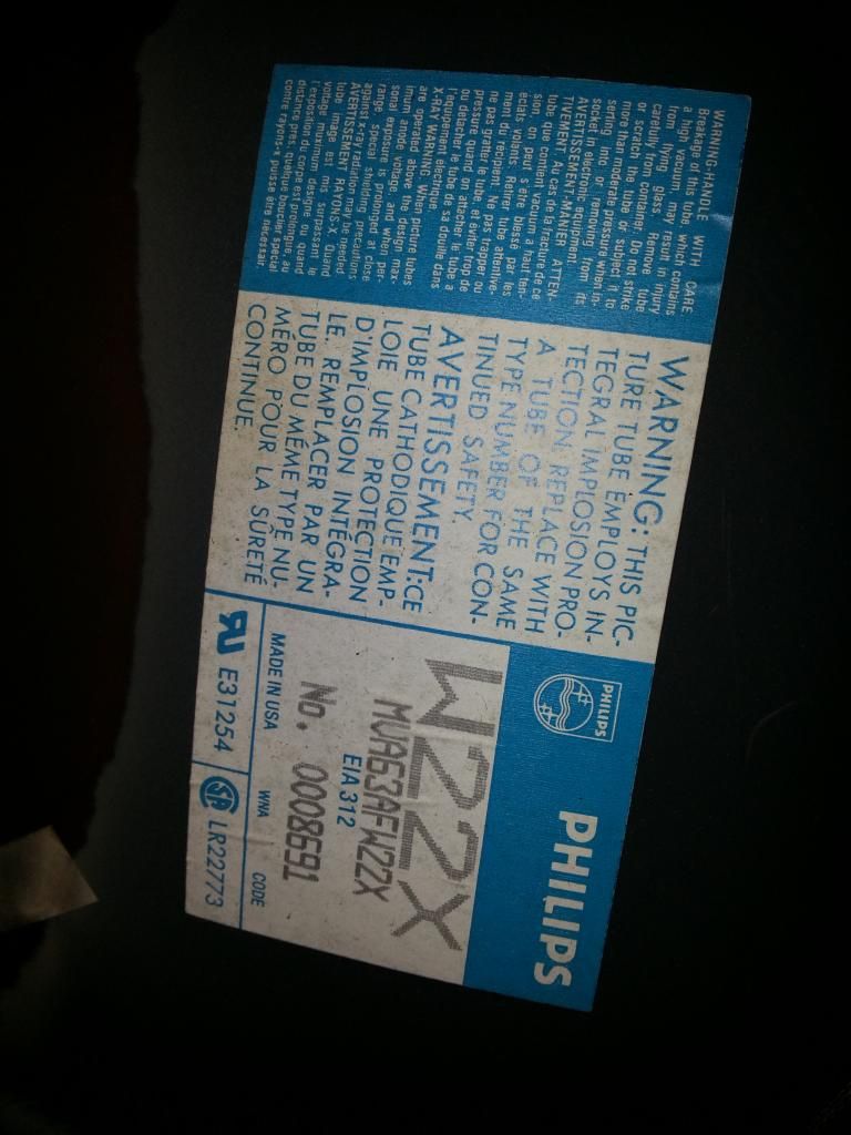

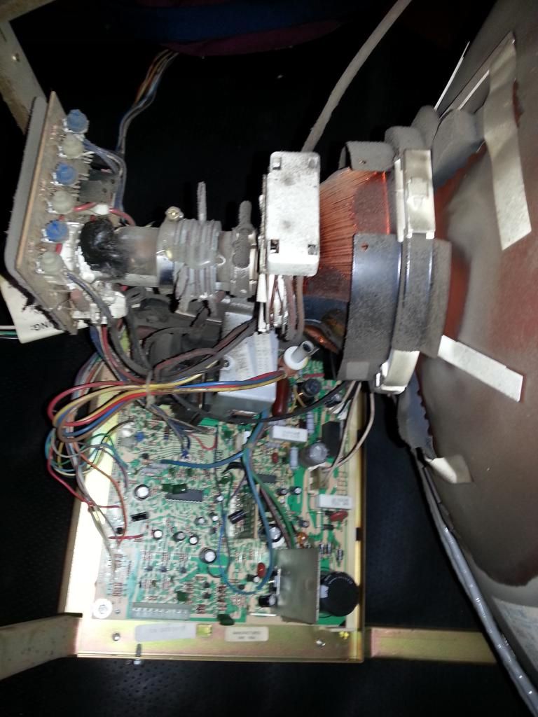

thk-ufor the pic's
on the left hand side >from back < u will c the full game board >top<

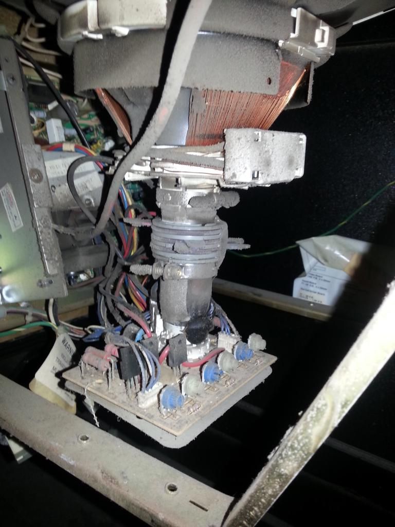

below that is a switching power-suppy...nice score..
that is a normal res.kv74-xx series monitor..it pull's straight up and out..
u do need a hand there..ring the bell..

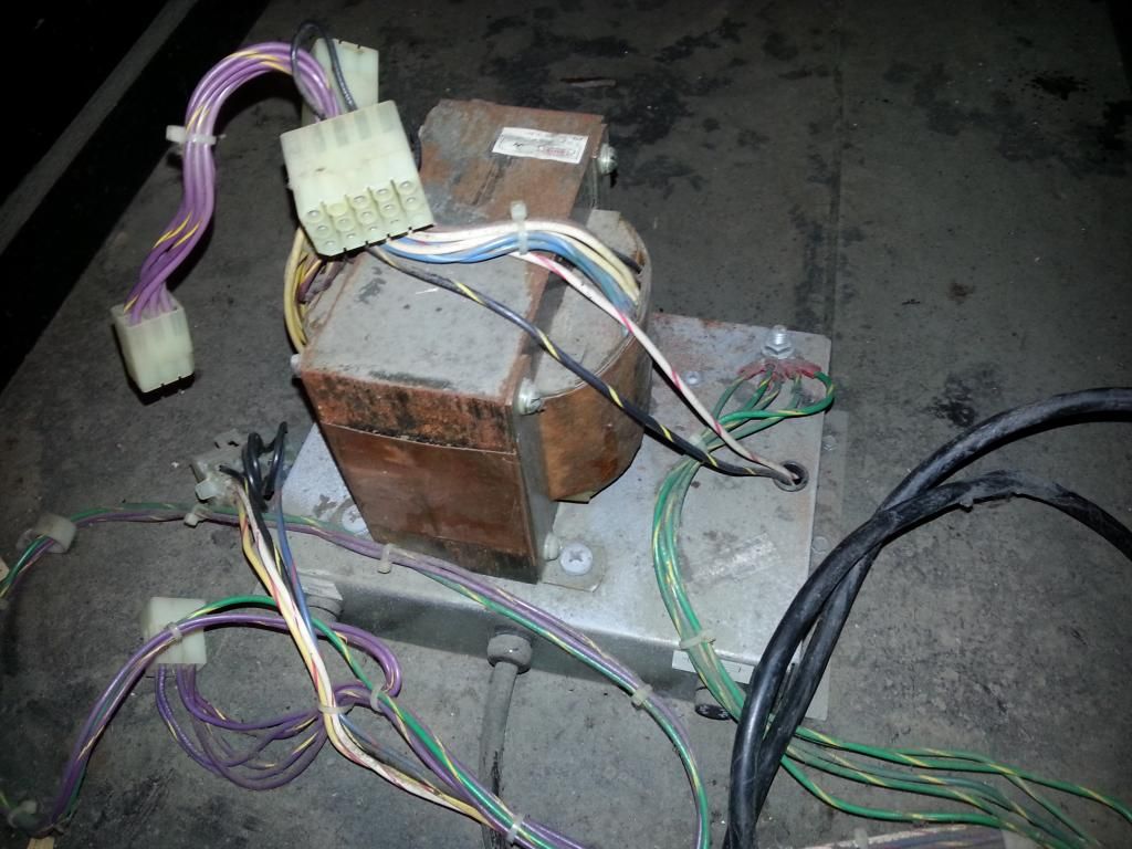

u remove the complete sliding panel,power-supply and board at 1 pull.ie the full thing will
slide out..we will be using that power supply,and "back-board" again,we will just remove the main game board,
just make sure every thing is un-plugged..no fear's there molex..can olny but fit 1 way back in..
reason we want the back board is to a mount everything u will be hooking in..
ipac4=usb for pi.(b) perfect fit also will work with pi(a)

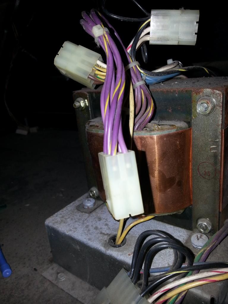

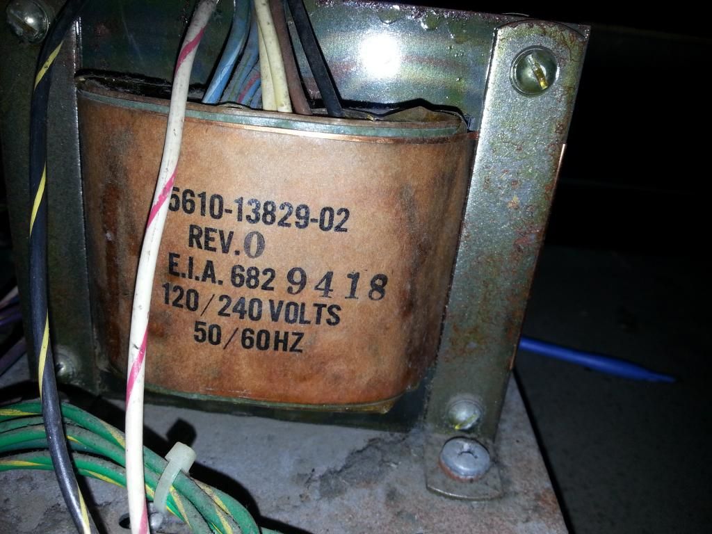

the transformer :board: is a complete isolation transformer..we will be using it also..
that is an early >dynamo/daymco< cab..nice score:):)
if the monitor work's?, which we can and will test in short order
u just saved a boat load of $$$$..
also we will reuse 99% of the unit >game-board-aside<
that cabinet should support veritical >up-right< display...
for now we will use a video output of the pie to get it going..
so a spare tv with >hdmi and or video in< will do just fine as we do the rest....
ed

ed12
  • Posts: 3972
« Reply #23 on: August 21, 2014, 12:39:48 pm »
the comp to rgb converter will
up the level to ttl..
the machine's old power transformer
would u please up-load a few pic'ss of it,i need to find the iso-side winding's..
i expect it is a multitap main's in ie:117vac and or 220 vac common for the day..
but that switcher should lead us the way if it was tied into the iso side of the power trans ?
ed
simko
  • Posts: 8
  • Last login:September 23, 2014, 09:15:53 am
« Reply #24 on: August 21, 2014, 09:01:09 pm »
Finally got some pipctures
« Reply #25 on: August 21, 2014, 09:27:43 pm »
Im 99% sure that green wire with the yellow stripe shouldnt be on the ground terminal, it should be on the FG terminal
ed12
  • Posts: 3972
« Reply #26 on: August 21, 2014, 10:01:54 pm »
ya if it goes back into the "ac" loop feed i would move it..
that wg need's an iso..no doubt about it now
snag a pic of the power trans..and up-load it,tonight if u can,
as i plan on going in friday after 12:noon
ed

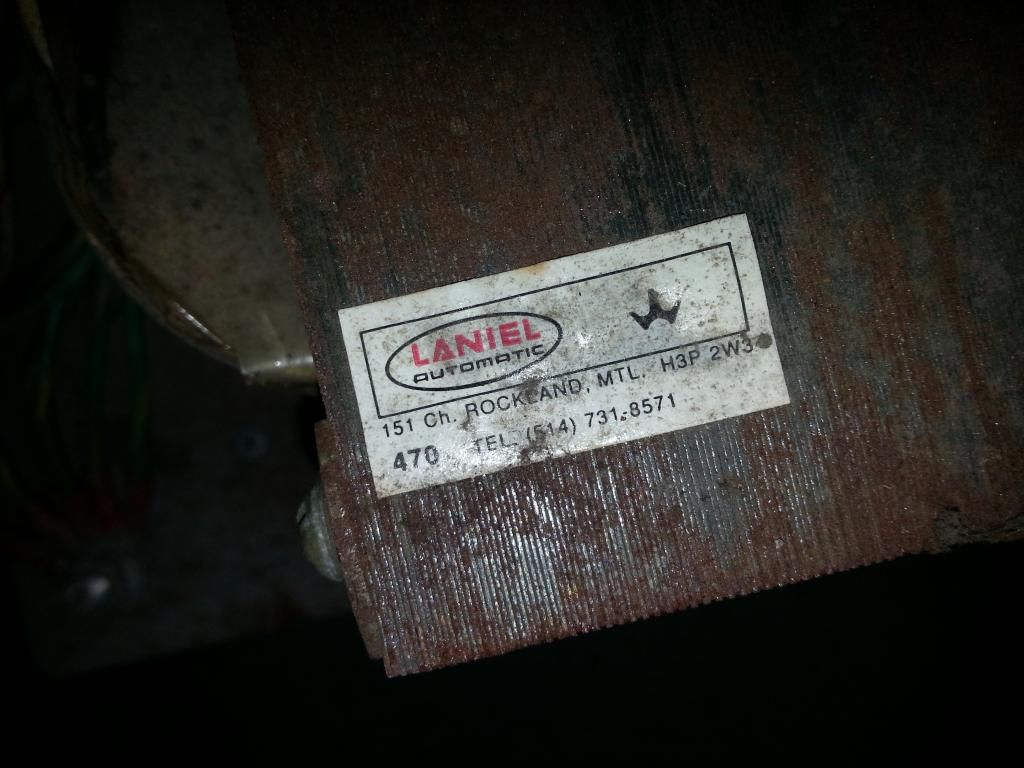

simko
  • Posts: 8
« Reply #27 on: August 22, 2014, 07:41:55 am »
I hope this is the power trans youre speaking of!
can i remove this from the cabinet? will i get zapped?
ed12
  • Posts: 3972
« Reply #28 on: August 22, 2014, 10:48:41 am »
ya that's a multi confiq trans..
ie: 120-240 depending on which way u set the >input< to the molex plug..
if u have the name of the cab i will chase down the manual for u..to set it right.
and as it all plug's in
rule a apply's
un-plug from a/c then just un-plug the molex's
then un-screw the full steel pan..but just get me the name i will chase it down for u
ed
lilshawn
  • Posts: 7516
« Reply #29 on: August 22, 2014, 02:40:48 pm »
also you will need to power that monitor through that transformer (or another isolation transformer) to isolate from the wall AC it otherwise it will go poof!
