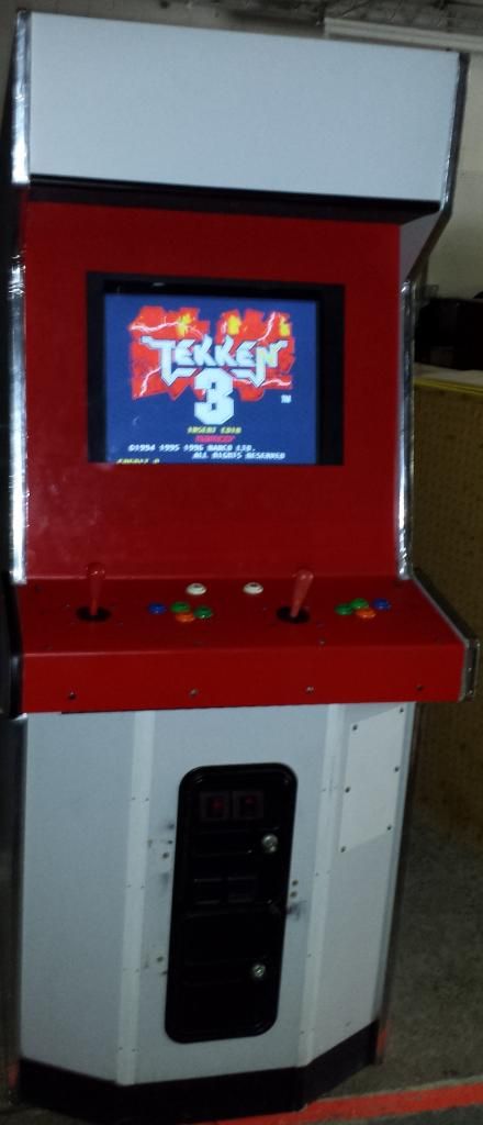

Alright I have Tekken 3 and a VF 1 Cabinet. The monitor has a vertical collapsed but even if fixed I can use it. So I bought a RGB to Vga coverter and got the game playing but not looking so great.
Then,
this board has VGA ports on it already. So my question is, how do I go by using these ports if i can?

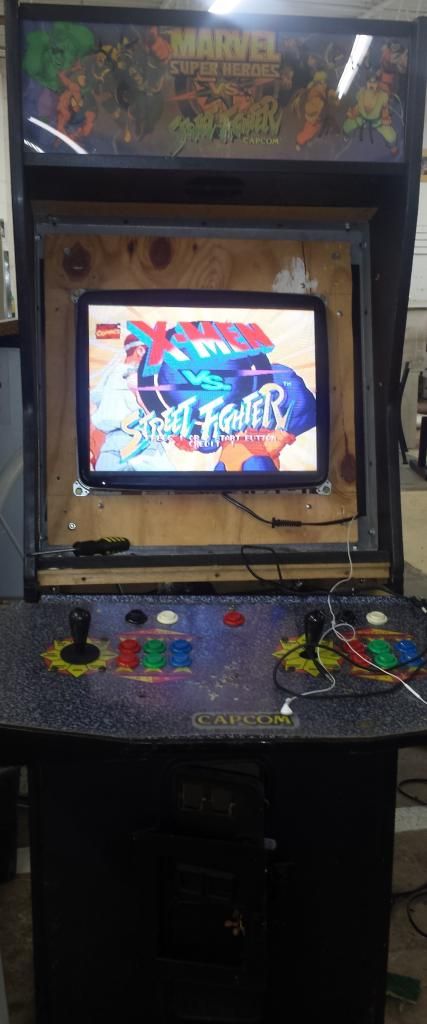

Popped in a old 21" Dell trinitron Monitor and for some reason it looks way better than the 19" monitors I tried. I Also did a Raspberry Pi Mame on the Marvel vs cab. All cps2 games, some nes/snes, sega genesis and other classics running fine on it. I used a old sanyo crt tv and wired the controls with usb encoders. Had to add 2 select buttons and a escape button.
