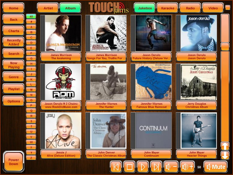

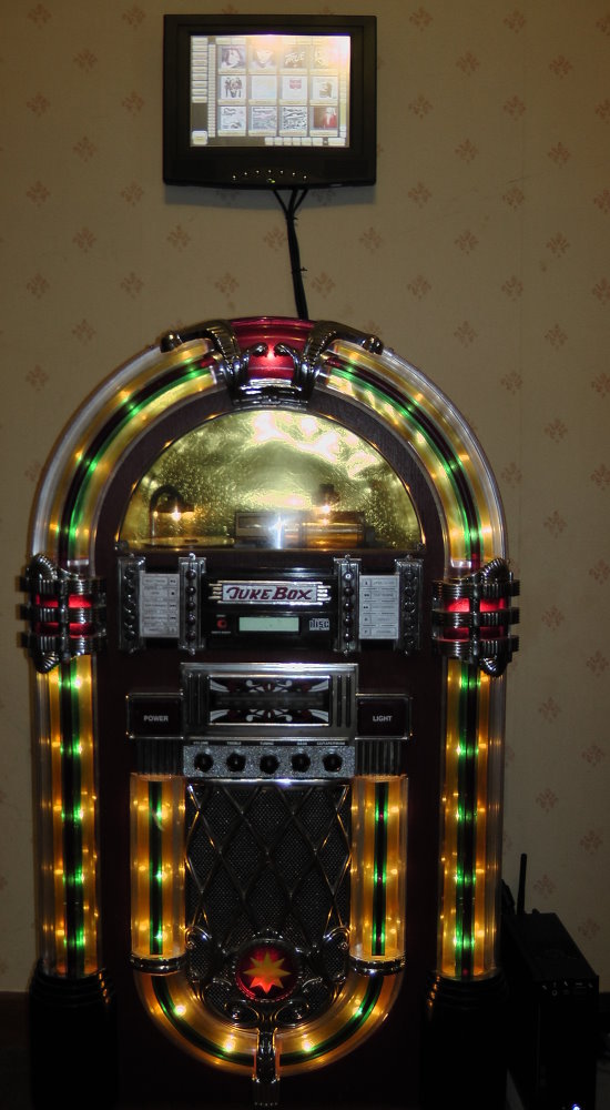

Just a quick one, with a few pictures, Bought an oldish Wurlitzer style jukebox off Gumtree that needed some work, wife didn't want me changing/gutting it though so I have the touch screen mounted to the wall and kept the Jukebox original apart from a rotary audio selection switch on the back and a 3.5inch jack socket for the computer audio input. Had to replace many of the bulbs and do some soldering on dry joints inside but apart from that its good. Sounds so good as inside it has a couple of 70w speakers one above the over and two tweeters at the sides, can turn it up to rattle the walls without any distortion or loss of quality, most of the circuit on the amp are all done without any silicon chips so it is nice.
Computer is a Mini ITX passive cooled dual Celeron 2.4ghz with a 128GB ssd and a 500GB 2.5hdd running windows 8.1 with 2 gb of memory, runs very fast and ultra cool, no heat detected coming from it yet, even if I run video it hardly gets warm.

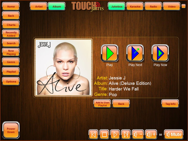

Reskinned the TouchJams interface so it looks better than the original (IMO) that took a couple of days to do.. loads of buttons to create.

I love Touch Jams, like yourself I "HAD" to create my own skin.
I like the chrome suround on your buttons.
