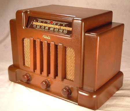

I am new here, and I have always wanted my own arcade system. Case that I always loved was the Tempest One, and I had in idea to do a bartop in that style, well that has been done here. quite well to.
I wont lie I am complete noob at this and I plan on keeping the mechanics of my first one simple; Find a decent 4:3 LCD at a thrift store, make it a JAMMA compliant case that uses a JAMMA PCB (or possibly a one slot MVS board not decided yet). No rotation, possibly no LEDs.
This is more of a project to get me started gathering the tools and experience in making these things.
Why a roll-top? I love them. And my wife has a slight aversion to the look of traditional cabs. So making something that when closed looks like decoration is a bonus. And like I said I want the practice, if this turns out I will want to scale it a bit make a "roll-top desk" sit down version.
What do I have? a sketch, a drill, a hammer, and a circular saw..... to say this is in its infancy is an understatement, but hay lets light this puppy and see where it goes.
I used this as inspiration:
Here is my rough sketch:

Thanks, I am still not ruling tempest style for me, I just want to try something new (for these boards anyway) for practice. This was my Visio mockup years ago I never followed up on. I love the shape of this Cabinet and TRON for some reason.
My wife would let me do just about anything I want in my office (we just moved into a larger house so I have an office :applaud:), so my working with her sensibilities is a courtesy more than a mandate.  ;)  Also I work in an office full of old arcade gamers, if I can do this artfully enough it can be an office toy.
New house comes with a garage, so I have a workspace, which is what stopped me before.

Looks good. The only thing I would recommend is you angle the monitor back a little. Odds are you'll be looking down at it, opposed to looking straight at it.

The only thing missing from your block diagram is the "Power Outlet" connection for the monitor.   ;D
