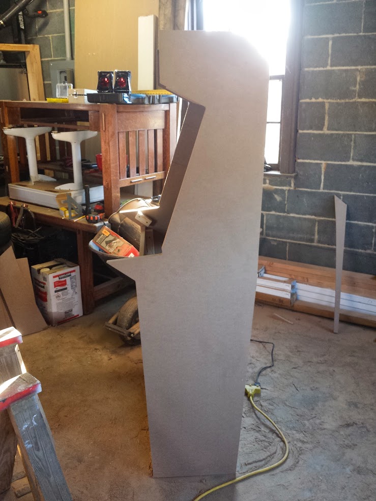

TV Mount:  (no idea why this 8 lb TV uses 200mm VESA mount instead of 100mm)
Side Shot:
Rough Sketch I used to start (based loosly off of the other two cabs I credit in the first post):
Tried doing this like Martijn...I'm not as skilled...gave up and did it on a table saw then and it looks pretty good:

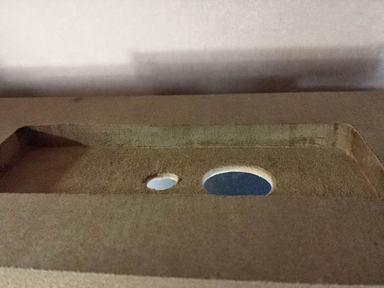

Then decided to mount the speakers like all the kids seem to be doing now a days: (still needs some metal to finish it off)
There is about 1/4" of thickness left...I didn't feel comfortable going any deeper (twss):

Looking good there gilligan5000.
remember that there is not a alot of space between the cp and that front angle piece. But those joysticks seem to fit just fine.
Will you make a door in the back? the bottom piece will be very heavy if its 1 big mdf piece.

The speakers need some metal (again stolen from Martijn's brain):

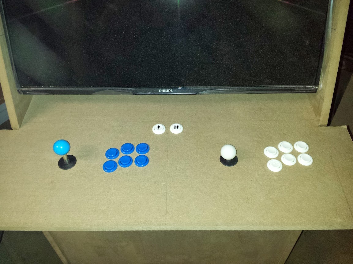

Templates finally printed in the correct size:
I'm using a six button layout, so I used the right six buttons, and the rightward "dot" for the jotsticks:
Which got me this:
Then I routed from underneath for the joysticks:
This first player friction fits in for now (player two is dangling there)...I'll mount them with some metal strapping from the bottom at some point:
I think its really looking good though so far:
