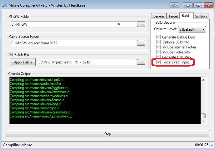

Google the following:
mame FORCE_DIRECTINPUT

Looks like even in the MAME Compiler 64 program, from this guide, there is a checkbox on the "Build" tab that allows you to check Force Direct Input.
So I'm assuming that's all you need to do is check that box.  Just thought I'd specifically call that out in case someone else wonders in the future and finds this thread!

AFAIK, only downside involved with Force Direct input patching is the added difficulty or prohibition of setting up multiples of like devices (ex three trackball panel assigned to separate players, dual keyboards, lightguns) or perhaps some devices which can only be detected with raw input, but not direct input.
