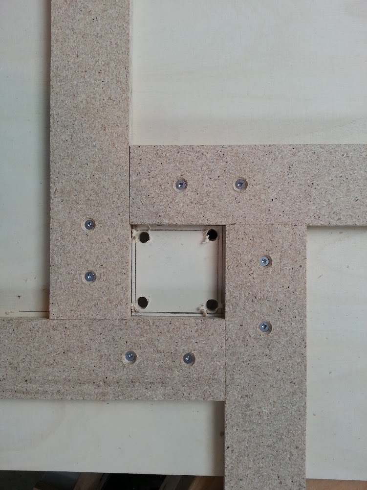

Here is the making of a Joystick Jig from Timoe's thread (http://forum.arcadecontrols.com/index.php?topic=51235.0).  Probably not necessary since I was only installing 1 joystick in the next foreseeable future, but I liked the tutorial.
Lining the jig up on my CP:
Tracing out section I need to route for flush mount:
Joystick Mount Finished:
