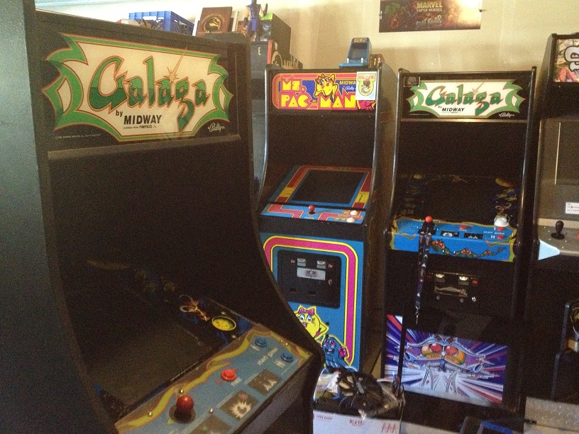

My two Galagas (well the one in the back is rewired for Jamma, and runs a 60 in 1)

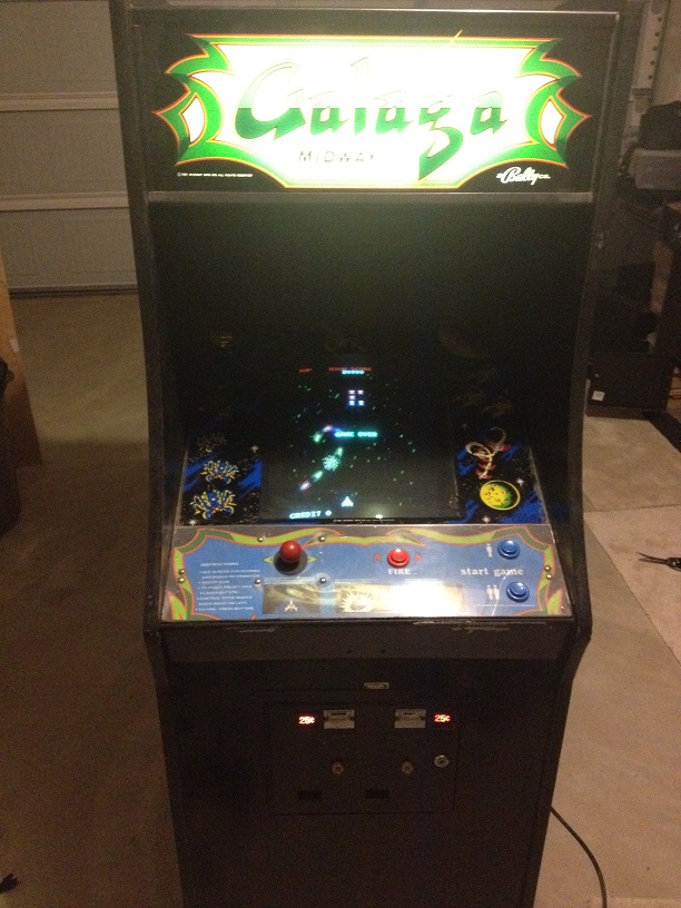

Attract mode:

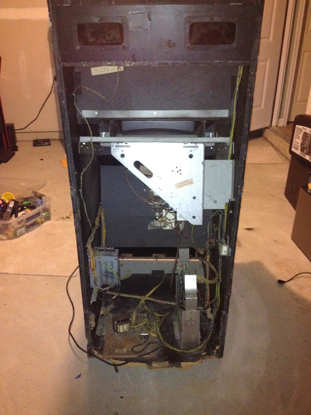

The "back":

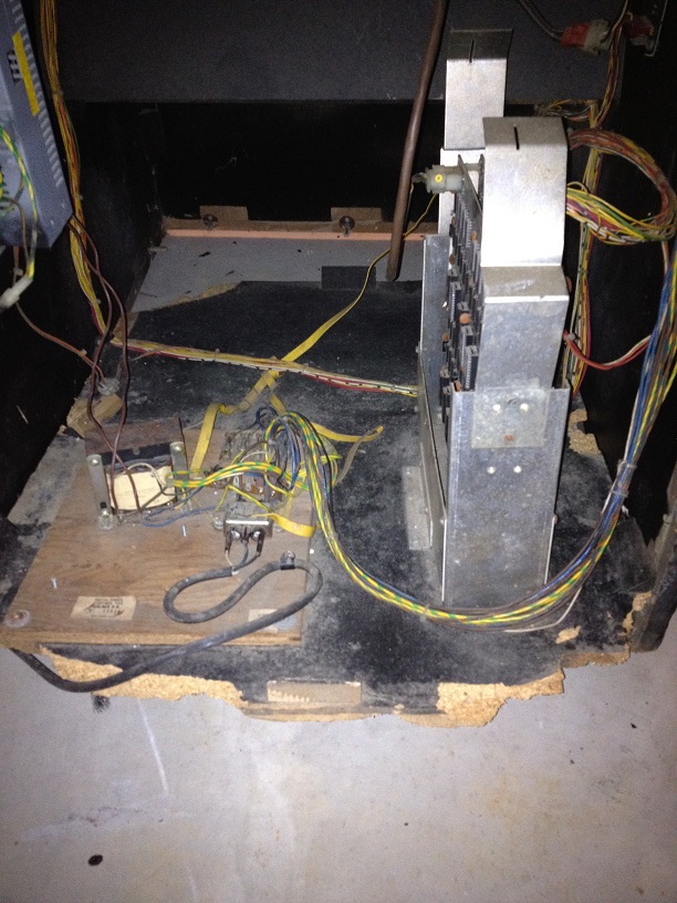

The "base":

Here is whats left of the old base, next to the new base. Top of the new base has 3/4" strips ran along the top, glued and screwed into the base:
Held in place by tension:
Screwed in place:
And low bottom piece installed, the hole for the power cord is ROUGH but meh:
Still need to paint the back bottom piece , dont think there is a need to paint the base.  baby steps.
