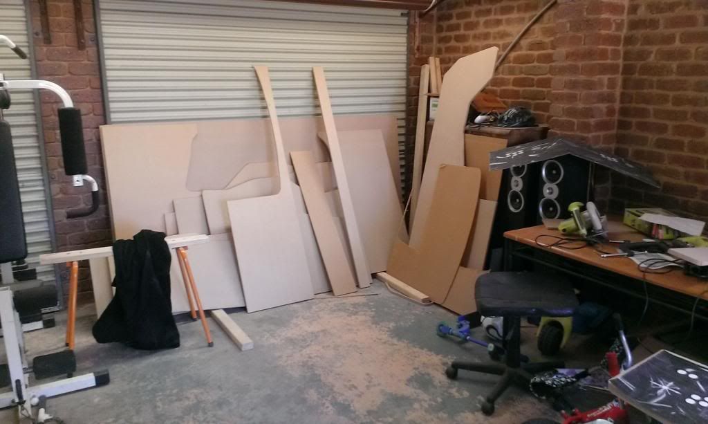

I have had the idea of building a cab for quite a long time but I think I made the mistake of over researching and the whole thing became a bit overwhelming. Well I finally decided to start this earlier this year with no time frame in mind due to work and and young family commitments. I actually started the software side of things at the beginning of the year but I realise that never stops :banghead: I have recently just started delving into the construction part.
It wasn't until I came across Onds "Metroloplis "design that I got the confidence to start the cab side of things. I am really enjoying this now that I have started and with a bit of pre thought into it and the right tools I believe anyone can do this.
The missus aint too happy as I have had to invest a fair bit of mula into tools to even start this but hey.... I promised her I will be more handy around the place  ;D
I decided to go with a slimline design as I will be using a 32" LCD for this project. The main thing I modified from Onds design was the control panel as I had already spent weeks designing the control panel art in Illustrator ( Never used it before in my life ) before I stumbled on Onds design and did not want to start that again. Here are a few progress pics.

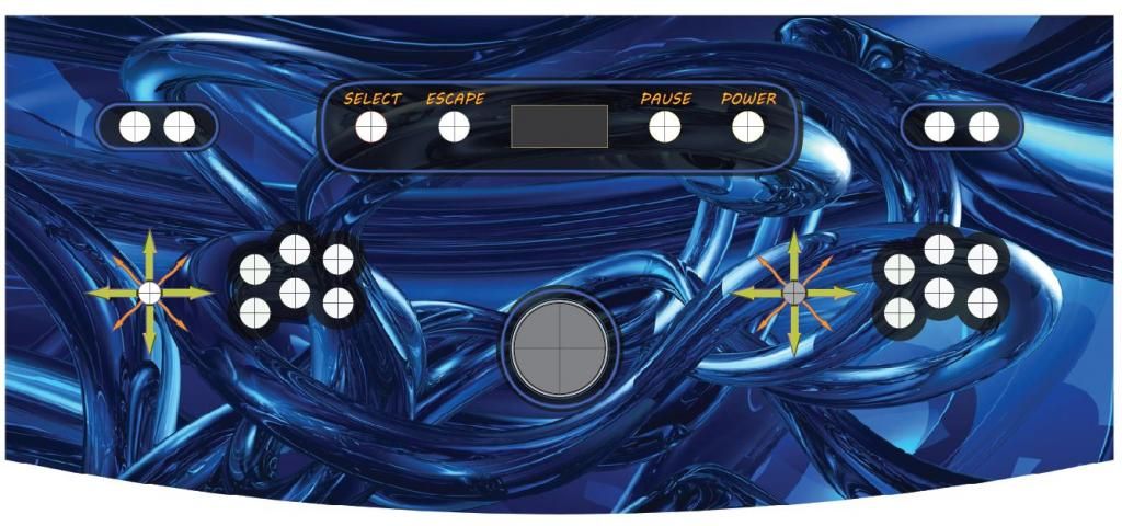

Here is a pic of the control panel art that I created in Illustrator.

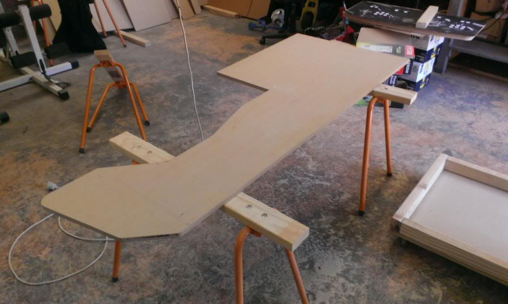

This is the design of the sides. I have two of these now. I cut one and used a flush trim router bit for the other

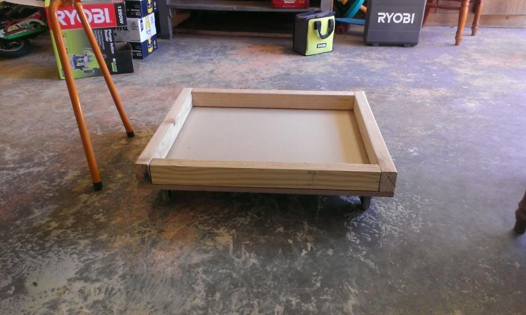

This is the base with castor wheels attached. I decided to go two fixed and two turning wheels. I believe they are rated around 50kg each. I hope it will be enough

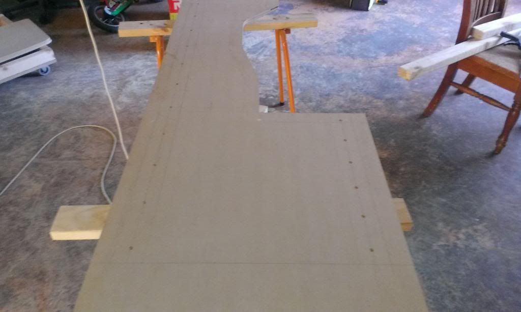

Here's a couple of shots with the pilot holes drilled for screwing. I used a countersink bit. F'n thing cost $30 just for the drill bit.

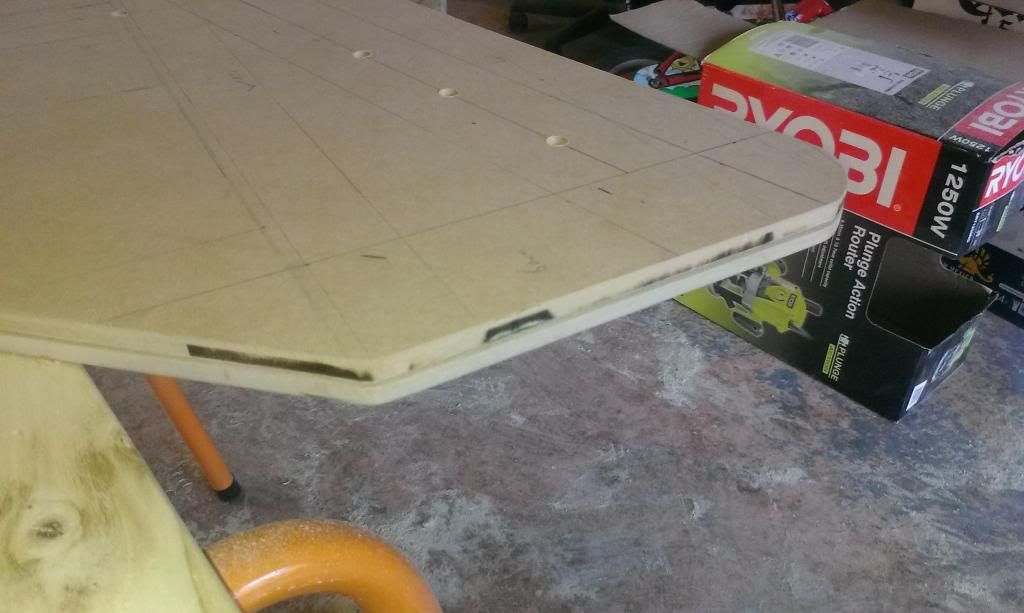

Here is a shot of when I used a borrowed flush trim router bit. Due to being a router novice I I didn't realise that the burning smell wasn't good. That won't happen again. The bearing started cutting into the wood as it must have seized up. A trip down to Bunnings for a new bit this time let me tidy it up. The tidied one isn't in the pics. Those aren't only burn marks but the bearing actually started cutting into the wood :badmood:
A very good start to your project, you seem to have your goals set and you are making good progress. I do have one question about your control panel: what is the small rectangle in the middle, between the escape and pause buttons? Are you planning on adding a small display?
Thanks..... The small rectangle is space for a small T-Class Amplifier. I wanted a knob for volume a I didn't want to use buttons for this. The face of the amp will be the only part showing. The guts of it will be hidden under the CP.
The first thing I thought when I saw your graphics was the Mike Oldfield album called "Tubular Bells".  Very cool design.  Thanks for sharing.
