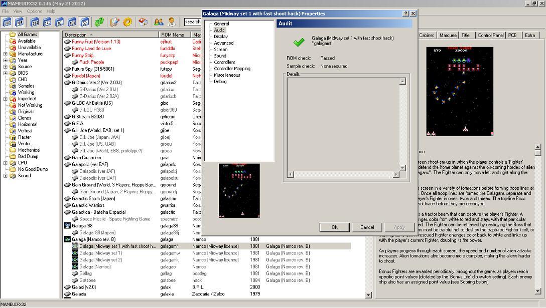

Looking for a simple easy to use rom manager, all I need to do is go through the 3000 plus games and delete the ones I don't want, the rom name tend to be a little cryptic so is not easy to do in file explorer, I just need something that will read the rom file and tell me the title of the game, and then allow me to delete it from within the manager software, how simple is that, not very with most of the rom managers out there!  :banghead:

To build your gamelist, try using MAMEUIFX with copies of all available ROMs in a subfolder under "roms" called "Archive".
To add a game to the playlist or check it out, either use the search feature or scroll through the all games list to find the name of the desired ROM.
Copy the file from "Archive" up to "roms".
Right click on the title in MAMEUIFX and select "Audit this file" -- it tells you if you need any other drivers, parent files, or a different version of the ROM.
If it shows up as good, you're ready to playtest and evaluate the game.
If you don't want to add it to your playlist, just delete the file(s) you copied up.
If you do want to add it to your playlist, use the menu item "audit all files".
If you're running the same version of MAMEUIFX and MAME, you should be able to just copy over the new ROMs to the MAME "roms" folder and add the new title to your FE gamelist.   :cheers:
I know this is a different approach than you mentioned in the OP, but IMHO it's easier to add 200 files than delete 2800.

I've used MameUIFX the delete rom item in the menu is greyed out and there seems no information as to why, have searched through the forums and google to no avail.
  • Posts: 9795
  • Last login:Yesterday at 10:11:00 pm
Re: Rom Manager
« Reply #6 on: July 03, 2013, 04:53:03 pm »
Try just opening the folder on your hard drive with Windows Explorer/"My Computer" and deleting the file.
Alt-Tab back and forth between MAMEUIFX and Windows Explorer.
EDIT 2:  If you were referring to the "Remove From This Folder" menu item, that is for custom folder lists like "Bad Dump", "CPU", "No Good Dump", and "Sound".
Click on the Sound folder (left column in default view) and select a sub-item and you will see that the option isn't grayed out.
I see no way to delete files in the roms folder from the MAMEUIFX menus -- use Windows Explorer and do it manually.

you are missing one slight thing, how can someone differentiate - tell apart say one version of 'A GAME' and 'ANOTHER VERSION OF A GAME WITH A VERY SIMILAR NAME' say I have 1951a and I have 1951b. I cant go running each one. Double checking I got the name right and then delete. Then run the next. Over and over. A lot of 'GAMES' have the exact same name save for an additional letter on number that is gibberish to you me and Jez over there.
:banghead:  You have a . . . unique . . . way of seeing things, CJH, but if you're going to scold me for "doing it wrong", READ MY ACTUAL WORDS AND PROCEDURES instead of skimming and mischaracterizing them.
What YOU are missing is that MAMEUIFX has the list of filenames associated to the game titles/variants including parent/child sets.
If you want the fast shoot hack variant of Galaga, you'll need the child rom "galagamf" (indented) and the parent "galaga". (not indented)
When you combine it with History.dat, info.dat, and progetto snaps, you don't have to launch a game to see if it's the one you want.
The problem with your approach is that you you start with all files in the roms folder and remove the ones you don't want.
As I said before, it's easier to add 200 files to a folder than delete 8,500+ files and hope that you don't break another game along the way.
And , I don't know about anyone else but sometimes my hard drive takes a long time to access said folder.
Not sure why that would take a long time -- even for my old EIDE drive only takes two seconds when it first loads the folder.
Pull the Archive folder up then right-click to copy the desired file and right click on the roms folder in the left column to paste.
:o  The folder view remains in the Archive folder -- no reload time required.   :o
If Windows Explorer isn't behaving that way for you, open a second Win Explorer window so one is in roms and the other is in Archive.  Alt-Tab between them to copy/paste.
